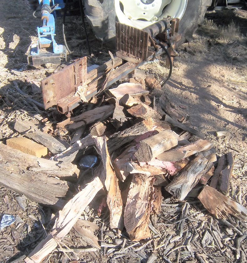

Seems like 1 step foward = 2 steps back.
Yesterday 15 minuets of fire wood splitting took well over an hour of tinkering around. Had not used the log splitter in over 2 years. First off the rear remotes do not work until the back hoe is unplugged and hooked up to the pump. ( Sure would like to put a 2 way valve in the system.) Then plug in the splitter, sure looks good. Does it work, nope. check hook ups, 1 hose has popped out. Try & Try to get it in, no matter what it will not go all the way in. After much tinkering & frustration, get a wrench & bleed the splitter cylinder. Grab 5/8 & 3/4 wrench. Nope fittings are 11/16". About 2 turns and fitting starts spraying fluid. Bleed both sides. Fitting still tight, but goes in.
Some days I have more Fun than I really want. How about you???
