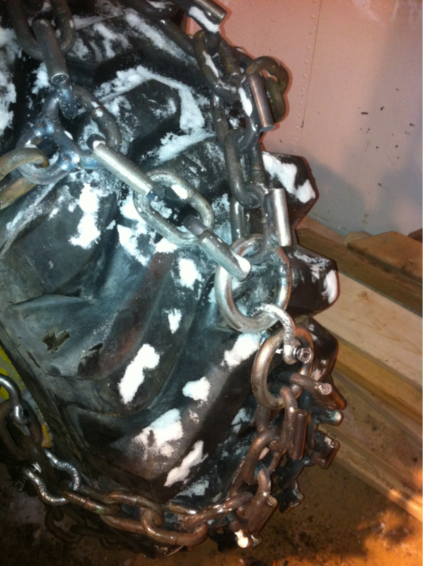

Hey just thought I'd show off my new set of chains. The front chains I pieced together years ago and worked well for a while. Now I'm clearing the driveway to the cabin and they didn't cut it on the hill. Since my wife runs the machine when I'm at work, I thought to keep it safe as I could and got the 9/16 diamond chains on the rear. Lots of traction. Next is to ballast the rear tires...

/ Good chains for R4's? #25
Oh, and here is a close up.
