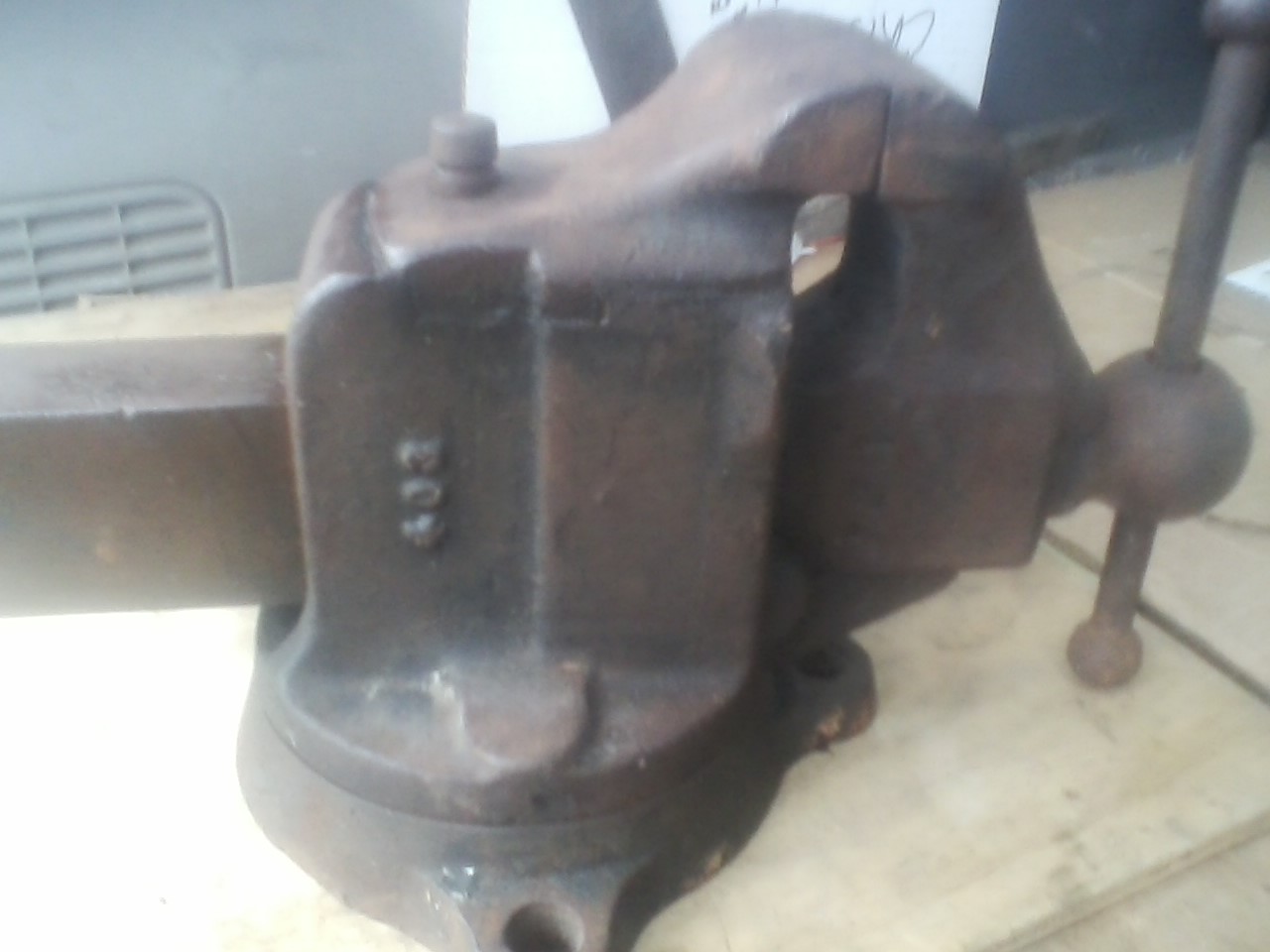

Have an older Reed 403 that I'm working on now

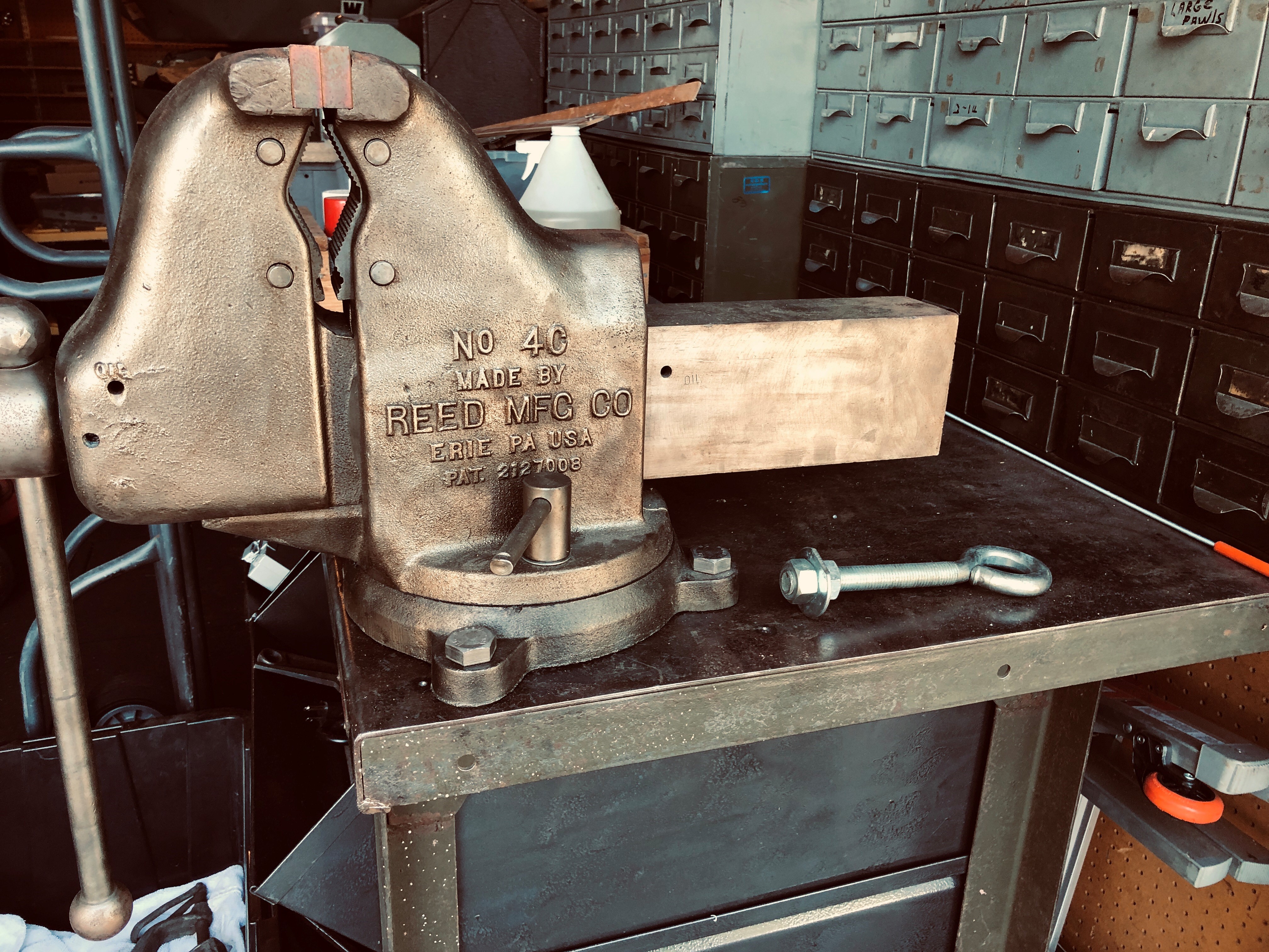

ALL: I own a few vises so wanted to mark this thread to follow it along and maybe help some of you that don't know which vises are any good. my preference would almost always be an big old vise not welded or broken from mis use that left the factory before WWII, but there are a few new ones that can do the job too.
my REED 4c is 178 pounds so maybe a bit overkill for my small home's garage, but since I own it and the steel bench can support it I use it just like I would a smaller one.4CMOUN~1.JPG

^^^ That is art. Nice.

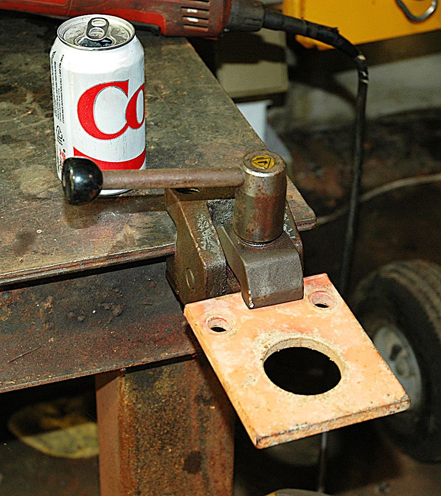

Bought this old Wilton a few years ago when I built the welding table.

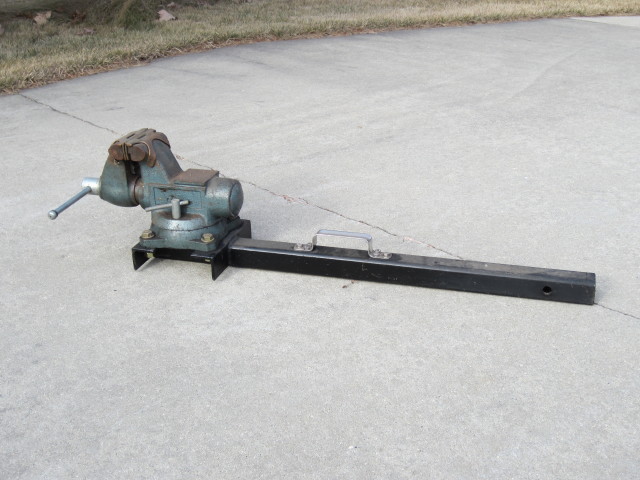

I have this vise ready in case I have work out in a field somewhere. It slides into a 2" receiver and is long enough to be away from the tailgate. The neighbors seem to use it much more than me.

Chim: while I won't deny Wilton bullets are good vises that job you are doing there probably would be best in what I call the CHINESE WONDER VISE (CWV). it's jaws can be turned 360 degrees so you could have placed that heavy piece vertically and not had it's weight on the vise. Wiltons have hollow jaws towers so they'll break a lot easier than some old vises when doing jobs maybe a bit on the industrial side. looks like you might have got that job done without breaking your Wilton so congrats and maybe put that on a bench inside your shop that is a bit more light duty work.
Ruffdog: I'm not surprised your trailer hitch vise is popular. since that Wilton Tradesman you have is a spendy vise unless you don't care if it breaks i'd also consider bying a CWV for about $100 or less used and put the CWV on the hitch. i've seen a lot of hitch mounted vises, but that's the first one I've seen with a long piece of tubing and a nice handle to carry it so I might have to steel that idea.

You're kidding right? Save a Wilton bullet vise for light duty stuff? Probably the funniest thing I have read in Awhile

Ruffdog: I'm not surprised your trailer hitch vise is popular. since that Wilton Tradesman you have is a spendy vise unless you don't care if it breaks i'd also consider bying a CWV for about $100 or less used and put the CWV on the hitch. i've seen a lot of hitch mounted vises, but that's the first one I've seen with a long piece of tubing and a nice handle to carry it so I might have to steal that idea.
Mostly, I use the vise when I'm out cutting a bunch of firewood and it works great to hold the saw. If I have to sharpen the chain, it sure is nice to have something to clamp the saw into.

I did make it through that project without a catastrophe. Guess I was lucky. Thanks for the advice. From now on I'll just use it indoors and have Wifey tighten the handle.
