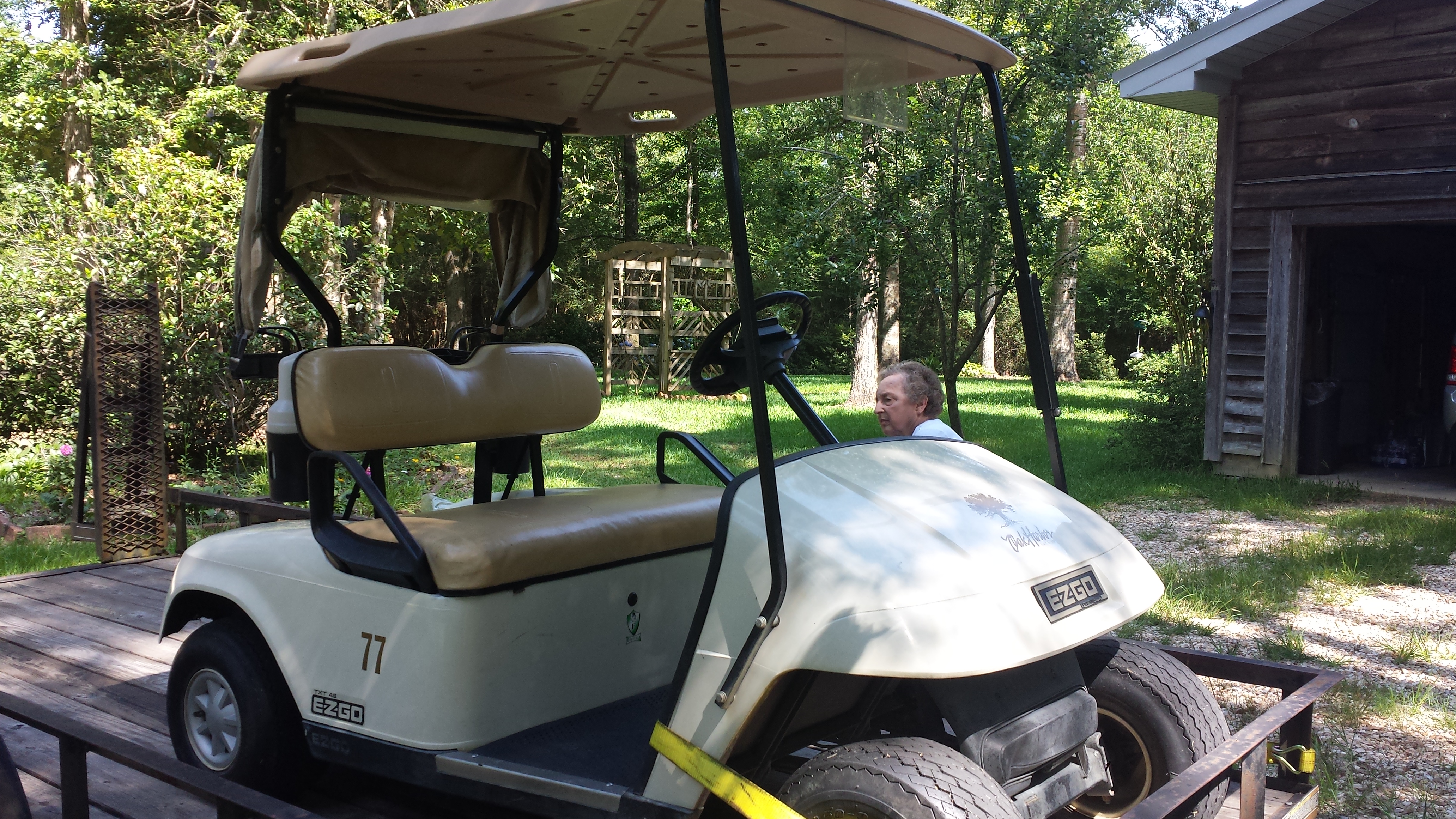

I just bought a golf cart from a country club that is buying new carts. It is an EZ Go cart. I don't know the 1st thing about golf carts except press the pedal to go. This one seems to work OK, but I hear a squeak while underway. Does anyone know if golf carts have lube zerks?
Thanks,
Jack

Mine has a few zerks, i.e. on the ball joints, tie rods and drag link.
There is another one on the steering shaft that is WAY up near the top. Difficult to see without a flashlight. Keep that one lubed and it'll steer easier for sure. I also lube the rear springs to keep them from squeaking. The lever that switching from forward t reverse gets hard to turn, so I do shoot some liquid lube like Dry Lube on it.
Main maintenance thing I'd suggest is to keep those batteries in near full of water. They're $100 each minimum but will last easily 7 years if you do regular maintenance. I have to charge up the batteries, usually at 1/2 reading, about once every couple of weeks, and check the battery water about once every quarter.
Other than a 15 minute task, just get in and go. No muss, no fuss.

I had to double check mine to see about the steering shaft and ball joint zerks and didn't find any grease points on my EZGo cart other than on the tie rods. I guess they changed to sealed bearings on my model.
Battery maintenance is a must for these carts. I had one battery in my 6 bank go bad and thus caused the other 5 to overcharge and burned them up. An expensive $800 correction.
I think on my next battery change, I will go with 3 ea 12 volt deep cycle batteries rather than 6 of the 6 volts. Likely wont get as many miles per charge but I don't go far with it so they should work fine for around the farm and cost about half as much and half the terminals to keep clean.
