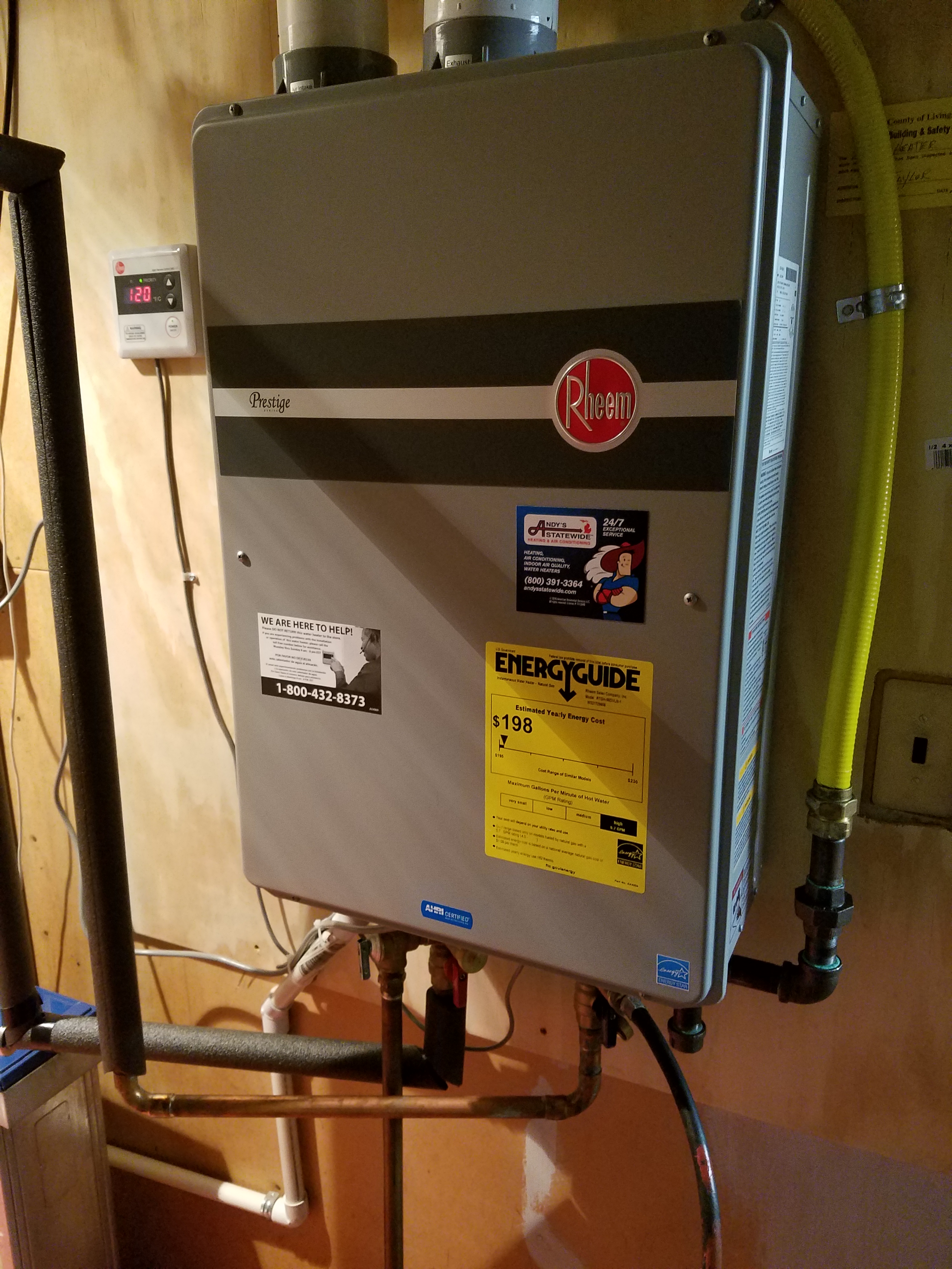

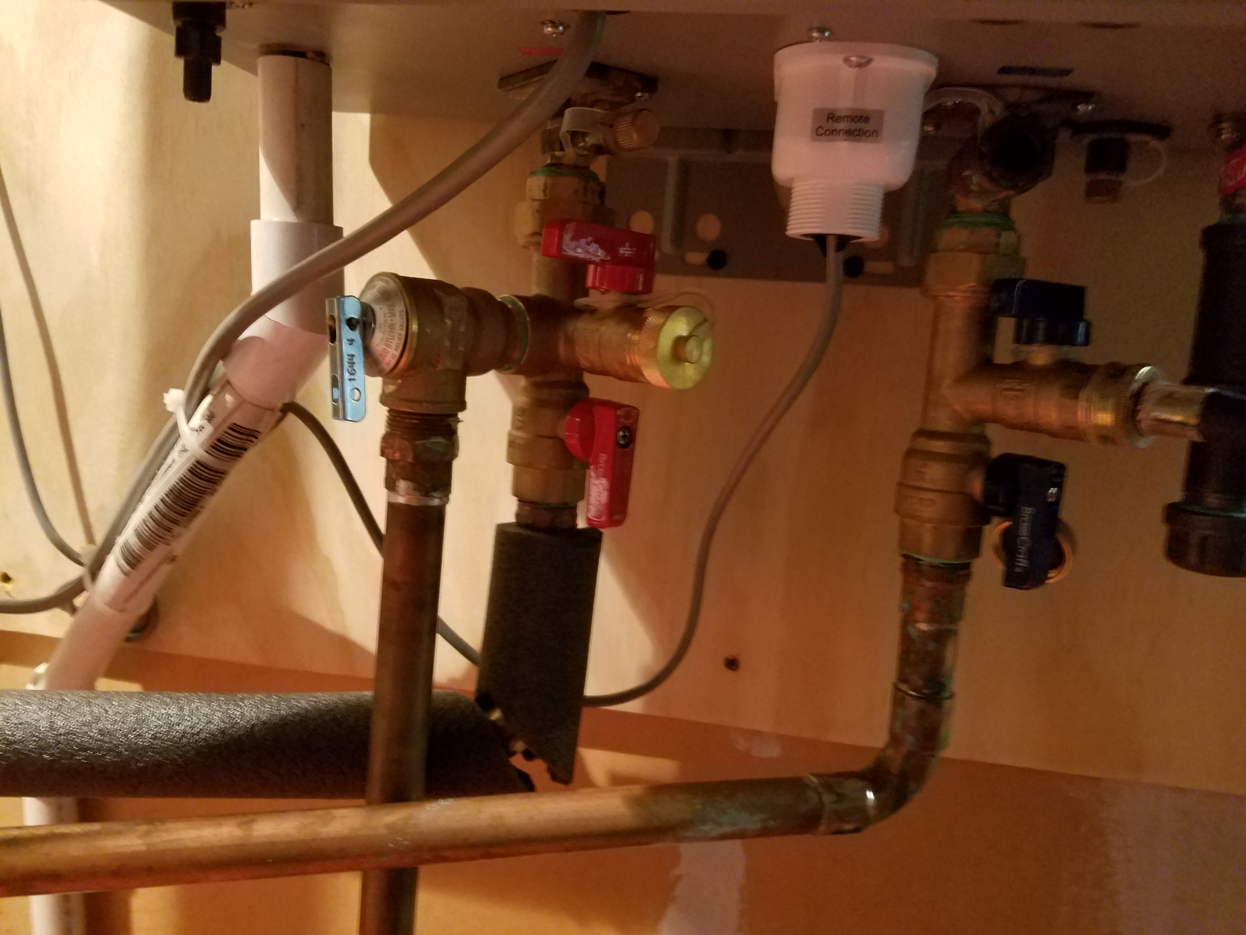

My mistake. I have 1" copper water lines in the house and 3/4" in and out of the Rheem. The neckdown is about 2' away. This was where the old 50 gallon take hooked up. It sure does free up a lot of space. BTW: This unit has ports for cleaning and flushing. They have a kit to do the back flush. Close the valves, attach the solution bottle and let it flow. No problems with using well water. The only issue I'm curious about are the sink faucets. Single handle deals which are usually in the center position. Using a sink for a few seconds (as in: add water to instant oatmeal) can start the unit. Leaving the handle in the cold position does not kick the unit. Something to further investigate.

Thanks for the pictures. It looks like it uses - 2" PVC for the vent and the fresh air. Does your fresh air go to the outside? For the hot water coming out of the unit that I install will be a least a few feet until I have to reduce to 1/2" to connect to my 1/2" line where my current water tank is.

   / Going to replace hot water tank. Need some advice #49
Yes air in and exhaust out are outside (by code). I have two house furnaces that are high efficiency with outside air and exhaust vents. There is a code requirement for spacing from one system to another. (30" ??) A bit crowded out there. And you need to pay attention to possible frost accumulation. Neighbors exhausted underneath their deck and the inlet frosted shut. Pressure sensors shut down the furnace AND the tank. Not a popular fix and repair on the coldest day of the year.
BTW: There is a condensate drain line that needs to be plumbed to somewhere, too.
