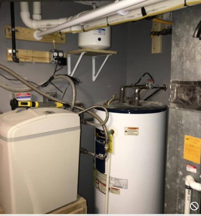

I'm back on this project again. I'm looking at this one: Rheem 9.5 GPM Natural Gas High Efficiency Indoor Tankless Water Heater-ECOH2DVLN-1 - The Home Depot
It should be large enough. I have 2 and 1/2 bath, split entry. There are 3 of us living there. The tankless water heater I am looking at is 9.5 GPM.
My plumbing is all 1/2" in this house. Could this affect the performance of the tankless? I just had my natural gas installed 2 weeks ago. I ran 1" pipe from the meter to the furnace room where the new tankless heater will be installed. It's piped into a 1" manifold. I can tap off of that using 3/4" csst to the unit. I would think that would be enough volume for the gas. I can vent it directly outside from there.
Here is the old electric 80 gallon hot water tank.
   / Going to replace hot water tank. Need some advice #28
That will work fine on all fronts except the 1/2” water pipes for everything. The water heater doesn’t care (it has a flow meter) but you will experience the temp fluctuations while showering- just like you do now.

With the water heater I have now, I don't have any heat fluctuation when showering or haven't noticed anyhow. Also, this is a smaller house and the kitchen and main bath are right above the hot water tank, so there is not much of a run for the water lines.
   / Going to replace hot water tank. Need some advice #30
Then the 1/2” lines shouldn’t be an issue. Have fun with the project!
