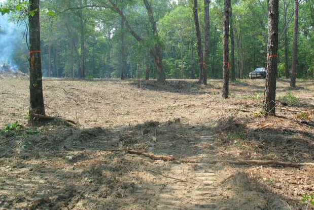

And heres one after some work with the root rake.
I still need to disc it for some of the roots and vines still need to be chopped up.
   / Going from timber to grass.....
#42
Thanks Highbeam and Stu, can you point me to an appropriate disc that I could use behind the D5? I was thinking about using the tractor to clean up behind the dozer but if the dozer would do a better job.... Thanks for your help and nice pics, both.

It sounds like you may have a plan, but have you considered a roller-chopper for this job?
They have been used to good effect here in reclaiming pasture overgrown with small cedar and mequite. Basically, a large roling steel drum with cuttings edges that you pull over the trees...similar to the way you would plow a field. This breaks them down and creates a dense, dying amount of foliage close to the ground which then is very easily burned in controlled burns. After the burn, you go in with a dozer and rake the left over material, plow, and re-seed.
Now, from your pic, these pines look to be about 10' or so...? I've a D-6D pulling a roller chopper work over a pasture full of cab-high cedars with relative ease...and do it much quicker than pure grubbing. Maybe you should check with an experienced clearing contractor about this option and see what he thinks.

The reason for using the dozer to pull the disc is that you can get a macho super heavy duty chopping disc that will actually break up and chop stumps, roots, and debris into submission. A typical tractor is not capable of pulling this size of a disc. Big like 6 or 8 foot diameter discs that take mucho traction and power to pull through. These disc implements aren't very wide, just tall and heavy. Contact the rental place.
Got to agree that after a dozer with rootrake does its job, there will be very little left to chop up.

If you don't plan to plant immediately and there aren't bigger stumps mixed in with small pines, a HD rotary cutter and subsequent burn would take care of it cheap. I did 10a of neglected pasture grown into pine thicket on my property. The 3" pine "stumps " left from burn rot amazingly fast. There's not much root to a 3" pine. I was able to disc it a year and a half later and plant bahia The pines need to be cut close so you don't cut a tire.

I just got back from our property and met with the forestry agent. What a great source of information. They were very helpful and gave me some great pointers. He also gave us the name of the soil and water agent for the county. Great idea!
His recommendation was to;
1) root rake the entire site with dozer
2) wait a few weeks
3) burn
4) disc harrow with a HD tractor
5) then go over it with my tractor and clean up the bits
6) either harrow again, lighter disc
7) harley rake, till, or pulverizer
8) plant grass seed
We close next week and hopefully we can get started in a week or 2. I'll post pics!
