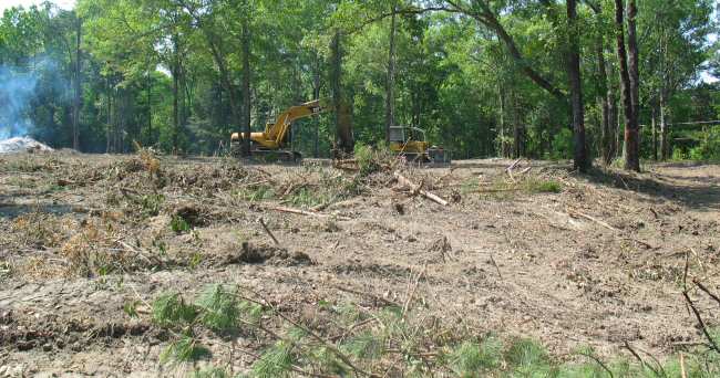

I gotta tell ya, a good operator with a root rake can clean a mess up pretty quick.
This Kubota D37 did a good job on what was a real mess.
This is a pic of some of the roots left after a days work.

Heres another pic of before doing a good clean up with the root rake.
