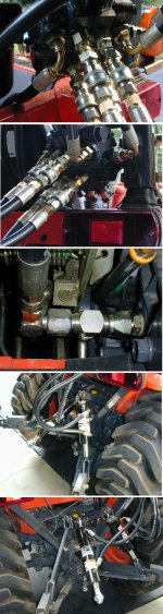

Next installment:
I finally settled on a placement for my TnT controls. After investigating the electric operated controls, I
decided to stay with the manual valves and placed them between the ROPS bar and seat. They are on an
angle to improve the position of the control handles (it actually came out quite well from what I can tell so far
despite no real experience using them yet). The hoses going to the cylinders all have quick disconnects and
the couplers are attached directly to the valve body. This eliminates 4 hoses and a mounting block of some
sort that would otherwise be required if the couplers were mounted separately from the valve body. The valve
positioning results in the couplers pointing out the back of the tractor and down at an angle to shed water.
The whole assembly is on the inside of the ROPS bar so hopefully it will be reasonably protected from attacking
branches while bushwacking. The valve control handles are still susceptable, but I can't see any way to
improve it sort of using electric valves or having pre-configured slots like on the grand L's.
The actual attachment to the ROPS is using straight bars that I got at the local HW store. I cut them to
length and welded them to the ROPS bar. This position for the valve required moving my flasher light from the
fender mount holes on the inboard side of the ROPS bar to the outboard side using mounting brackets. The
2710/2910 can be built up either way and my dealer happened to go the fender mount route. I visited the guy
who assembles the machines and as suspected he had a box of the brackets and gladly gave me two along
with the plastic plugs to fill the fender holes. The flashers will be more vulnerable to branch attacks, but what
else is a tractor nut to do?
So far so good, but I still have to connect the hoses and figure out how to tap into the return line to the tank.
Photos attached in collage format inspired by Harv,
Peter

Silly me. I meant to post in both places. Here's the attachment this time.

Here's what I think is the final installment of my TnT project. The other day I posted the final placement of the control valve. Since then I painted the valve and mounting bracket to match the ROPS bar, plumbed up all the lines, including full power beyond for the hydraulics, and welded together the tilt cylinder and ends.
On the 2910 there are some funky angles between the tilt cylinder and the brackets that attach the cylinder to the lift arms and draw bars. I made these by first purchasing from Kubota another fixed side link for about $30. I then cut off the ends leaving just enough stub so the ends could be easily welded to the cylinder while preserving the desired angles. I also ensured that I got the correct end brackets and hole sizes etc. This worked out pretty well and it's visible in the attached picture series. The only draw back is that the cylinder and brackets, when completely retracted, is only a tad shorter than the fixed link so I don't have much tilt in one direction. I intend to rectify this by using the old adjustable link on the "fixed" side and adjusting it so it's the same length as the tilt cyinder when half extended. That way I'll get equal tilt in either direction. The only drawback is that I'll be giving up some lift height, but I think that will be OK.
The only other hassle in all this was hooking up the return lines to the trans case (not the PB line, the low pressure return/drain). I had a real challenge finding fittings that lined up leaving room for the hoses and providing clearance for all the other stuff that's in the way. The cruse control guts on the 2910 is very much in the way. I ended up with a series of JIC 39 connectors, and everytime I'd tighten one the assembly would turn a bit and cause another one in the chain to come loose. It's a good thing it's a low pressure line or I'd be leaking all over the place.
Another tip for others: Consider flow restrictors. I'm going to check them out. Even at idle, the cylinders can move very abruptly and make for challenging fine adjustments even with the feather control on manual valves. For anyone considering using electric on/off control valves the flow restrictors will be an absolute must. I can't imagine controlling the TnT with just full-on and full-off controls without major flow restriction.
What's the bottom line? I spent about $800 on parts to make this inclusive of all valves, hoses, connectors, fittings, cylinders, and links. The results work well and the links are the correct length/size and the end fittings, especially on the side link, are all correct. The total cost was about what a Gearmore kit costs BEFORE you buy all the hoses and fittings, so it's clearly less expensive. My hoses and fittings were over $300 so it's a big adder to the gearmore kit. But, I also spent a bunch of time and bought a welder that was almost $500. I consider that part fun - others may view it otherwise.
If I were doing it all over again and I could get a properly fitted, fully installed TnT for under $1000, I'd buy it. Otherwise I'd probably go do it all again. After all, I learned to weld with a mig welder.
