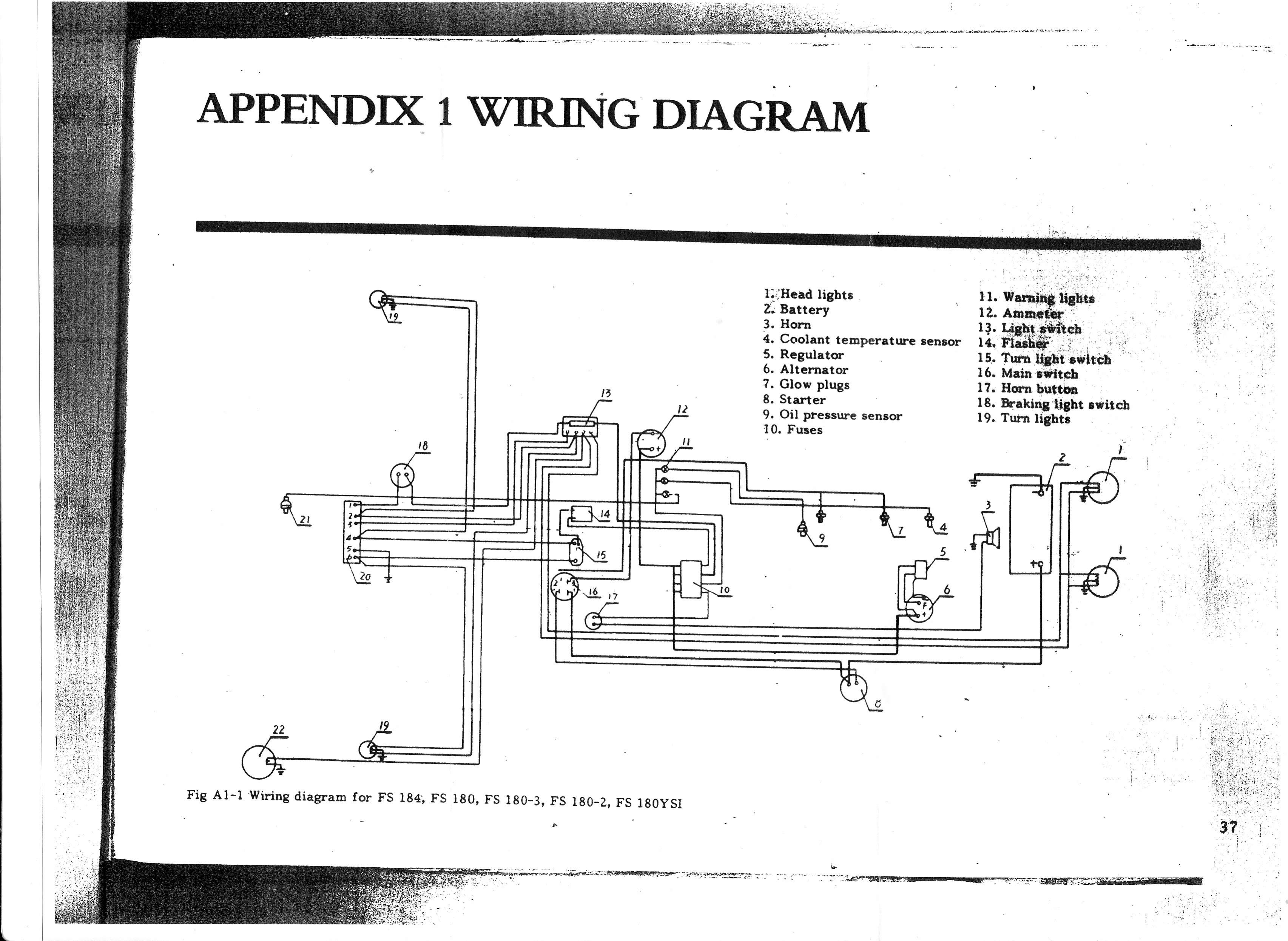

some part numbers for a 180 Dragon with a J285T Diesel engine
oil filter -J285-06-020----Masters Farm Supply 3 3/8 high X 2 3/4 X 1 1/2 center hole [cartridge ]
diesel engine oil is 10W 40 detergent SAE
larger hydraulic oil filter--0552-8601253- Masters Farm Supply . slightly different in size from original that is not available--
replacement filter measurements 4" high X 3 3/8 X 1 1/ 2 center hole [cartridge ]
smaller hydraulic oil filter NAPA-Gold 3507 [cartridge ]
hydraulic oil is 30 weight NON detergent
Wiring Diagram for FS184---FS 180--FS 180 3---FS 180 2---FS 180YSI
Word of Caution when ordering from Masters. They ship by UPS--major rip off. suggestion-ask if they will ship order by USPO and get their name.
that is what I wanted but they still shipped two very small filters about a 10th of a pound by UPS and I was charged $ `14.20 for shipping
I hope these posts help someone out there.
the larger hydraulic oil filter replacement--0552-8601253-from Masters Farm Supply has to be modified. it is open on both ends...you want to close one end of the filter somehow .
remember the filter sits on a spring so I cut out the bottom of a can and used that at the bottom of the filter.
