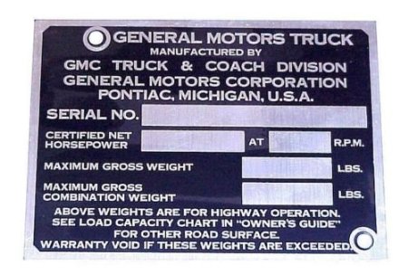

fair enough find me a plate on a truck/or trailer that has a GCVWR

don't doubt it, but nowhere on there does it say GCVWR. i worded my previous replies poorly. another way of trying to say want i want to say is you can be over your GCVWR and still be under your axle ratings, your tire ratings, your truck GVWR and your trailer GVWR. the manufacturers GCVWR is dependent on chassis, 4x4 vs 2x4, motor, gearing and is not published on the plates with those figures you posted.
as for getting trucks/trailer recertified at a higher/lower weight i don't have any experience
however the GCVW may limit you to certain lanes, or over certain bridges
/ Gm 3500 towing #20
yes and GCVW is different than GCVWR. that's all i have been trying to say.
