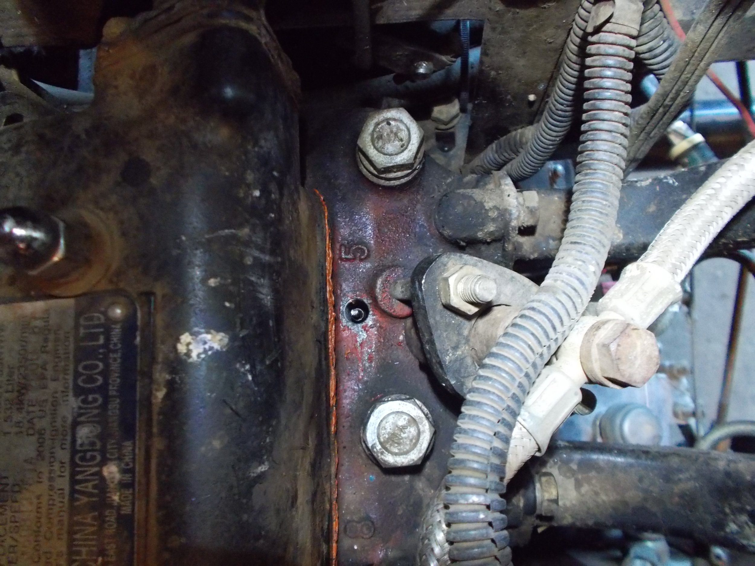

/ Glow Plugs #24
When all 3 glow plugs died I had no choice but to replace them before winter. The front one came right out. The middle one came right out. The back one (hardest to get to) had to be cranked out with torque all the way to the ends of the threads. What I didn't know at the time was the heat end of the center electrode was stuck in the head and the external threads of the outer plug actually jacked the plug apart. Oh-oh, now what?

/ Glow Plugs #26
You can see where the inner core of the plug broke off just below the surface of the head. I could get needle nose pliers or needle nose vise-grips on the stem, but just barely. It was stuck tight and any turning motion resulted in the feel of the core just twisting in place. Not something that would stand up to very many cycles before it broke off out of reach.
I tried every solvent solution I had in the shop. Even my old go to homemade ATF/Acetone mixture wouldn't touch it. Fill the hole let it soak. Blow it out and test. Many repeated cycles including heating with a propane torch as hot as I could get it. As many different combinations and approaches as I could think of for over a week and no progress.
Then I started thinking about exactly what it was that I was trying to de-solve to release the core from the head. Carbon on the element and a copper ring. I had observed no evidence of rust in the other two holes. Thinking about the chemistry I realized that gun bore scrubber is designed to cut through carbon and copper deposits. I soaked the core for a couple of days using several different products, blowing out the leftover liquid between applications. After a couple of days I was able to feel the core turn in the hole! The seal was broken so the next treatments could get in and do the job. Twisting and pulling eventually got it out! Whew! I was dreading pulling the head just to replace a glow plug. The copper washer had been reduced to a smear of green on the rag. Should have bought a lotto ticket that day.
I used bore scrubber on a pipe-cleaner to swab out all three holes before installing new plugs. I also put a dab of anti-seize on the plug threads to ward off any corrosion/rusting that might happen in the future.
