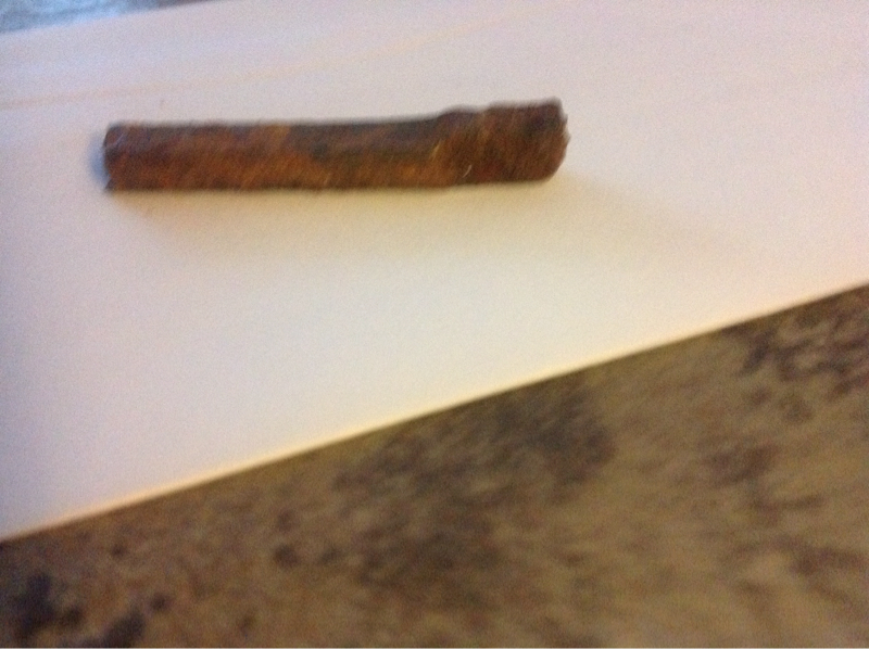

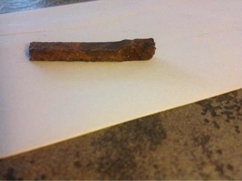

Success! I was able to drive the object out with a large crow bar and a 20 oz framing hammer. Took a dozen or so blows but all is free and the blower is ready to be reinstalled. I say object because I'm still wondering what it is and where it came from. It appears to be cast iron but it's pretty rusty and corroded. It almost looks like a tools hank of some sort. All I can say is of all the dumb luck, the odds of something like this happening must be about a million to one. Here's a picture of "the thing". [

well, the shear pins did what there supposed to do. i wonder where you caught something like that spike in the impeller. Thats nasty. Cant blame the blower on this one.
You are right this was just a freak occurance. It definitely makes me feel better about putting the blower back on to know that this was a rare event. We had our garage doors replaced a few weeks ago and all I can think is that it was some kind of debris left over from the construction crew.

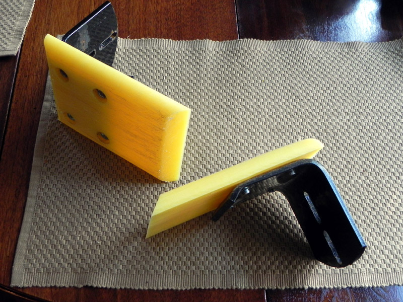

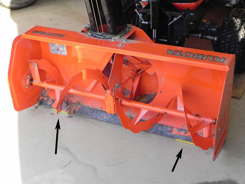

Bob, when my new BX25 and BX2750D were going out to blow snow for the very first time I started off at maybe 2000 rpm. I went about 15 feet and sheared a fan bolt. So I changed it and in doing so I let the old shank drop into the bottom of the shroud. Well, I got back on the tractor, started her up, and engaged the pto. Thunk. The fan stopped dead; it never got spinning. WTF? And now the fan was locked and would not turn. I know how frustrated you can feel about your 2750D. After looking around a bit, I found the old shank jammed between the end of a fan blade and the shroud. So I blew a total of 15 feet and was on my third bolt! In the end I sheared 6 fan bolts that first winter.
This is an awesome snow removal tool. It will move tons of snow; I blew for 2 hours today. You just need to learn its idiosyncrasies and hang in there. A couple of things I did that helped me was to start running at WOT and I made some new skids which actually extend beyond the cutting edge. Since doing these 2 things I have reduced my fan bolt breakage to maybe one a year (1 auger bolt so far this year).

if you would what are the dimensions of the skids and what material did you use....

Looks like an old rusted railroad spike (?)
Or maybe a piece of an old iron railing of some sort. Maybe your construction crew lost it off their truck.
