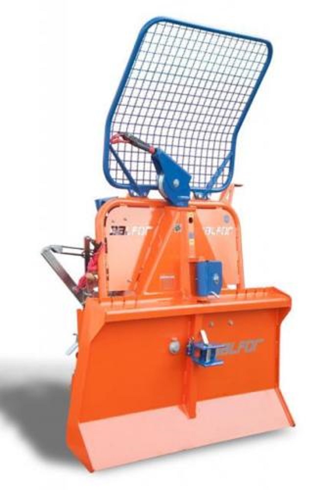

The best would seem to be a 3pt skidder winch but the cost is high and I'm usually using another implement like a snow thrower or rear blade.

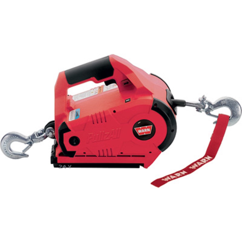

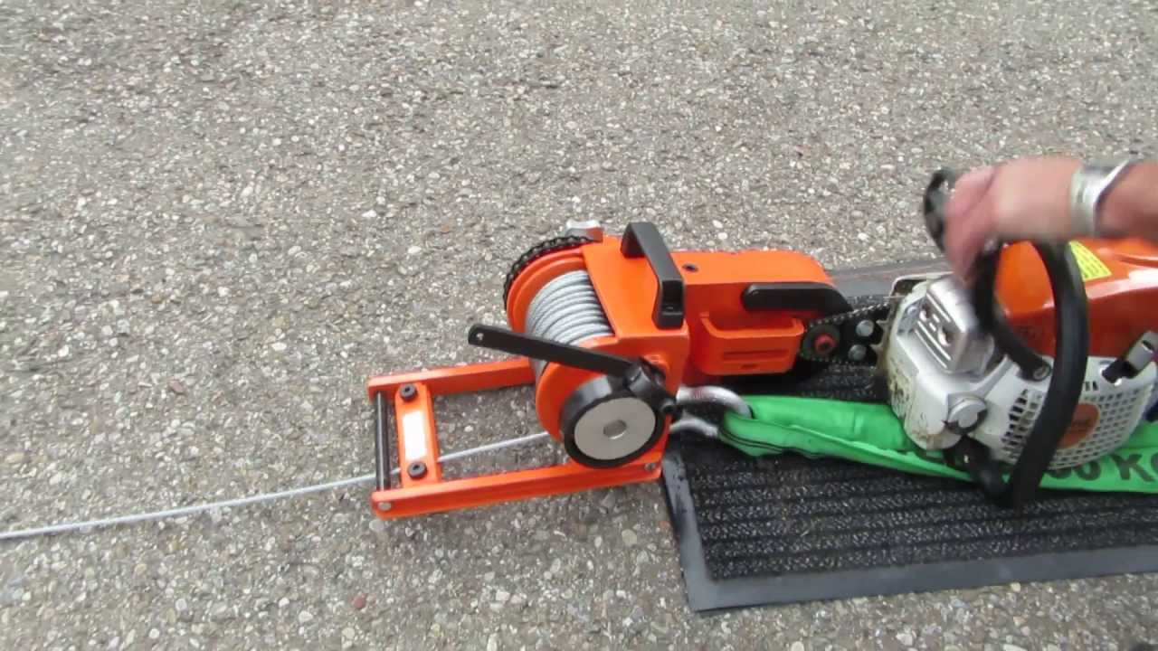

Portable electric or gas powered winches that can be carried onboard are a possibility but Aren't as powerful and require being out of the tractor seat to operate.

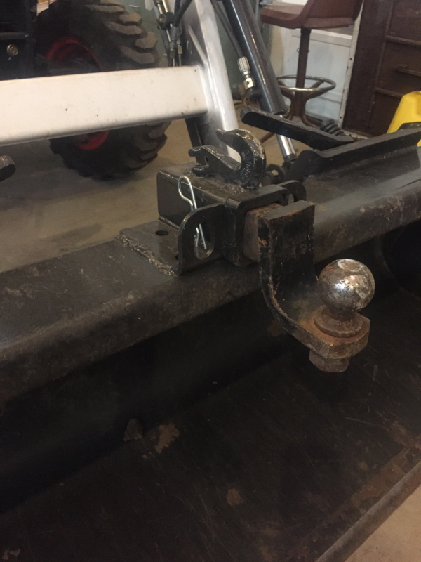

Jeep / ATV frame mount winches would seem to be a possibility. When mounted to the front tractor frame, it would not interfere with either FEL or 3 pt implements. The effectiveness of these winches would be limited by the rather small battery capacity of most compact tractors but the remote control feature would allow you to be in the seat using tractor power to assist.

Don't waste your money on the gas or electric portable winches. They are
ment only for free winching of something in a linear path
with little drag.
Small logging winches are ment to be used from one position and lowered to the ground to create contact pressure
and you can ruin your mules rear hitch if you use it the way your thinking of using it because the winch cannot be
used safely without lowering the base frame of the skidding winch to the ground to tug with.

I'm planning on buying one of those hitch mounting plates that slides into your vehicle Hitch receiver. You can buy hitch weld on or bolt on mounting plates just about anywhere now. So I have bought a couple of them one for my tractor bucket, one for the front of my trailer, and I'm going to try to rig one up on my quick hitch somewhere. This way I can slide the winch into any location that I need to pull from and then just have a deep cycle battery at the ready. And may also consider just running really long leads with good clamps to the winch.
used safely without lowering the base frame of the skidding winch to the ground to tug with. ...

I agree with Leon here. We used a logging winch for several years and it's excellent for tree handling, but not the right tool for getting your equipment unstuck. In addition to Leon's comment, the winch operates at a high speed that would be quite unsafe for vehicle recovery, unless you rigged multiple snatchblocks.
The Ramsey-type winch is a good idea. Although more pricey, they are also made in hydraulic versions that would solve the battery drain problem with electric winches.
