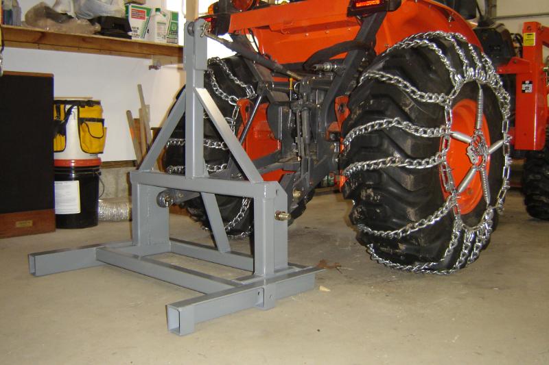

You can see the quick connect bracket mounted to the ROPS on the right side in this picture.
The loop it makes when the hoe is off is small and is stationary.
Vic

Vic, does your 3 point not rub on the hose when its raised?
/ Getting Rid Of My "Backhoe Loop" #10
It doesn't rub with the two implements I have, but if I had to spread the lower links a little wider it would. The dealer welded the bracket to the ROPs when I bought the tractor. The bracket could have been attached a little higher which would have provided more clearance.
Vic
