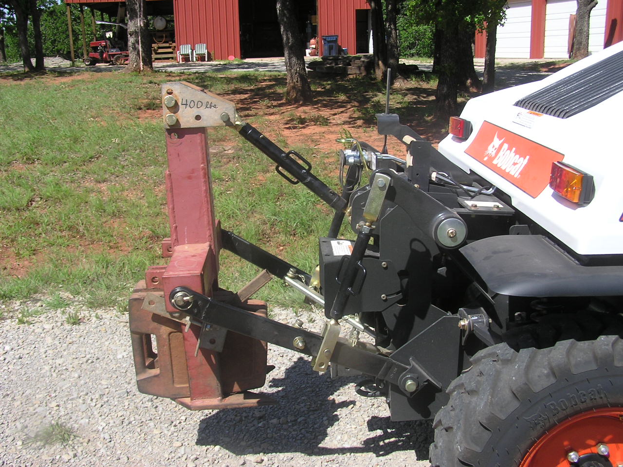

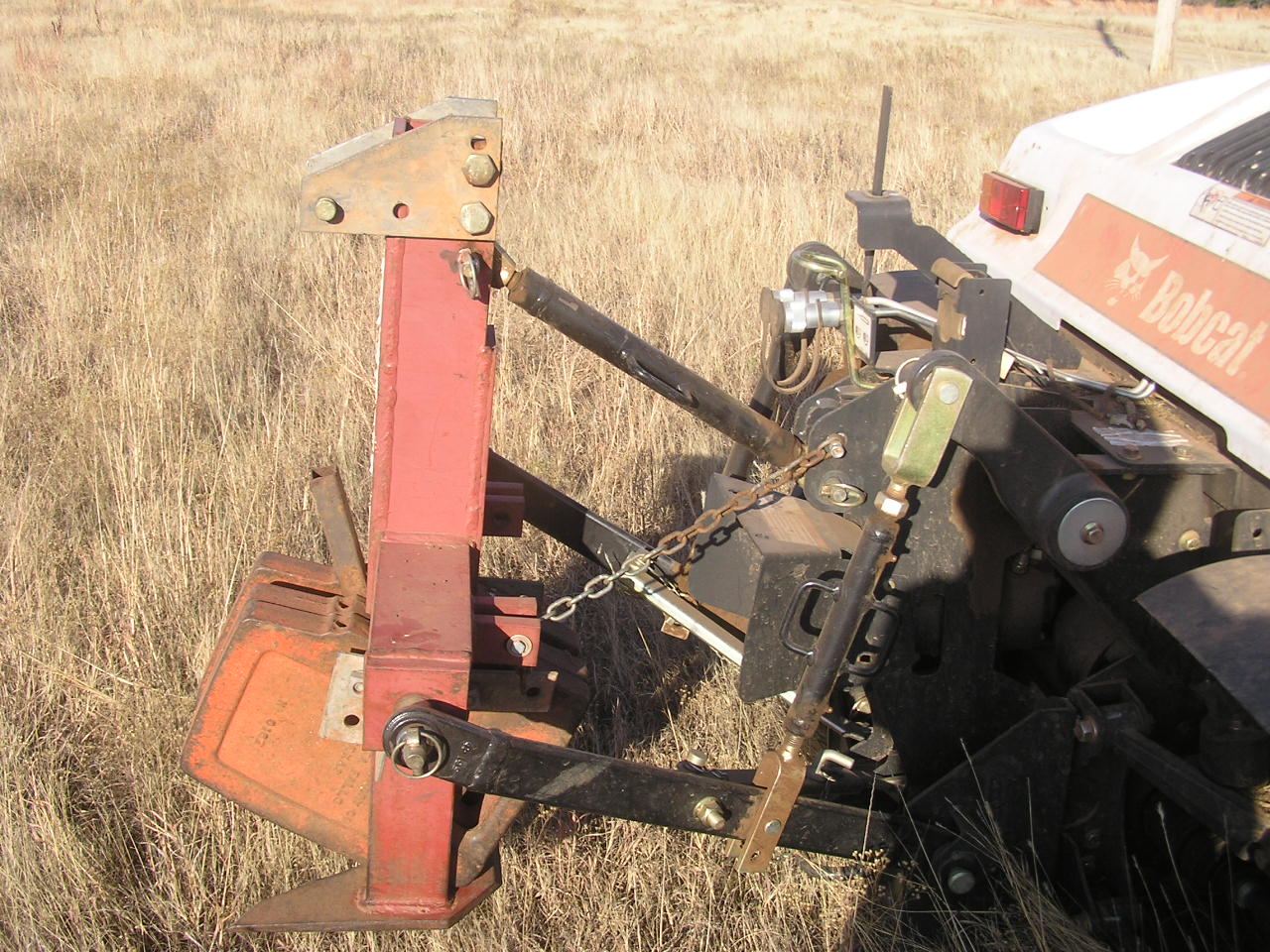

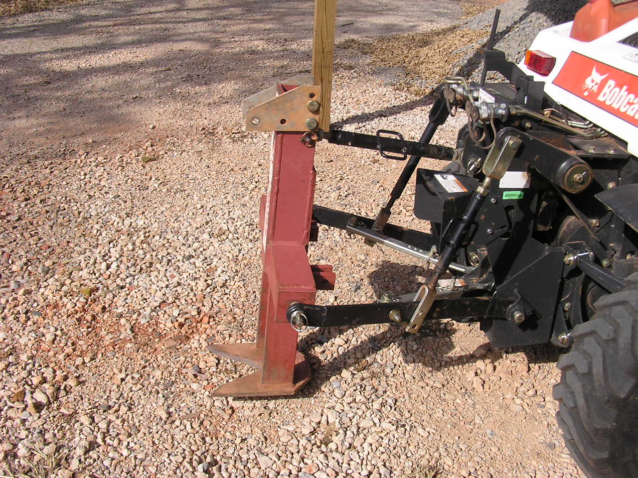

Old thread about grubbers: https://www.tractorbynet.com/forums/build-yourself/271803-tree-brush-wedge-style-input.html
And: https://www.tractorbynet.com/forums/build-yourself/355352-fork-mounted-stump-tree-puller.html
Realized that I can put mine on the SSQA to 3 point adapter and use it on the front.
I will have to convert it from a counter weight back to a grubber :D:
