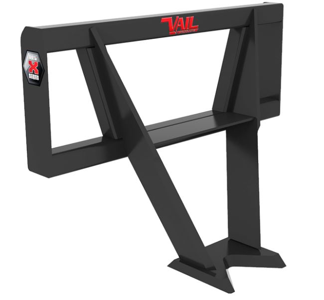

I did an image search on clearing mesquite and a lot of Grubbers showed up that would work on your CTL:
