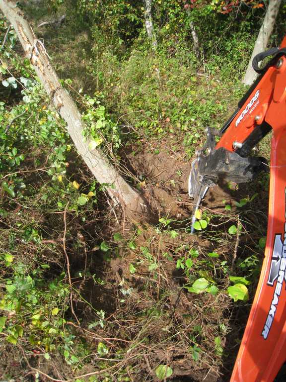

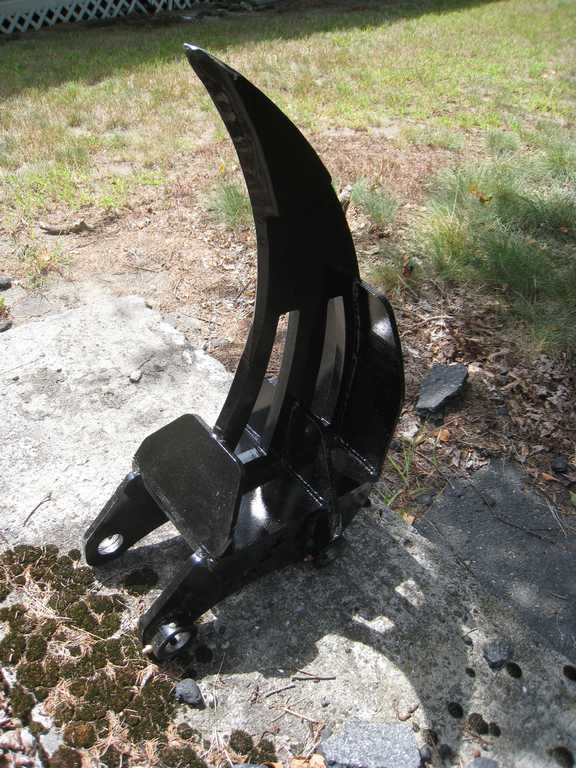

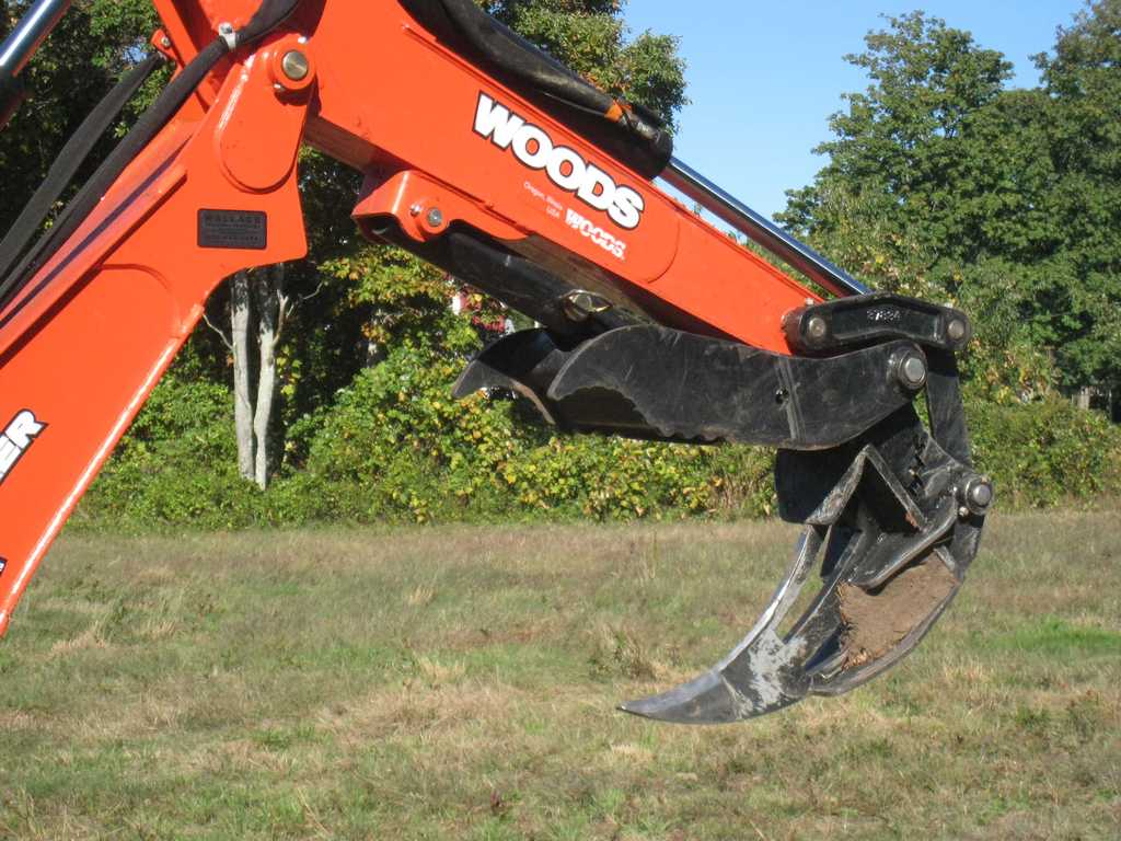

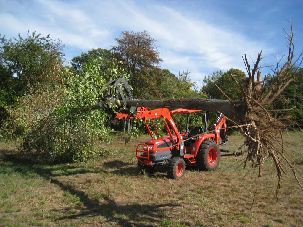

yep, that is the best way to do it. Short of a big excavator though it is possible to rig a backhoe on a CUT to be a pretty efficient ripping machine. I agree completely with the grapple on the FEL too. In fact, I don't even use my BH thumb but just rip the roots on four sides (move the tractor once 90degrees) then push it over with the FEL/grapple and haul it off. Very efficient operation that depends on having a reasonably heavy tractor (to push), a grapple (to carry trash) and of course the ripper on the BH.
