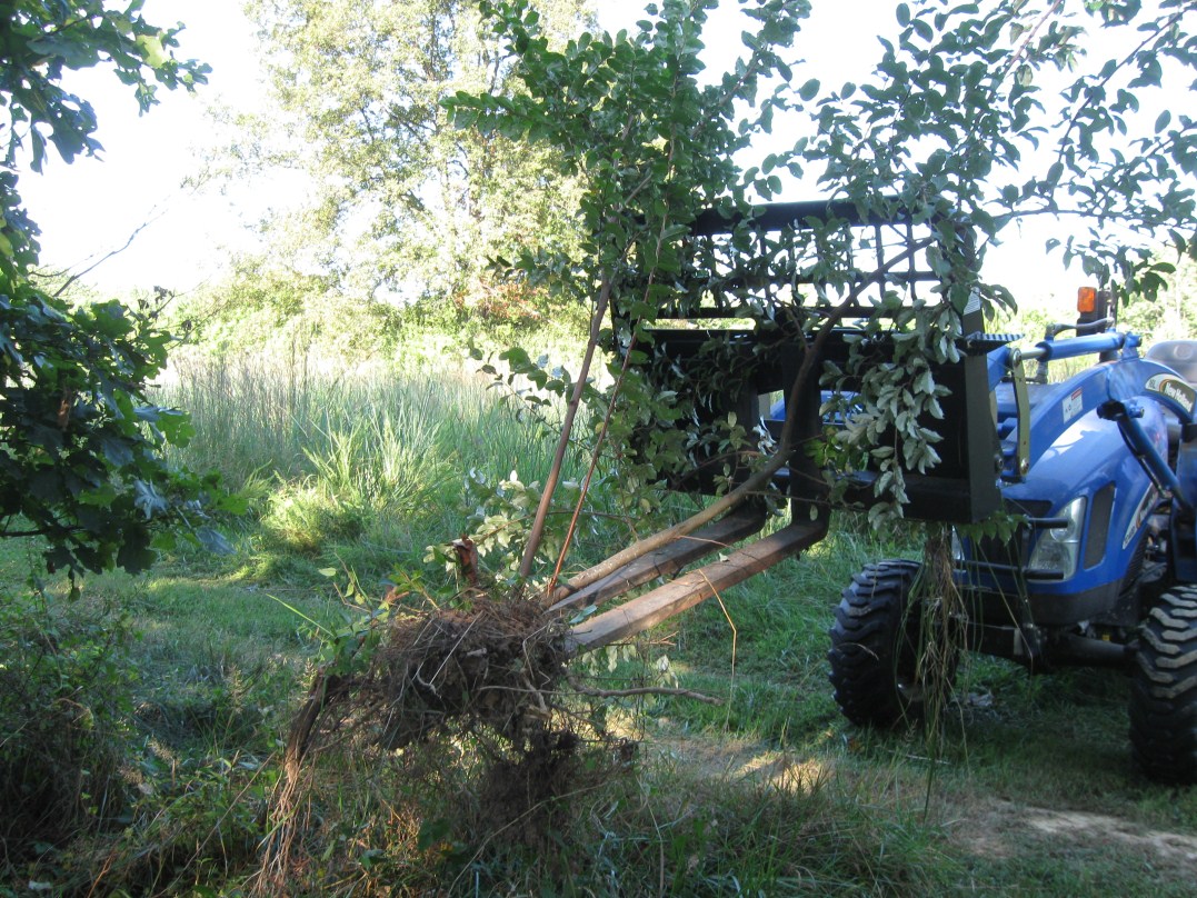

Thanks for the information. I did try the forks this morning and had success with the small trees, but the larger ones behaved as you suggested. The good news is that I do have a BH. I think I can use the combination to get most of the trees removed. As I stated, this is going to be a long-term project, but having the right tools is going to make it a lot more fun!

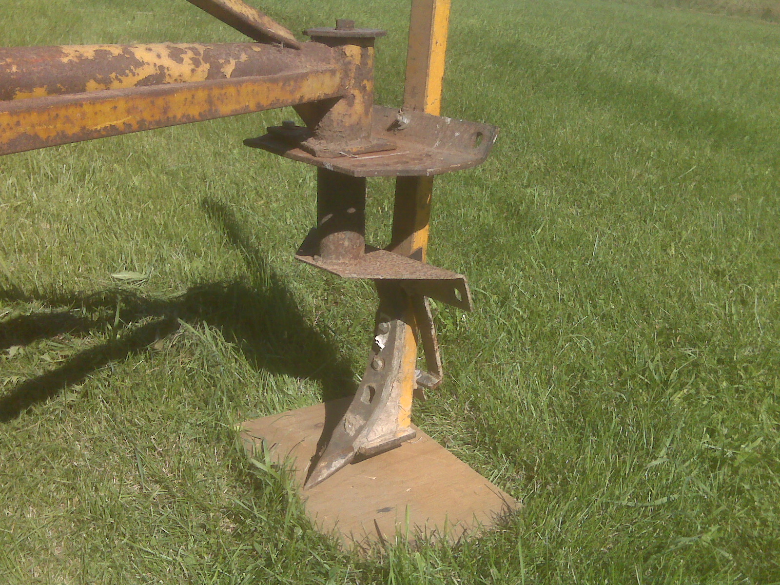

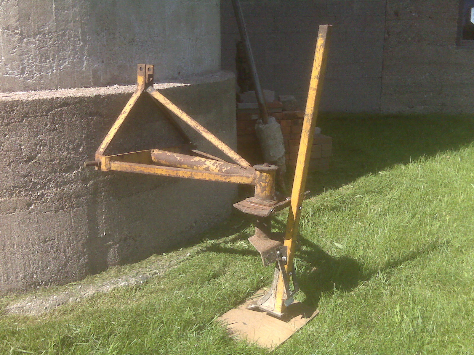

I have a LOT of those (censored) autumn olive trees and I hate removing them by hand, take a look at my cheapo ripper. It was formerly a Speeco 5 foot rear blade, I took the blade part off and bolted the upright to the back of it, then went to QFleet and purchased the tine and bolted it on. I don't have a welder so I used bolts. I hook it up to my 3 point and tear the roots out on 3 or 4 sides, then either use the FEL bucket to push the tree out or hook a chain to the rear drawbar and yank the tree out.
I originally made this to cut trenches for wire and PVC pipe, but it works great on cutting roots too. Yeah, it's really ugly, but I don't care....:laughing:

Nice!. Ugly but nice. I wonder if putting the ripper tooth on an I beam mounted to the 3pt would allow it to extend further back. The only trouble I can see with the ripper/subsoiler on the 3PT is that you sometimes cannot get close enough to all sides of a tree. If it were mounted on something that stuck back four or five feet it would be easier to get roots 360 degrees around a tree.

Agree with you there that the extension would be an asset, my gadget works for me only becuz I don't let the trees get very big.
