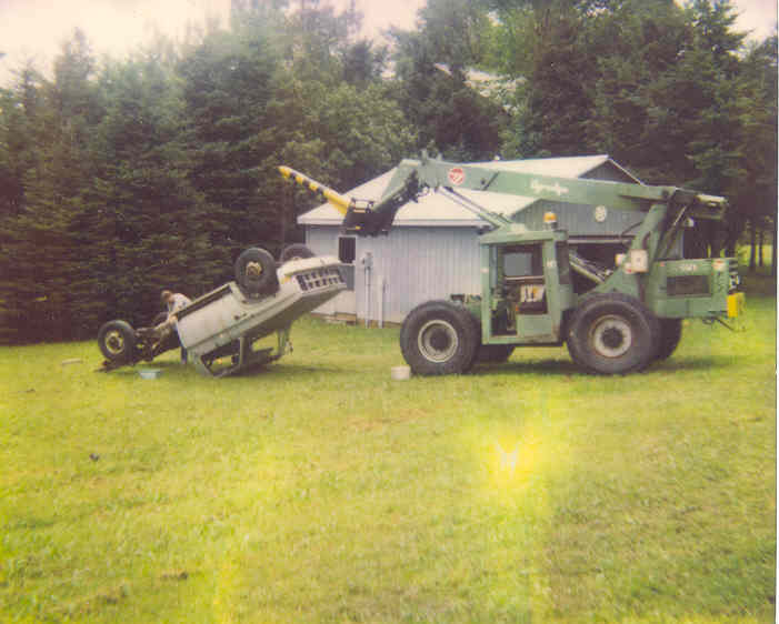

If you have a decent loader, forget the dump trailer feature, pick up the trailer and dump the load by rolling it over. No big deal.
So out of curiosity how would you go about flipping a 7x20 gooseneck dump trailer with 4 ft sides? trailer weighs around 6k and holds 20 yards of material.

Just Flip her over. Same way you'd work on your truck! Dynalift Kens Truck B Aug 13 1994.jpg
