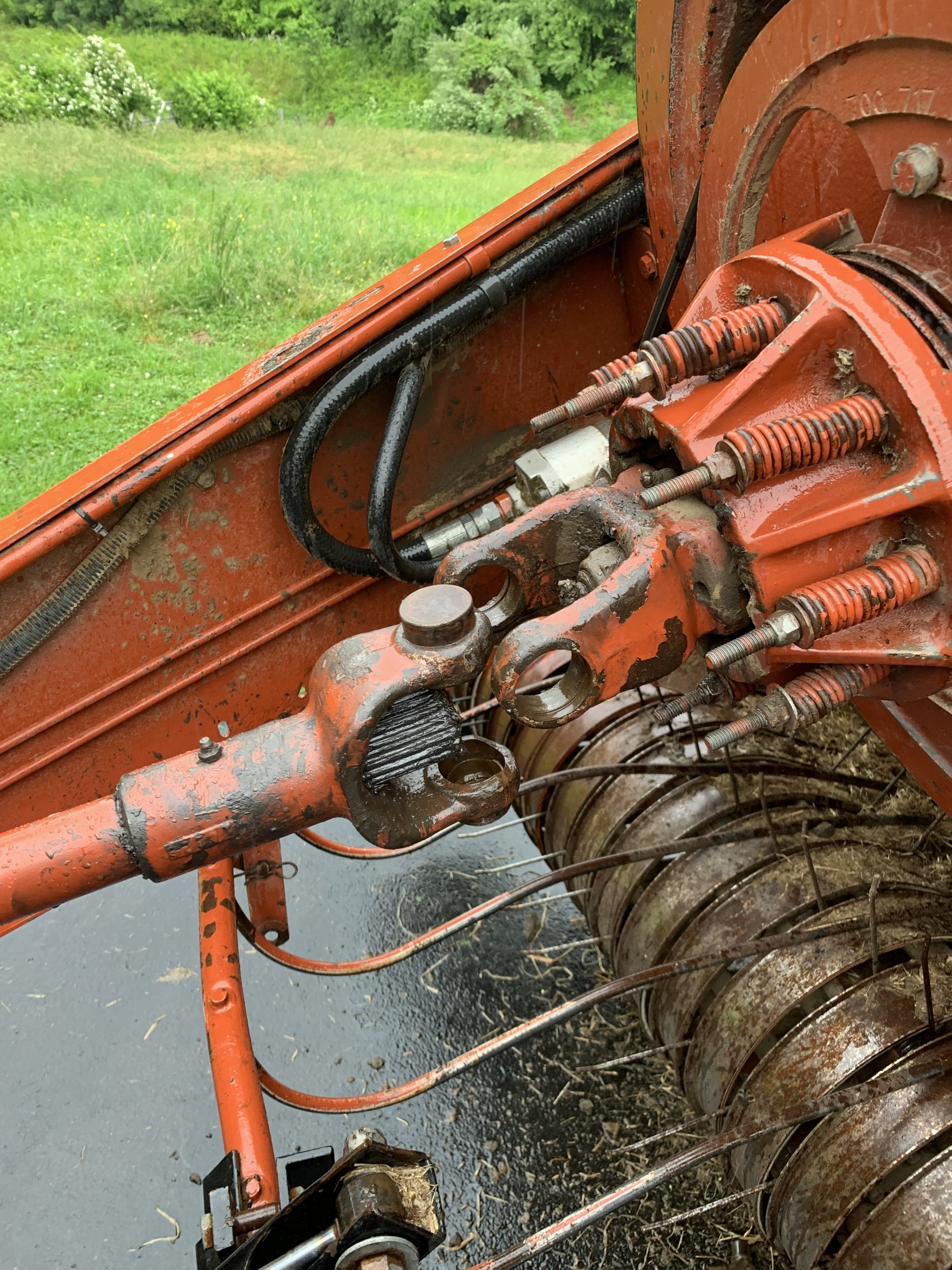

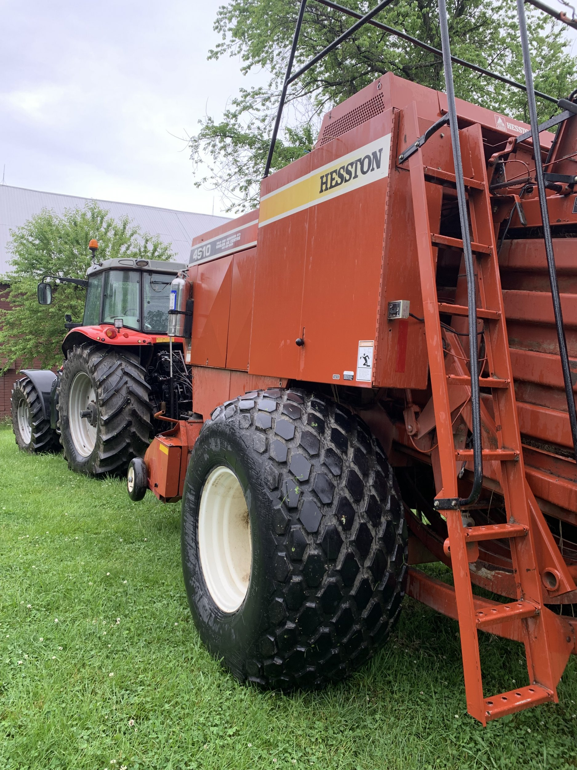

Well back to hay balers. Here we are back at it today on some more repairs & improvements on the Hesston 4910.
One thing I noticed with last years knotter issues was a few twine fingers were not working properly. They weren’t getting oiled. Got into those and got them free and moving again.
Also had a bearing getting loose. Got that off and replaced.
Rain started moving in while doing my last repair for the day-replacing a worn out driveshaft U-joint.
Back together and ready to bale!
