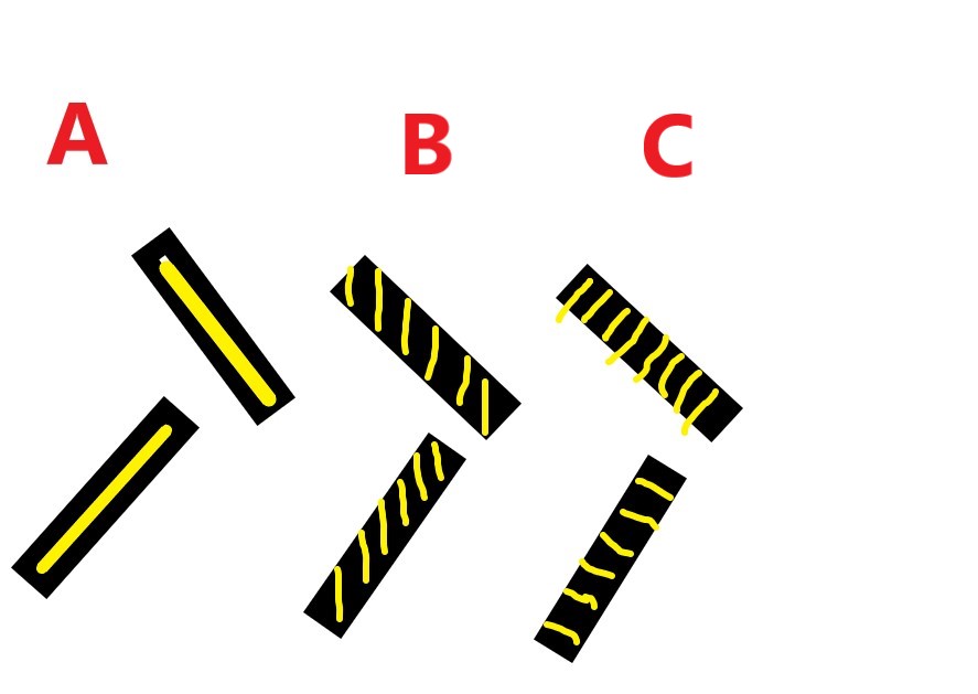

i just siped the fronts. i think i will groove and sipe the rears. i'll order the tool later today so i can do a more uniform job on the back.
   / getting better snow traction with R1 tires #62
Which grooving/siping pattern did you do?
A
B
C
or?

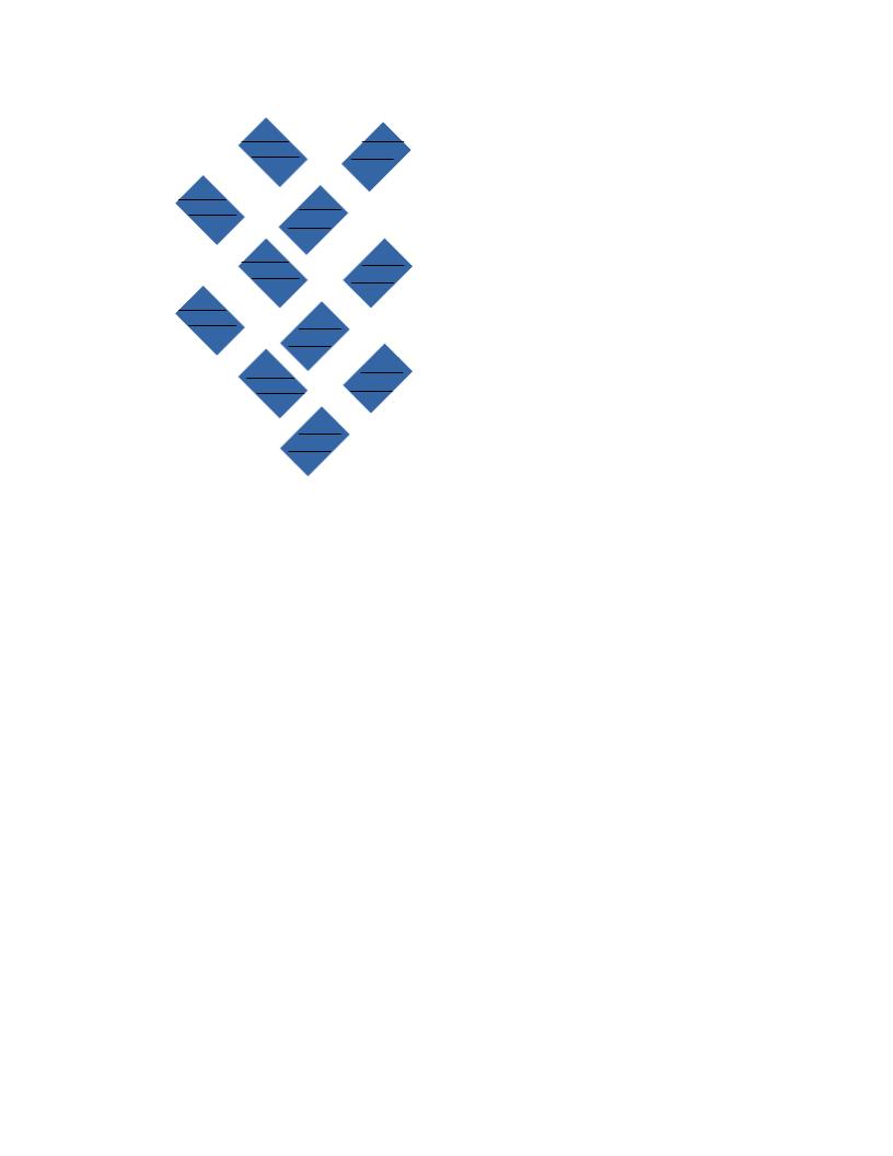

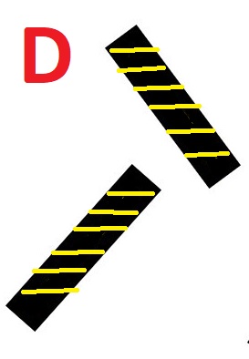

I did B for the fronts. I'll do something like
for the rear tires
