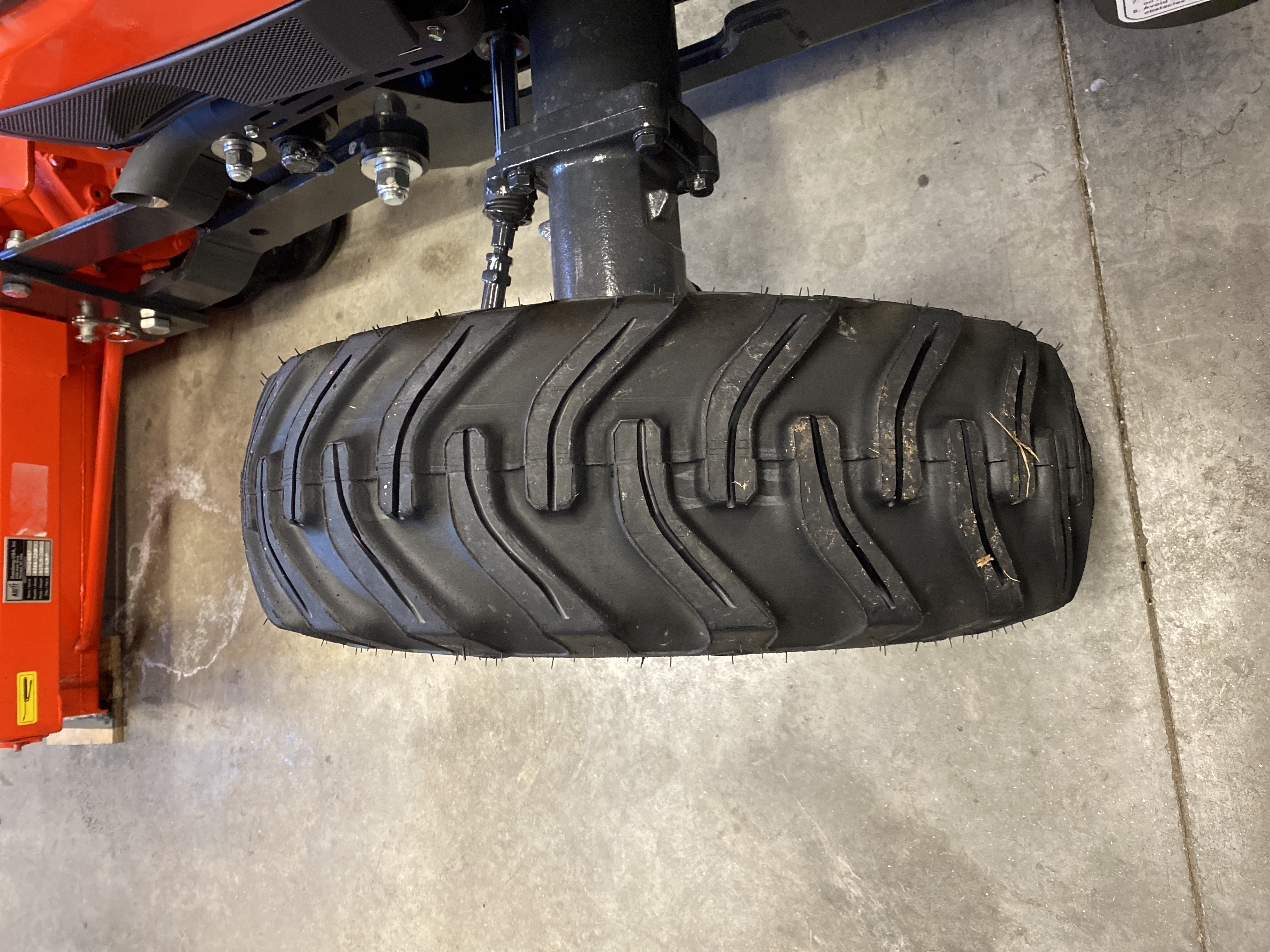

View attachment 685620 - Unfortunately I can't comment on the R1's, what I can tell you is it made a tremendous difference in my R4's - I go places now that I could not previously without spinning - I'm not sure if just the sips would help, it may, but to me would be limited as the groves would grab and hold forward / backward - I believe the sips would help with turning more than travel.....
yes. my whole point. I've found tons of info on siping and grooving R4 tires. Nothing. Absolutely nothing on siping and grooving R1 tires.
George: I like the idea of going down, and I do that where space allows. I have a few that for practical reasons I can't. One I have to take a running start forward, get as far up as I can, and back drag with the bucket, and go again, then blow the pile away when I'm done. The silly thing is I used to do this very same driveway with my B2400 with filled Turf/Ag combi tires in the rear, and turf tires up front. I only occasionally had issues with this one, and no issues on any other driveway. The L3800 is biggerer, gobs more power, and absolutely no traction. The rears are not filled, but I have added close to 200# of wheel weights.
We are all on the side of a mountain. The next ridge over is the 2002 olympic park. We are steep, and the properties are all $,$$$,$$$+ (almost all) I just bought this L3800, I don't have any $$ left for new tires. I was hoping to find a low buck way to improve my traction. Chains are out, I'm not a paving contractor, and I don't need to make a bunch of insurance claims in the spring. I heard that grooving and siping works really well on R4 tires, but have no info on anyone who's tried it on R1s. IF anyone has, please post your thoughts here. Did it work? What pattern did you use. Grooves only? Sipes only? Both? I thought I'd try making mine look a lot like R14 tires with sipes across the lugs. I'm afraid I'll end up chunking them though. And while replacing R1s is cheaper, it's still out of the budget (this has been a crappy snow year, I am not sure how I'll make the payments on the new equipment as it is.
