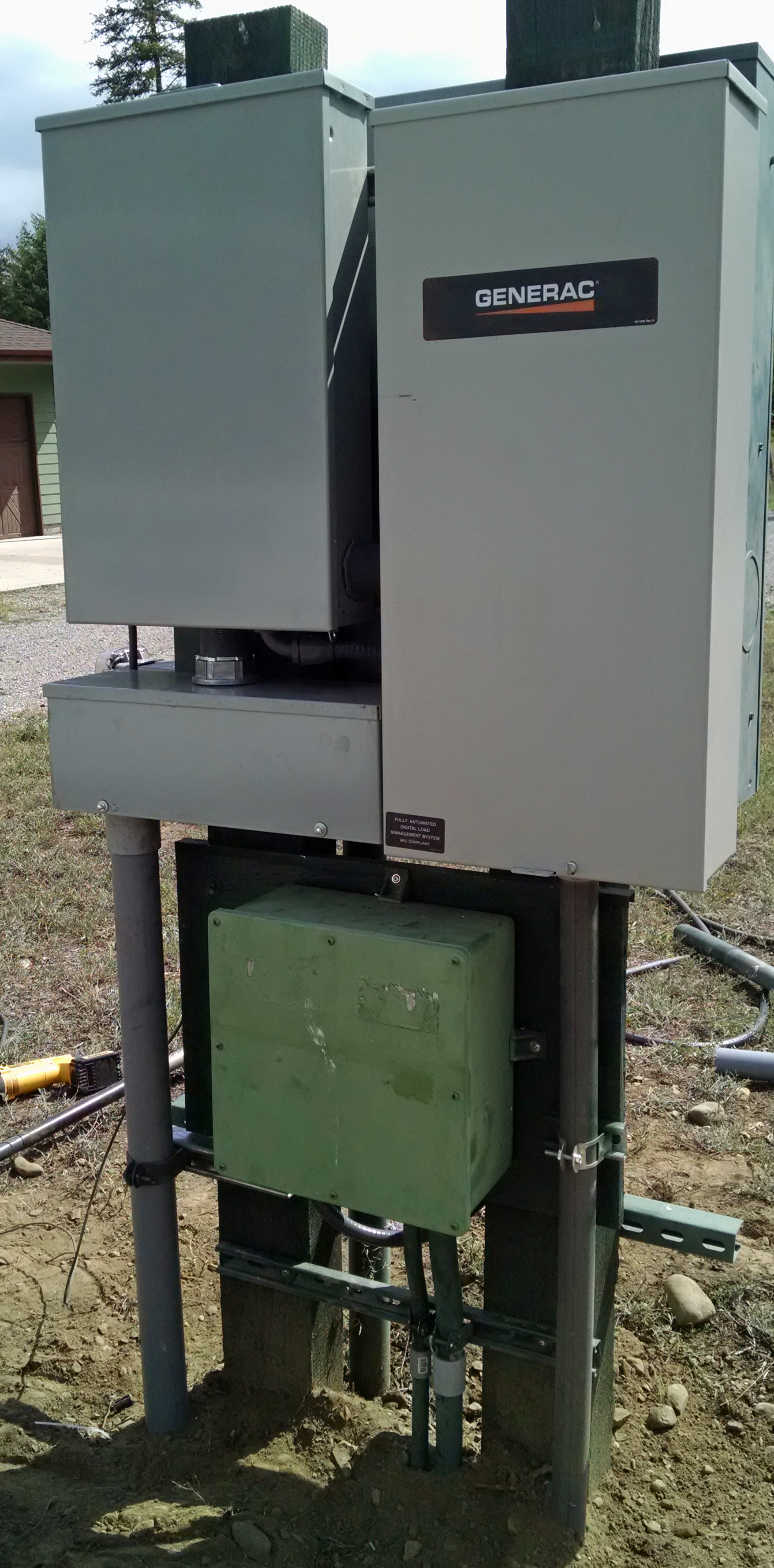

Nice job on the wiring, very clean.
I believe you said you install Generac.. If so, do you know what a close color match is for the enclosure of the Guardian generator? I just had a 22KW unit installed and the monkey's nicked the paint unbolting the unit from the crate. I'd prefer to get a rattle can if I could, I don't really care to deal with these people if I don't have to.

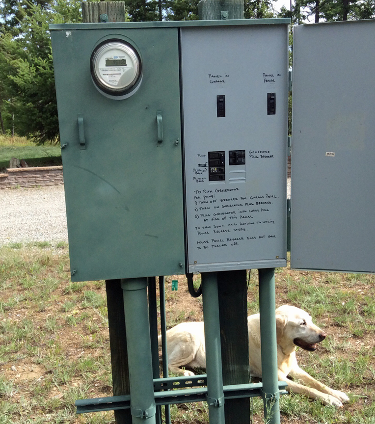

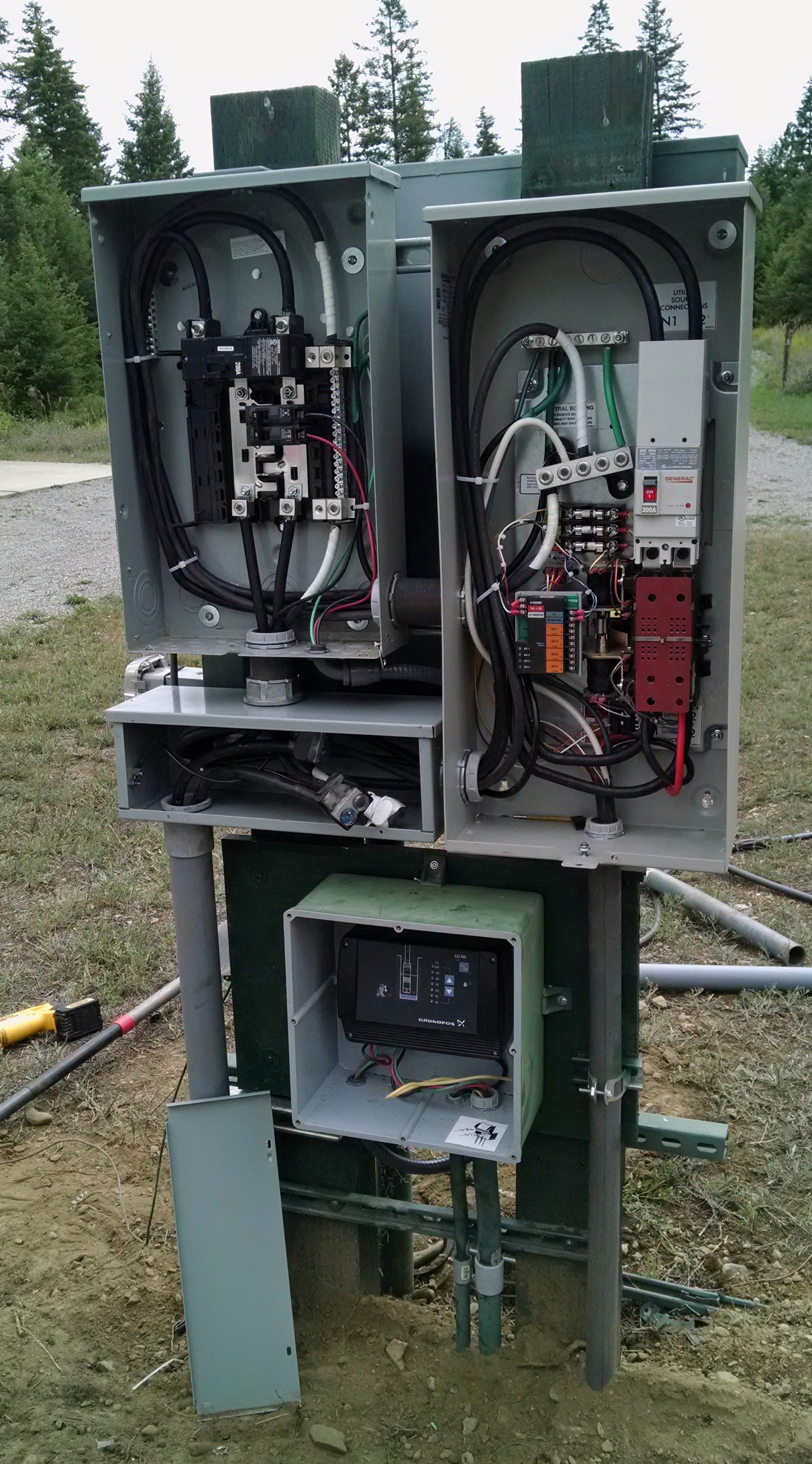

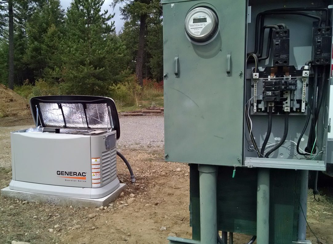

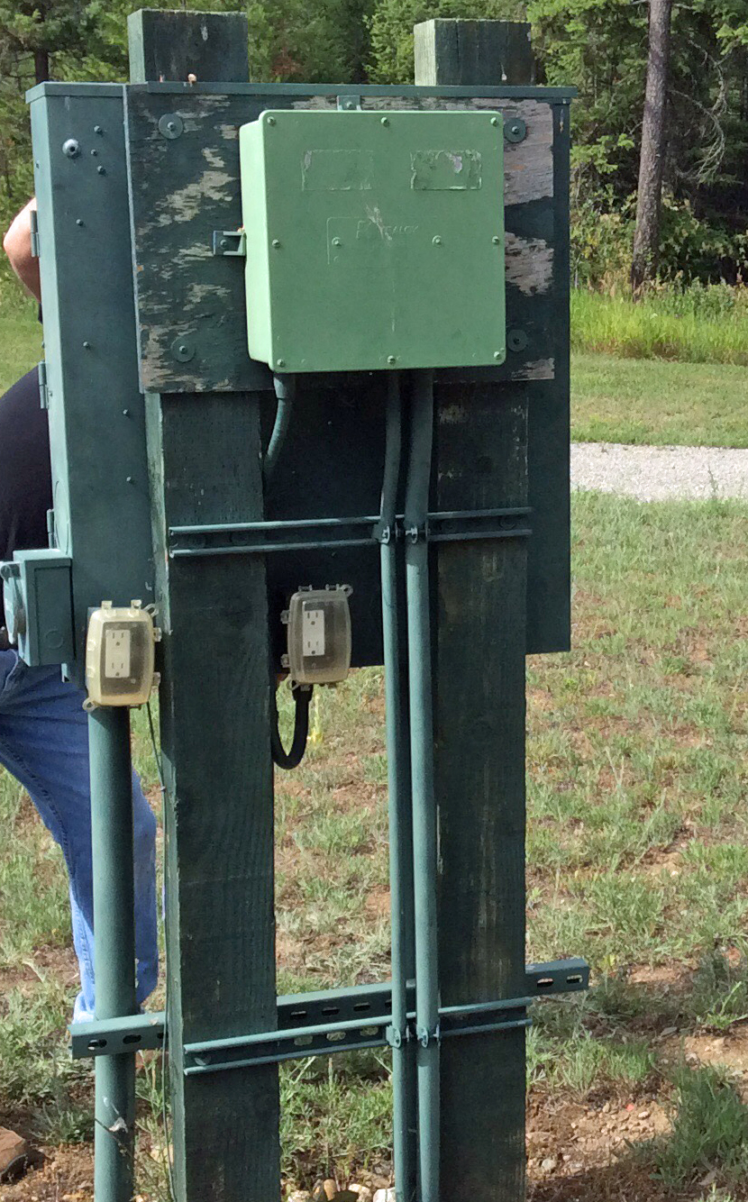

not all generators are easy to install. i did this one yesterday and it was a pain. problem was he had a 400 amp service and only wanted one side controlled, but he also had a well control he wanted added. in order to add 20 amp well to a 200 amp service i not only had to add a transfer switch, but had to add a 200 amp feed thru panel so i could add the well. then i had to add a gutter ( j box) and reroute the feed to the house.made for a cluttered install but i can see no other way to do it. The inspector loved it. Original panel are first 2 pictures. If you notice all the writing, the original owner had a suicide manual transfer system installed.....no interlocks.
View attachment 477212 View attachment 477213
These are install pics
View attachment 477214 View attachment 477215 View attachment 477216
