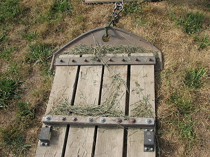

Above is a picture of the front half a stone boat. Note the turned up steel end to slide better and keep from digging in. Heavy steel with holes to bolt 2" planks to. Hardwood best and note the cross bracing. It's usually 2" planks and hardwood like maple or oak preferred. Use carriage bolts or the bolt heads dig in and catch on things.

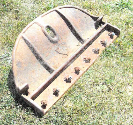

Above is a closeup of that turned up front that's commercially made. It better be rugged with a strong point to hook up the chain. Ir's easy to make one if you have a shop bend the steel plate. Just do it right or fail under hard use.

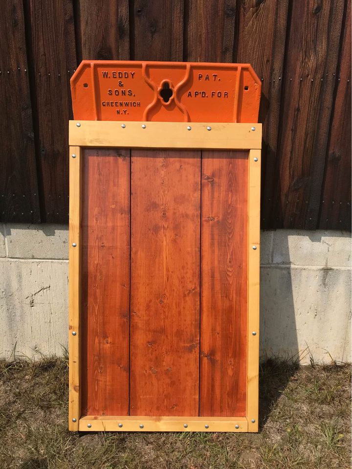

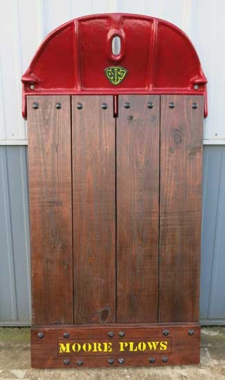

Here's a beautifully made commercial version and looks the same as the one above. At this length no cross piece is needed but a six or seven footer would need a 2X piece of wood for bracing support and to keep rocks from sliding off. Also put a 2X at the tail end. I can't recall a stone boat longer than maybe 7 or 8 foot and most were maybe 6 foot. Rocks are heavy and really offer sliding resistance when pulling.

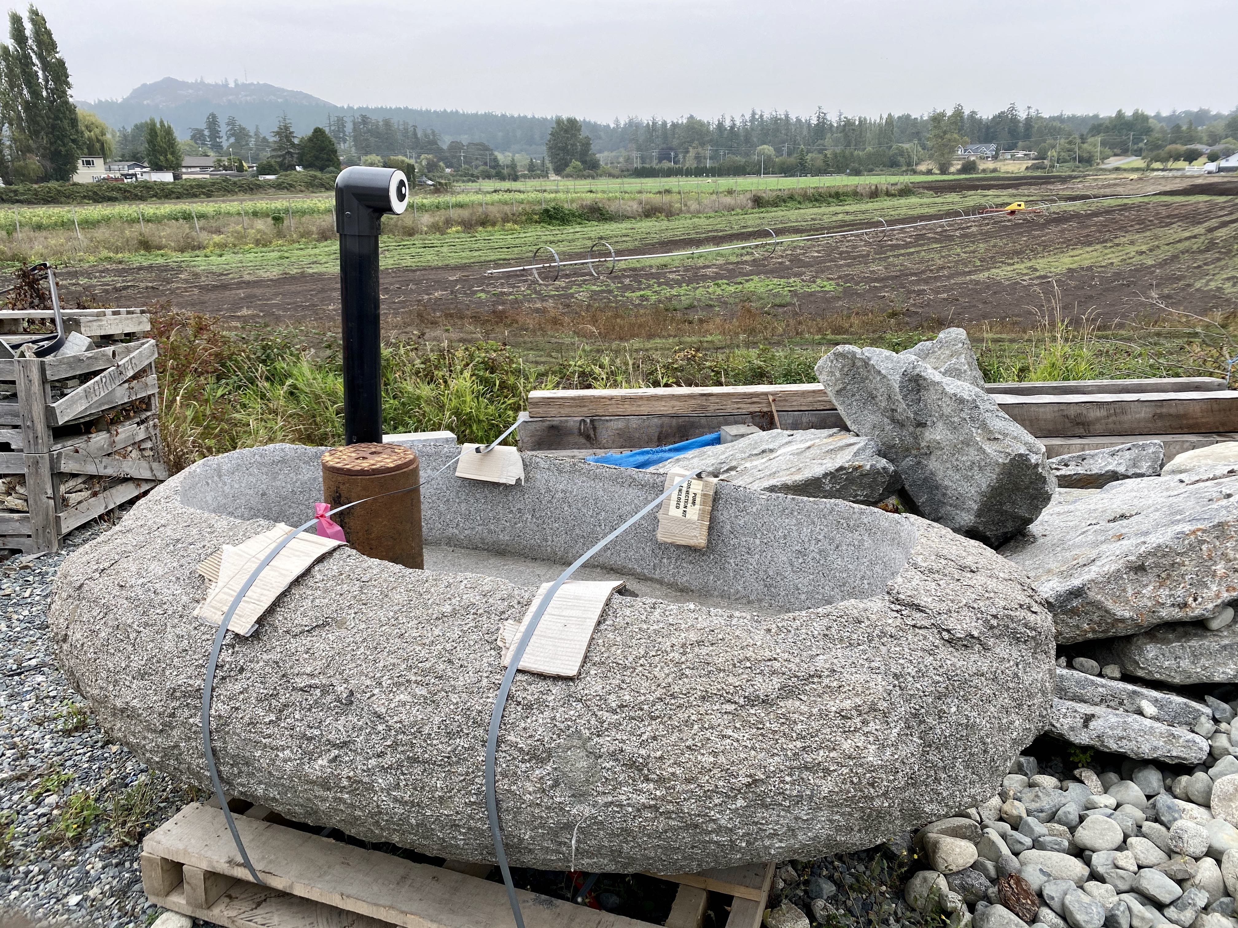

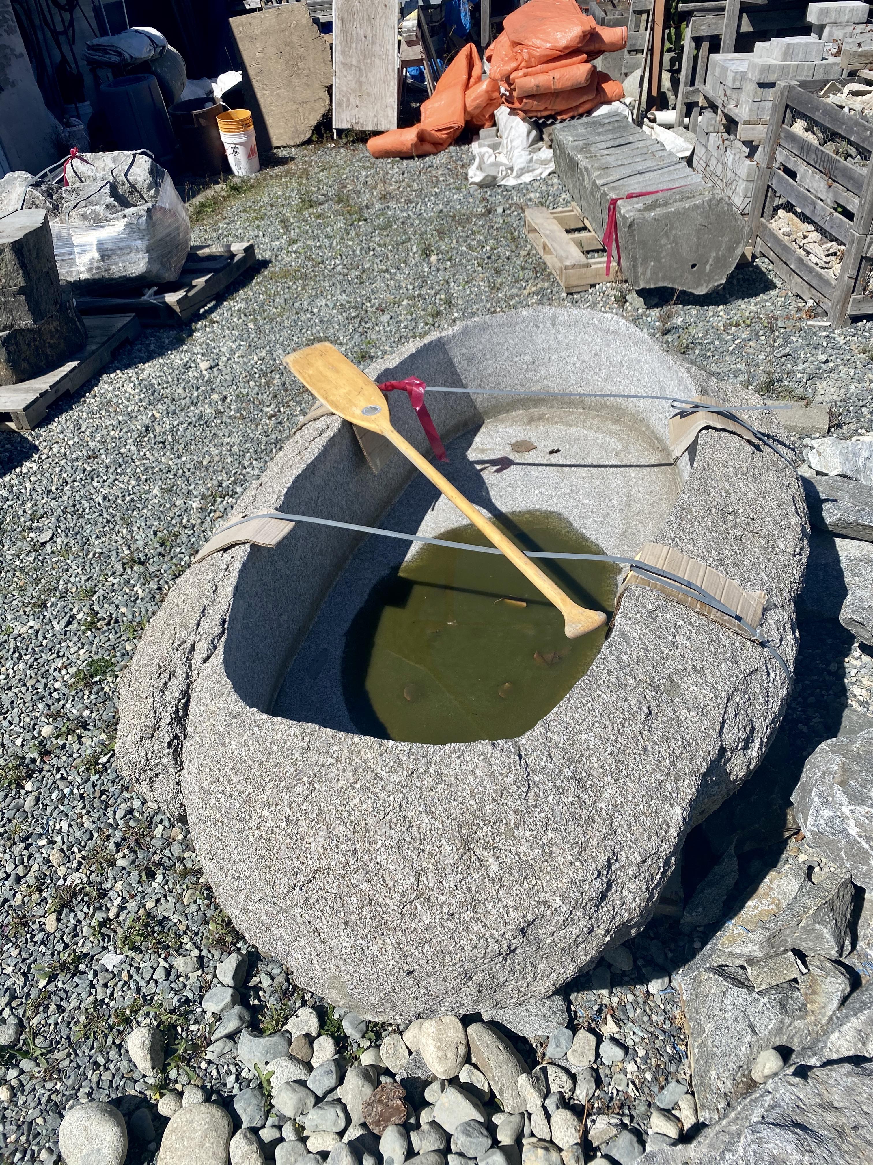

You sure that's not a submarine that you use once and throw away?
Worlds first disposable submarine. One time use only. Commissioned for the Royal Canadian Navy*. Ready for shipping.
*if you are Canadian you would know this is not much of a stretch.

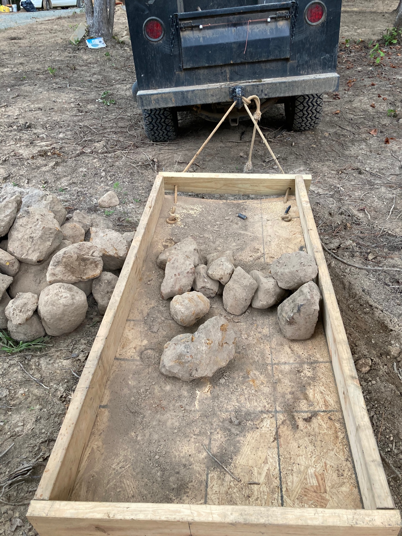

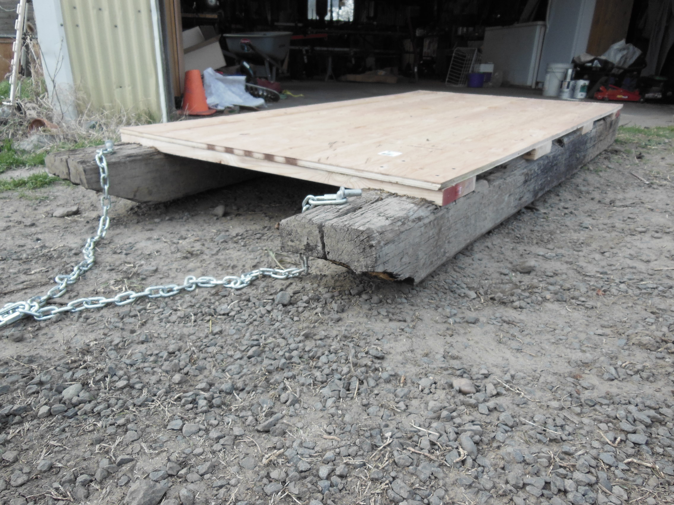

CDCC6B2A-B8BA-4EE6-9BDD-D3FDB7BF07EC.jpegI
just built mine from stuff the framers were gonna burn. I told the guys, Im in charge of all material disposal.

What a beautiful steel front piece and if someone is ever going to build a rock sled, this looks like the one to get.
/ Generic stone boat pics #20
Almost looks too nice to use....
