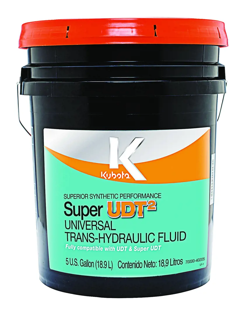

Kubota #70000-40205 5GAL SUPER UDT2 Installation Tips
Kubota #70000-40205 5GAL SUPER UDT2​
$140.62​
59 In Stock
Product replaces 70000-40105 70040-4L105 70040-4P105
1 2 3 4 5 6 7 8 9 10
Add to Cart
Weight: 42.00 lbs
  • Kubota® Super UDT2 is a multi-purpose all-weather hydraulic fluid.
  • This product is specifically recommended for use in the Kubota hydraulic, final drive, transmission, differential, and wet brake systems.
  • Kubota® Super UDT2 provides the following benefits to Kubota equipment:
    • Improved transmission performance and protection at high and low operating temperatures
    • Unique friction characteristics on wet clutches enables smoother start off, drive control, and PTO connection
    • Superior corrosion resistance and efficient filterability protects transmission and hydraulic systems
    • Improved transmission efficiency through reduction in power loss
    • Meets Kubota’s stringent specifications

I use Kubota fluid. SUDT2 synthetic. I pay the price. When I did my 50 hr change I bought aftermarket fluid. Immediately noticed in cold weather my power steering would howl for a few minutes until it warmed up. When it was time to change again I went back to Kubota SUDT2. Howl went away.
