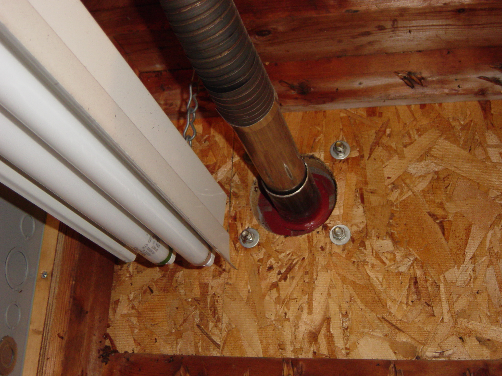

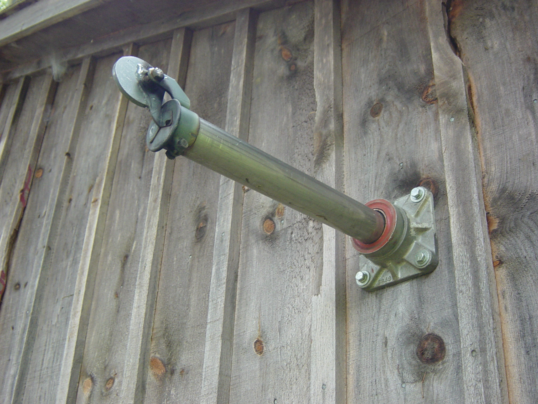

If I had to buy a generator end for a small Diesel, it would be nothing but a Stamford. Genuine, not knockoff. Buy the adapter plate for the particular engine, that takes it to SAE and bolt on the end. Don't rely on junk when you rely on it. There's always enough other stuff to go wrong anyway.
Where my main genset exhaust leaves the building, I used an old four bolt bearing housing, without the bearing. Filled the space with high temperature silicone, so it would not transfer heat to the wood wall and would sound isolate it somewhat.
   / Generator shed #36

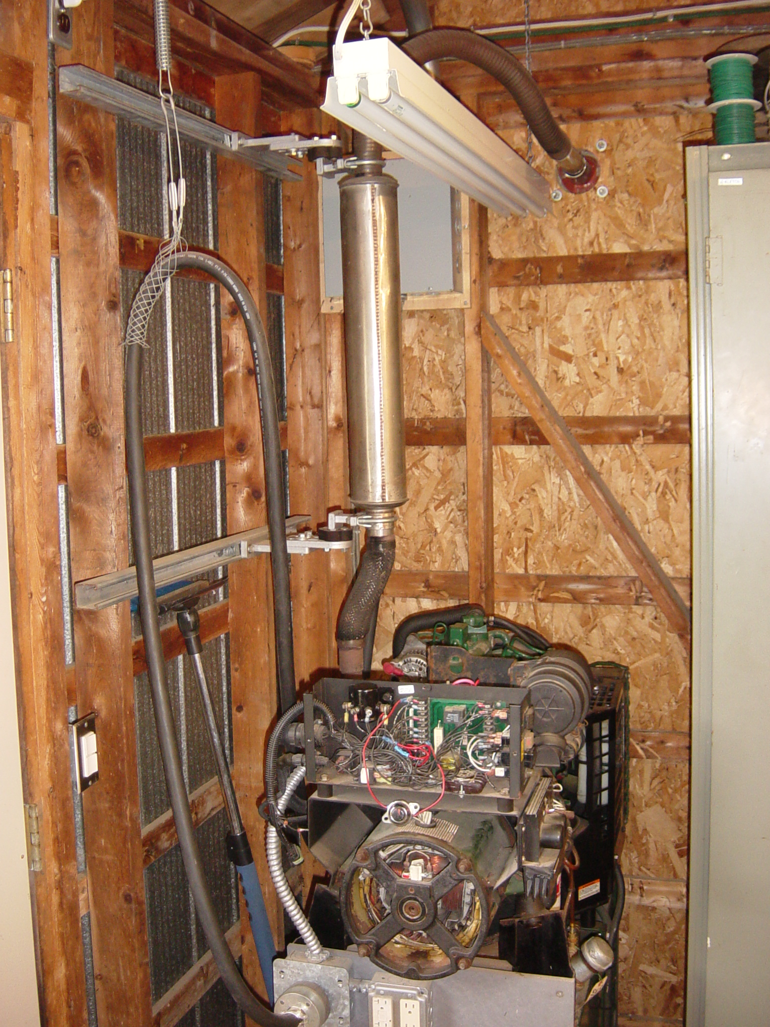

A few pics of my (I thought) engenius solution. More then a few places around here have burned from generator exhaust.

As previously pointed out , condensation is a problem in generator shacks . As previously dated the exhaust should use an insulated thimble . The hot air should exhaust through a set of gravity dampers that the rad fan blows open. The cool air inlet should also be gravity dampers that are drawn open from airflow.
A little bit of warmth to keep the inside of the generator shack 2-5 degrees warmer that outside will prevent condensation. A good source of heat is a coolant heater in the engine . Also allows the engine to rev up to full speed and take full load immediately .
A 600watt 240V block heater wired to 120V will make 150watts of heat and last for decades without burning out.
