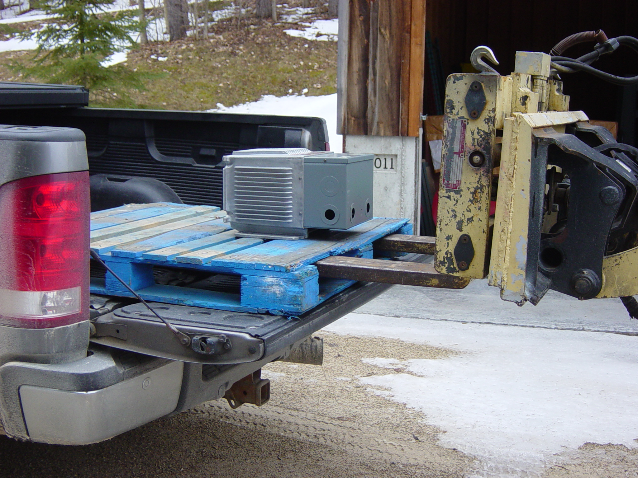

TOTALLY incorrect. 110/220 is NOT split PHASE, it's single phase, centre tapped neutral on a transformer.
Transsformer I drove to Buffalo for, to make 110/220 on my project. Harder to find a 110/220 to 110/220 transformer than I expected, especially in this third world
country.

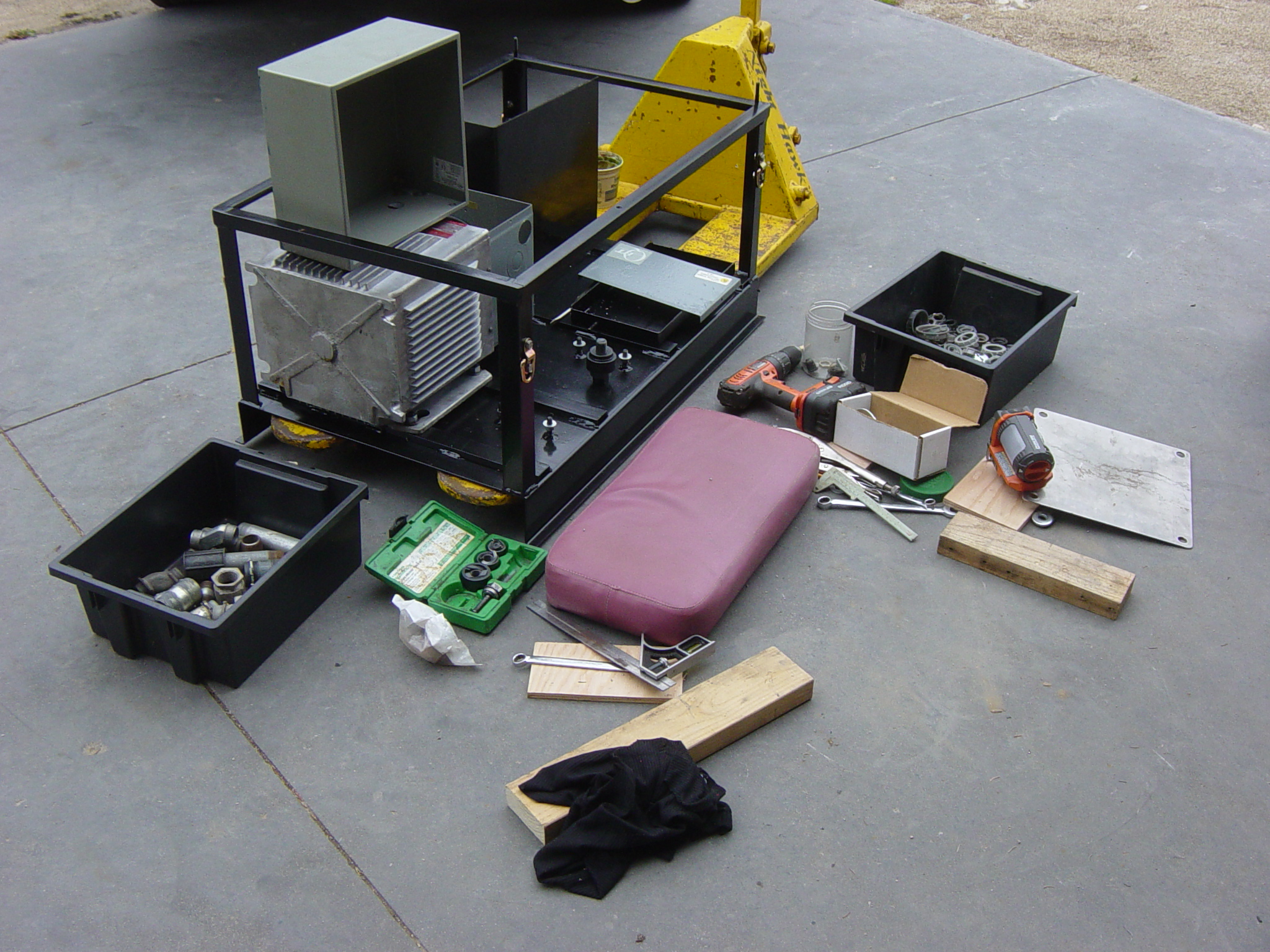

Messing about with installation of transformer. Generator sits atop frame.
   / GENERATOR QUESTIONS FOR YOU EXPERT ELECTRICIANS #22
You are correct that 120/240 is from a single phase. This is commonly referred to as "split phase", as in splitting one phase. The only issue with a transformer is that you need one large enough to handle inrush if you are starting motors. The inrush current is multiplied 2:1 at the 120 side. Too small of a transformer will result in saturation and major voltage drop when the load is applied, and possibly toasting the transformer if left in that state long enough.
