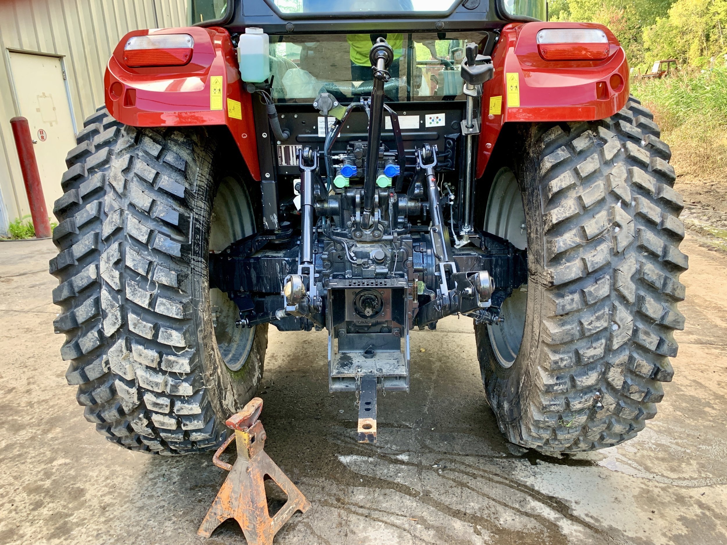

The tread pattern clearly says they ain’t R-1 or 4. They are not turfs so what’s left?
Fact is I like them for what surfaces I want to use the machine on.
Nokian i Tri2 are a diff breed altogether. I use them in snow and they are great on the road. Probably not the traction of either R tires. More of a specialty tire. They are not cheap. I won't have them on my next tractor as pretty much none affordable. They are over 10k for the 4 of them.

Not exactly true. I replaced the factory R1’s on my JD 4720 with R14 Nokia TRI 2’s on the same rim. Tire shop didn’t have a single issue.
R1’s sucked for my lite use and were horrible on ice and snow plus the ride was very rough. I had run nothing but turf tires on an old JD750 and then on a much larger NH 4835. They were abused on the NH year round but if it saw mud out in the fields it just stopped.
I love these R14 but they were rather pricey.

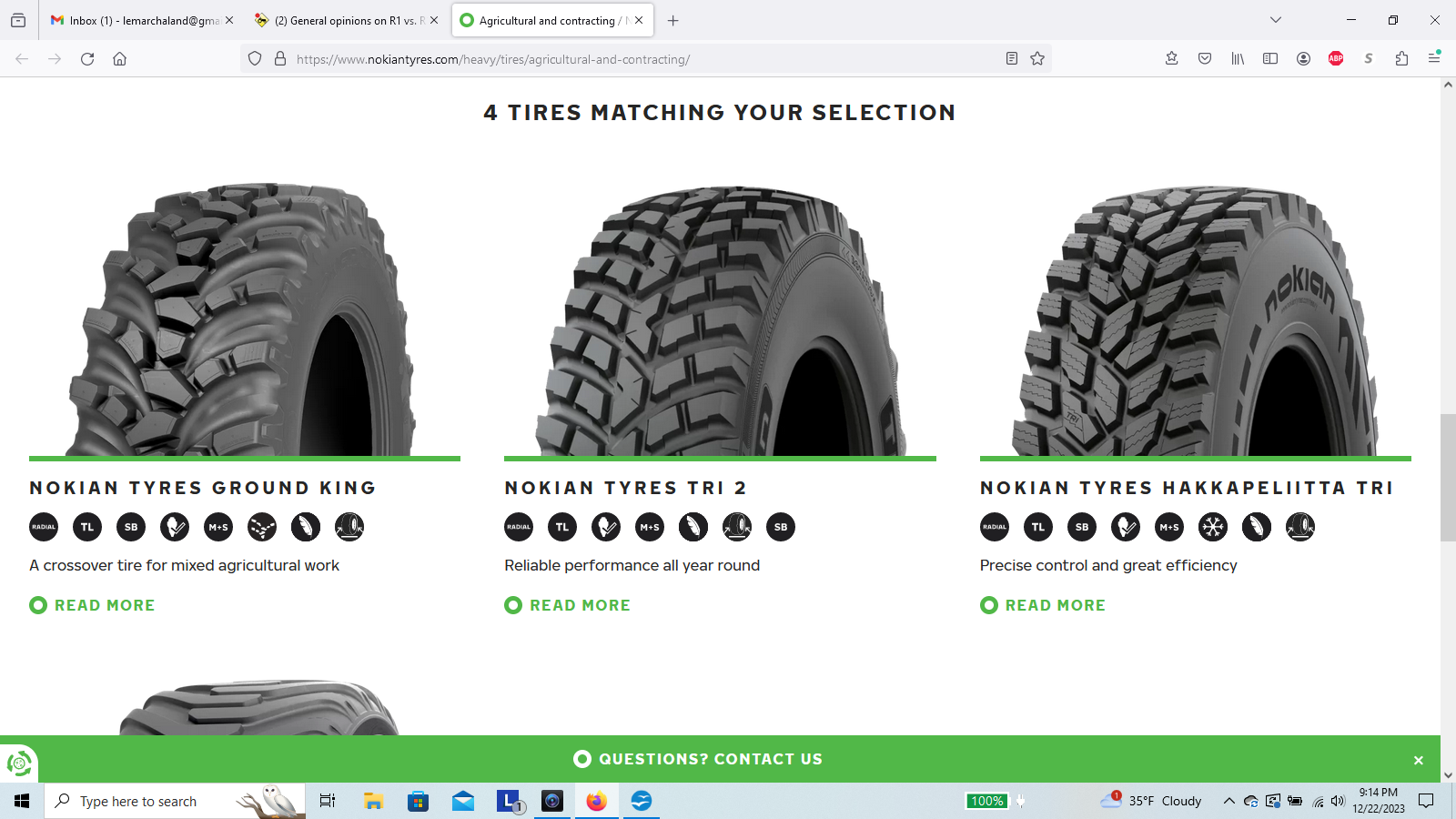

The ground king comes the closest to the R14 design, The TRI 2 is a more highway oriented tractor tire, and the Hakkapeliitta is the snow tire version.
Goodyear / Titan have the R14 some of the other manufactures have there own tread patterns available.
Those Nokian tires are like my Yokohma Alliance 550 Multi Use that I have on the front of my TC45DA. I like them and the only issue is the sharp shoulders can cause damage to grass when turning sharp.
This is mostly about the rear tires but there is also information on the 550s.
