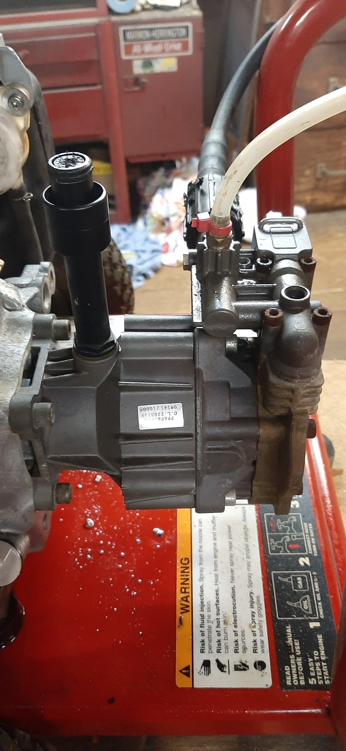

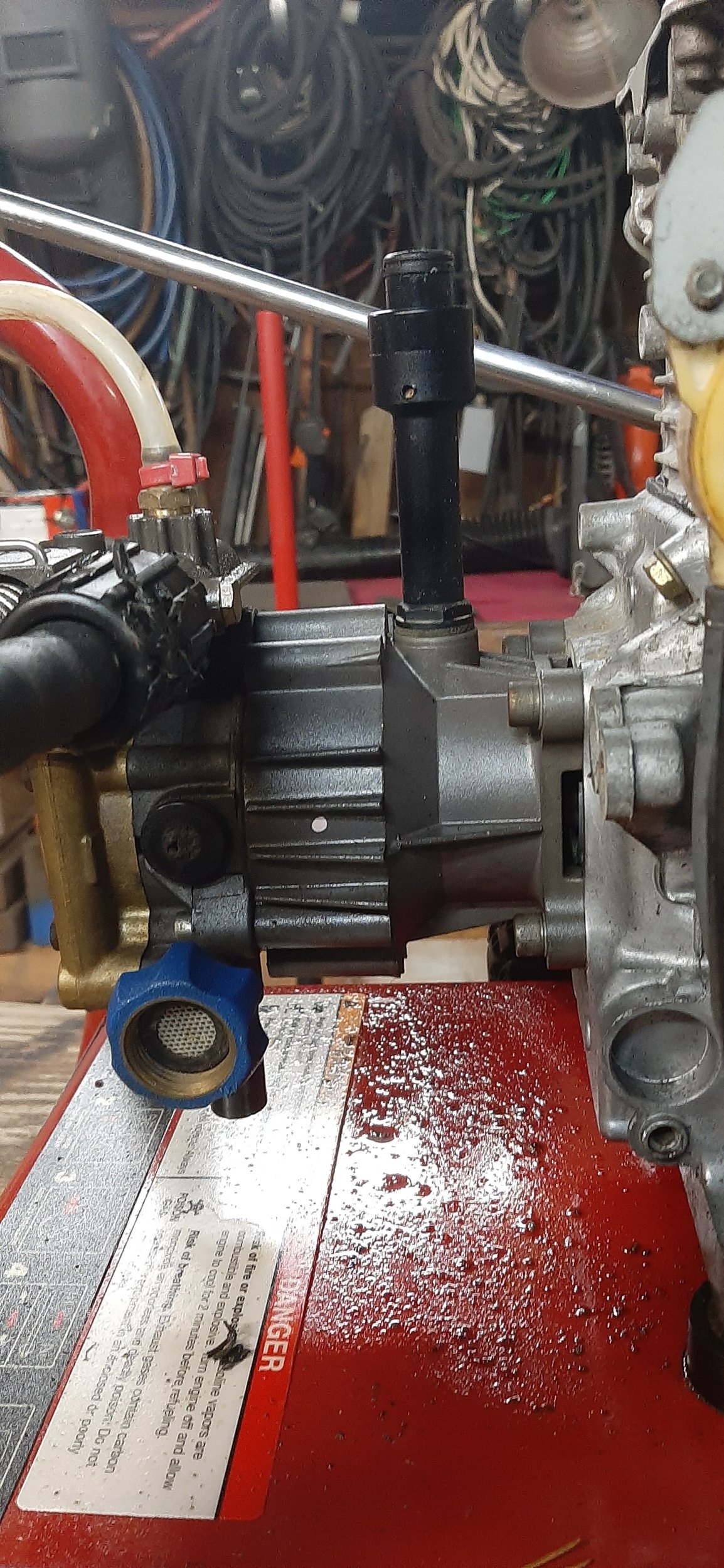

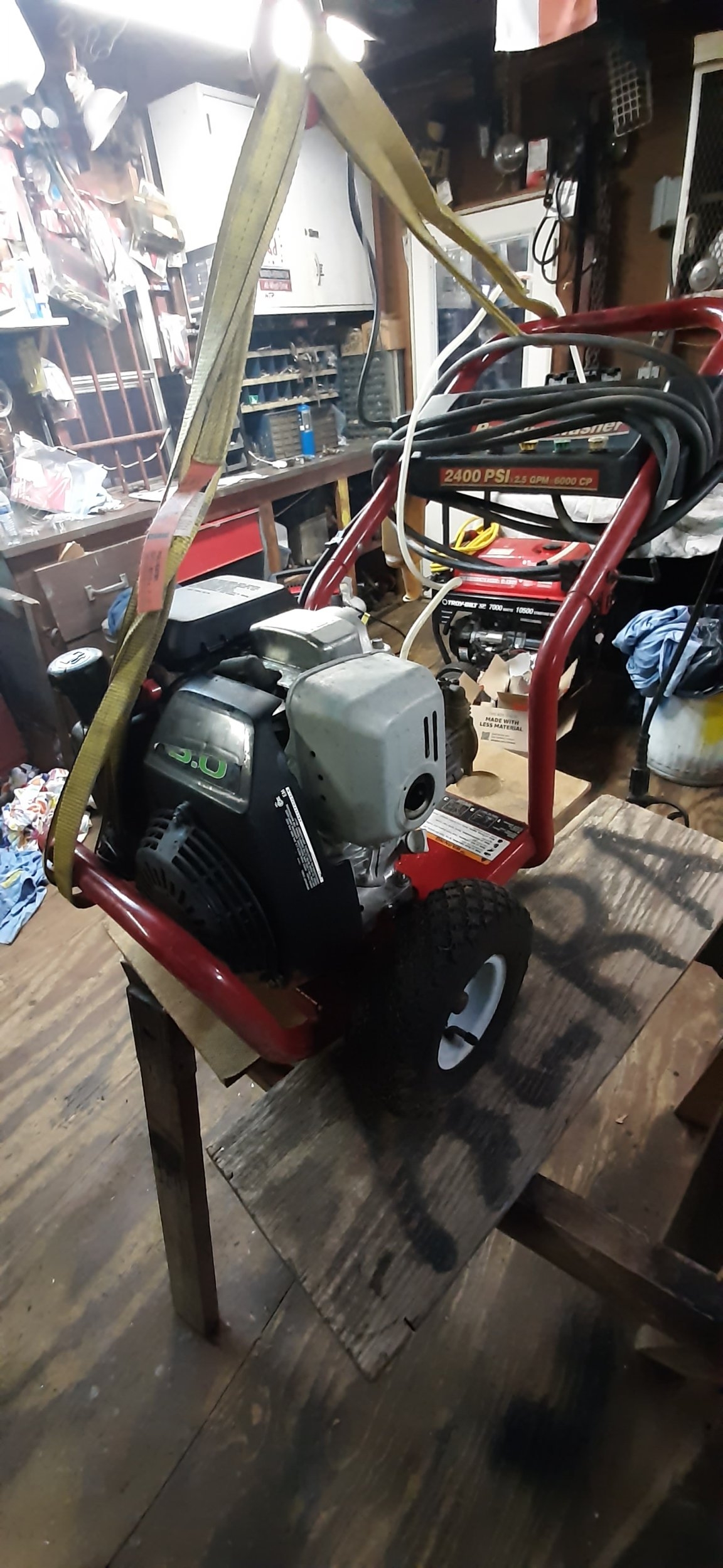

Any pressure washer pump gurus here? Just a wintertime project, yeah yeah I know, go electric. This is my brothers ( I also have the identical unit) that has been sitting for 10 years, and moving forward with troubleshooting and possible repair. This model 20 years ago was about $299, and appears they are $399 today so maybe worth a little effort while ensuring not throwing good money after bad.
This is a Generac 2400 psi Model G24H, and I have the parts manual. Only trouble mine has given all these years is the small chemical tube valve needed replacing once.
I flushed everything out and changed the oil, all looked good.
Test run last week:
- Hooked up water hose, no water would flow through.
- Pulled about 10 times and it started strong, shut off several times, kept restarting.
- Pump worked fine under pressure, but acts like unloading valve stuck or something, only stays running while holding the wand trigger.
- Motor will shut down on it's own, with low load, I think that's something to do with oil pressure diaphragm valve that restricts fuel flow.
- New oil is now contaminated with water I think, this has to be verified.
So looks like I will remove the pump and go from there. This is where I need help. Maybe I can disassemble and clean it up, new one is $80.

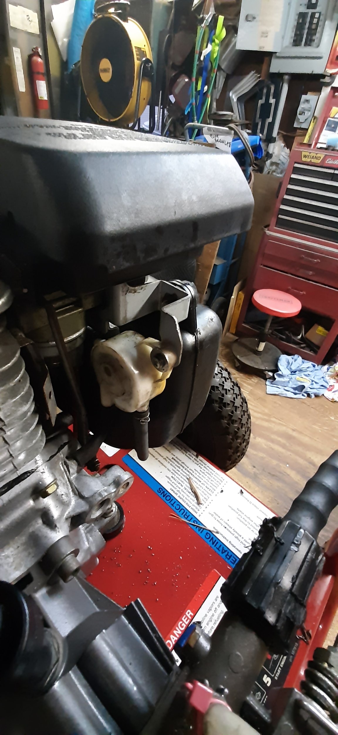

Funnily enough, mine (same design, but not Generac) would not start today. After checking for spark, and enough oil, I drained and pulled the fuel tank to get to the carburetor, opened up the carburetor drain screw, and shot some acetone (brake cleaner) up into the carburetor, and let it drain, a couple of times. The last squirt I left in the carburetor and tried starting the engine. It ran on acetone, so I drained the acetone, reinstalled the fuel tank, added back the gas that I had drained out, and changed the oil because I might as well since I am into the machine anyway. 20oz per the manual 10W30.
FWIW: The carburetor drain screw is on the other side from the fuel pump, and you don't have to pull the fuel tank to get to it.
Runs great now! My note to self is don't leave gasoline in the carburetor too long.

So last weekend removed the fuel pump and tried to bypass it, would not start, duh.....blew it out good, another drain and flush, and engine starts and runs flawlessly. Let it run several minutes with no water in the pump, didn't care about the pump at this point.
So spending just a little time on the pump, full of oil, looks okay. Had to get cutoff wheel to remove plastic hand sleeve at pump hose connector, seems the aluminum and brass have married to each other over time. A little heat and got it removed. Pulled the unloader valve and top valve body to find it full of corrosion, feels like salt inside. Cleaned and lubed with marine grease and had to stop, has sat for a week. Will test the pump once more and go from there.

Great news on the fuel pump! Congratulations.
That crud looks like either hard water or aluminum corrosion salts from water bypassing the unloader valve. If the unloader cylinder walls aren't too scored, I would clean the walls out, clean the unloader assembly, replace the o-rings, and you should be back in business. I would measure the thread length, or spring compression length or both before disassembly, otherwise you will need to be adjusting it with a high pressure gauge.

Well that's a wrap. Maybe 6 hour total labor and zero expense required. Works like a new one. Did buy the $30 pressure gauge to set to pressure. Rated at 2400 psi, can only get 2000 psi with trigger pulled, set relief pressure at 2400 psi.
Other than usual gas issues with the engine and carb, cleaning and flushing was all that needed. Did replace the suspect hose from the crankcase to the diaphragm fuel pump.
The pump itself was really cruddy inside from the breakdown of the aluminum and other metals on well water. Had to disassemble twice for cleaning and liberal with marine grease. Changed oil in the pump, there is no drain plug. Will definitely be lubing my pumps now periodically.
Washing one relic with another....
