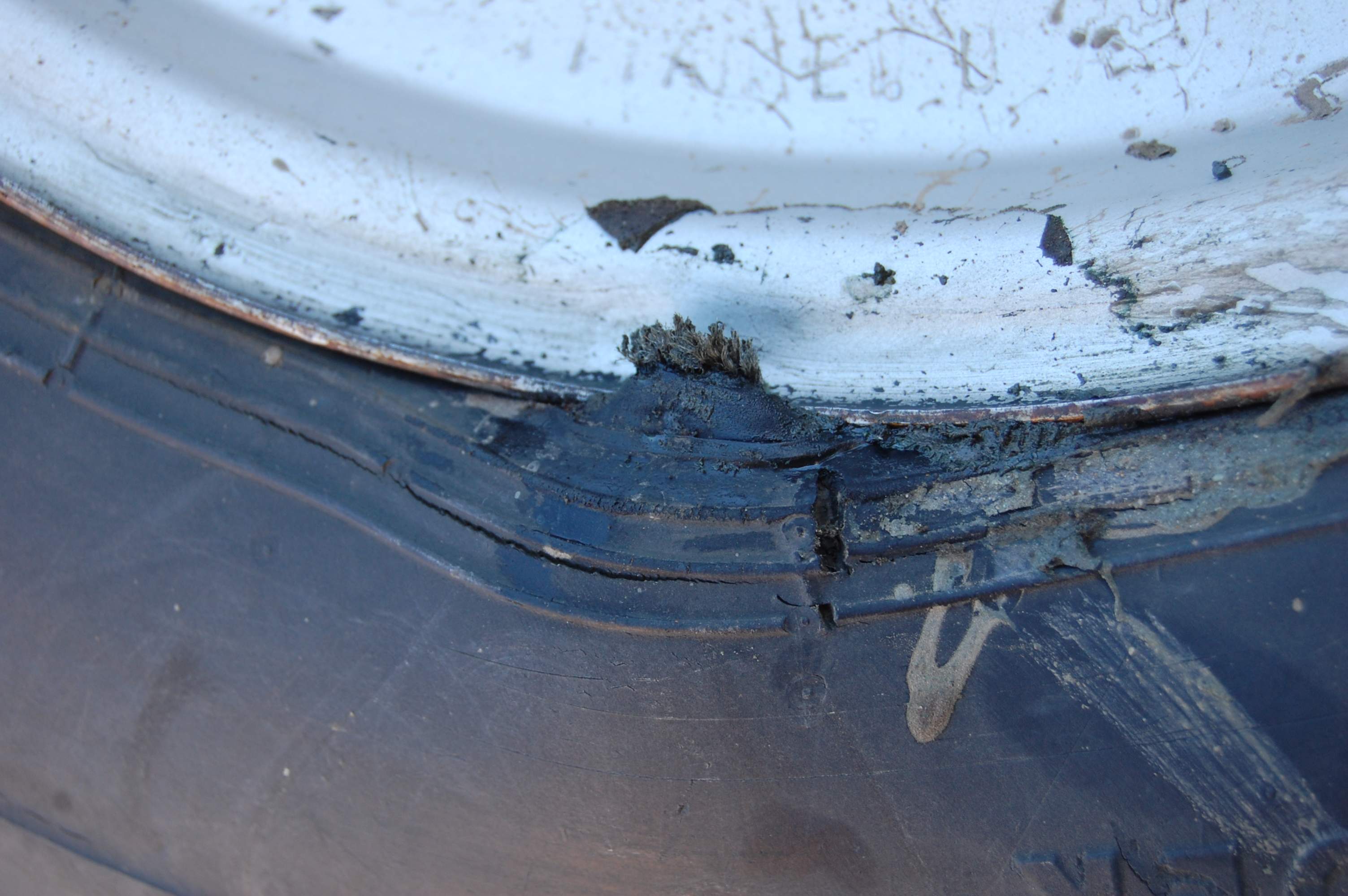

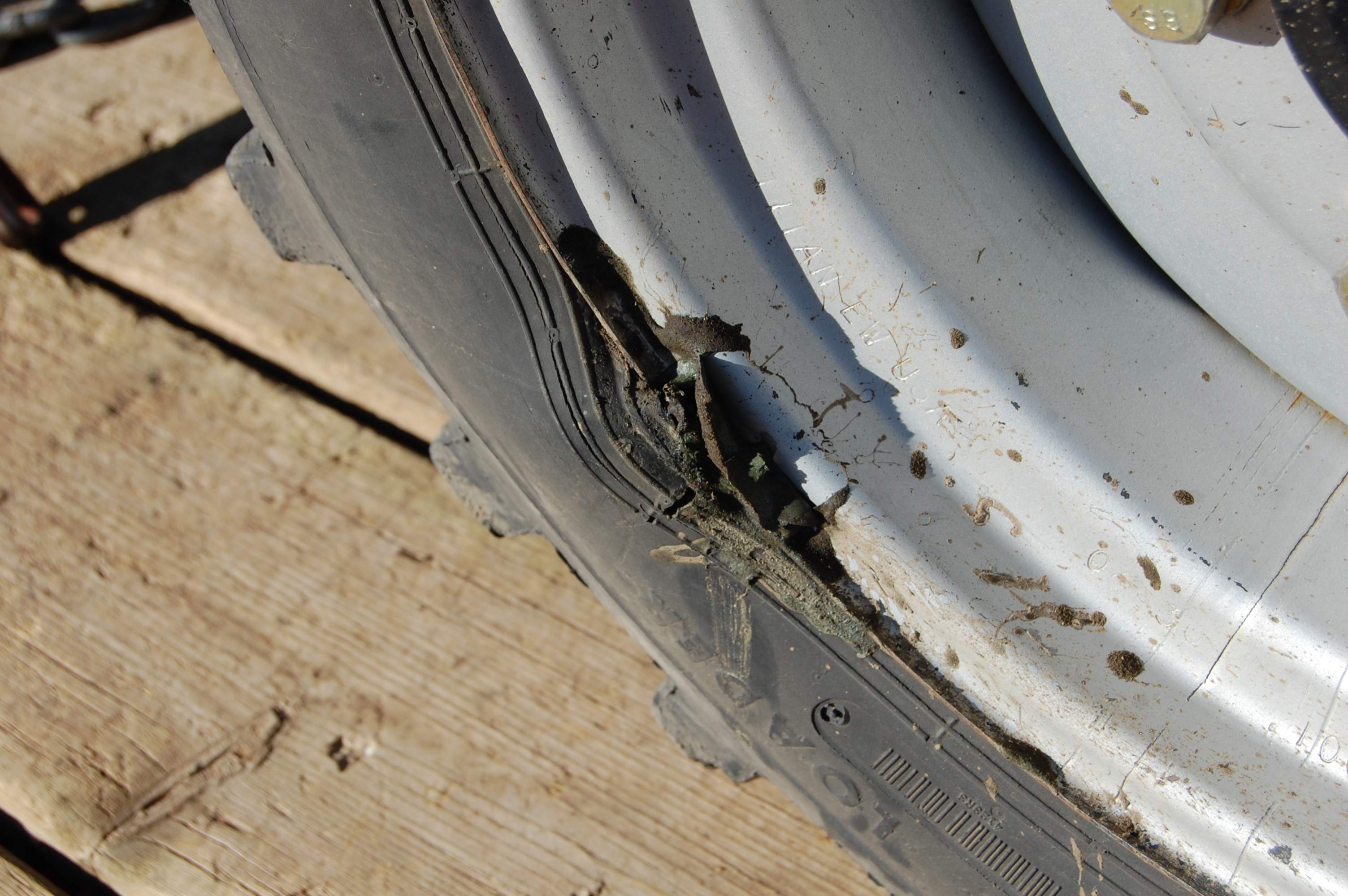

Thought I would pass this on. When I purchased I did not see to many threads with actual performance.
It really saved my butt today. I was doing a job cleaning up a yard today. I had my rear blade on the ground next to my trailer on the side of the road and my box on the tractor. Had I not had ultraseal in there I am sure the tire would have come off the bead and wouldn't of had a way to get my rear blade back on my tractor and get home.
As to why the tire failed like that I am not sure. I did loose all pressure last winter and the tire came off the bead, maybe damaged it. It coming of the bead is why I put ultraseal in.
Of course all the tire shops are closed today and tommorow for the holiday. Has anybody purchased front R-4 for their tractors? I am guessing about $150 per tire?

My eyes could be deceiving me but it looks like the rim itself is actually torn! If so you need a rim and a tire!
/ Gempler's Ultraseal Does Work! #3
yup!
it actually looks like old damage to the lip of the rim and it rusted and failed?

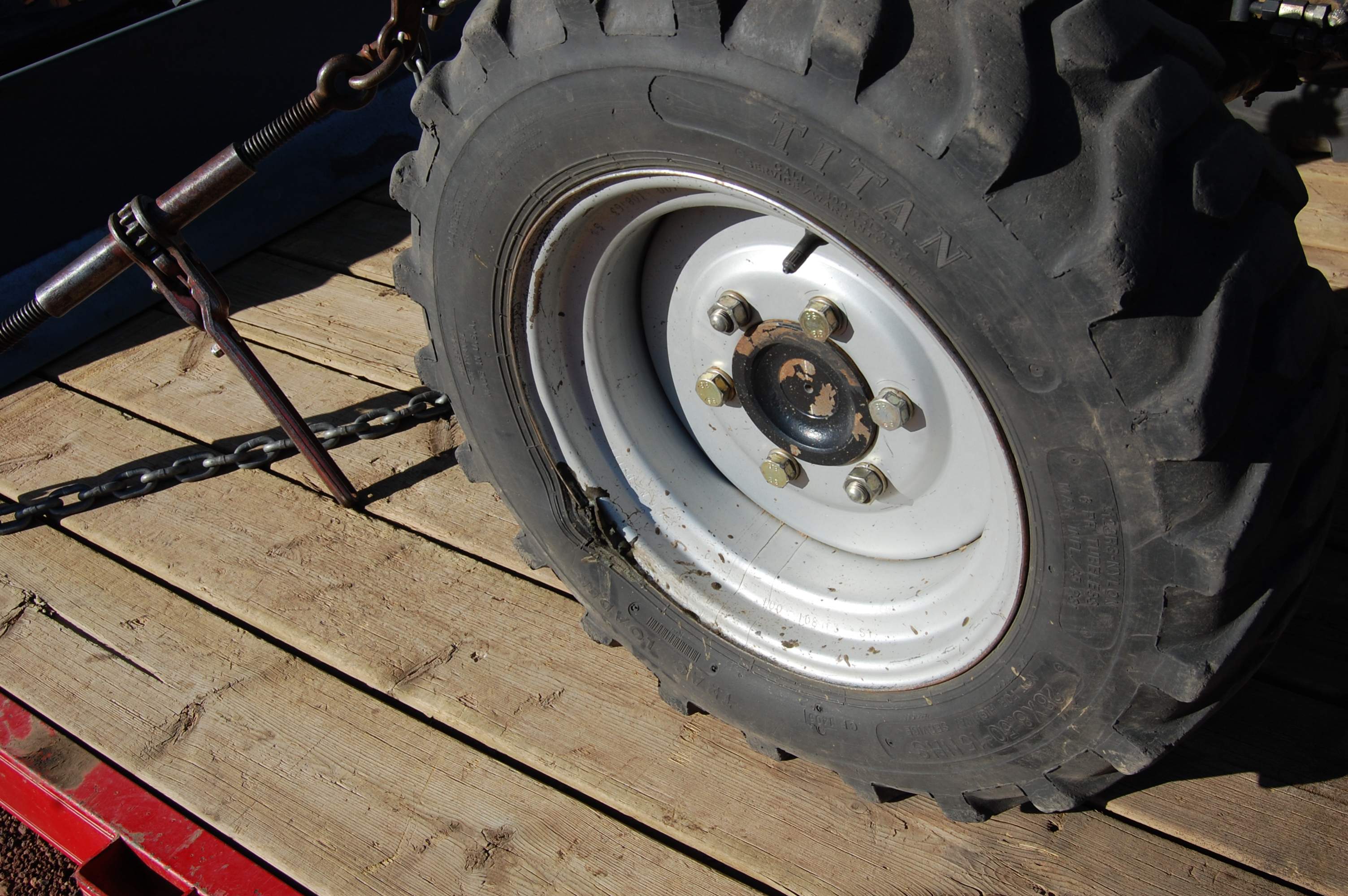

I will know for sure when I get the tire off but I cleaned it up and I think the bead of the tire just failed because of me letting it get low enough to come off the rim. Here is a little better picture. Either way just wanted everybody to see what the performance of Ultraseal.

I got the new tires today and the old ones off. The bead was ripped for sure. I am almost positive that it happened this winter when the tire came off the bead. It was cold and dark when I put it back on and didnt notice:ashamed:
