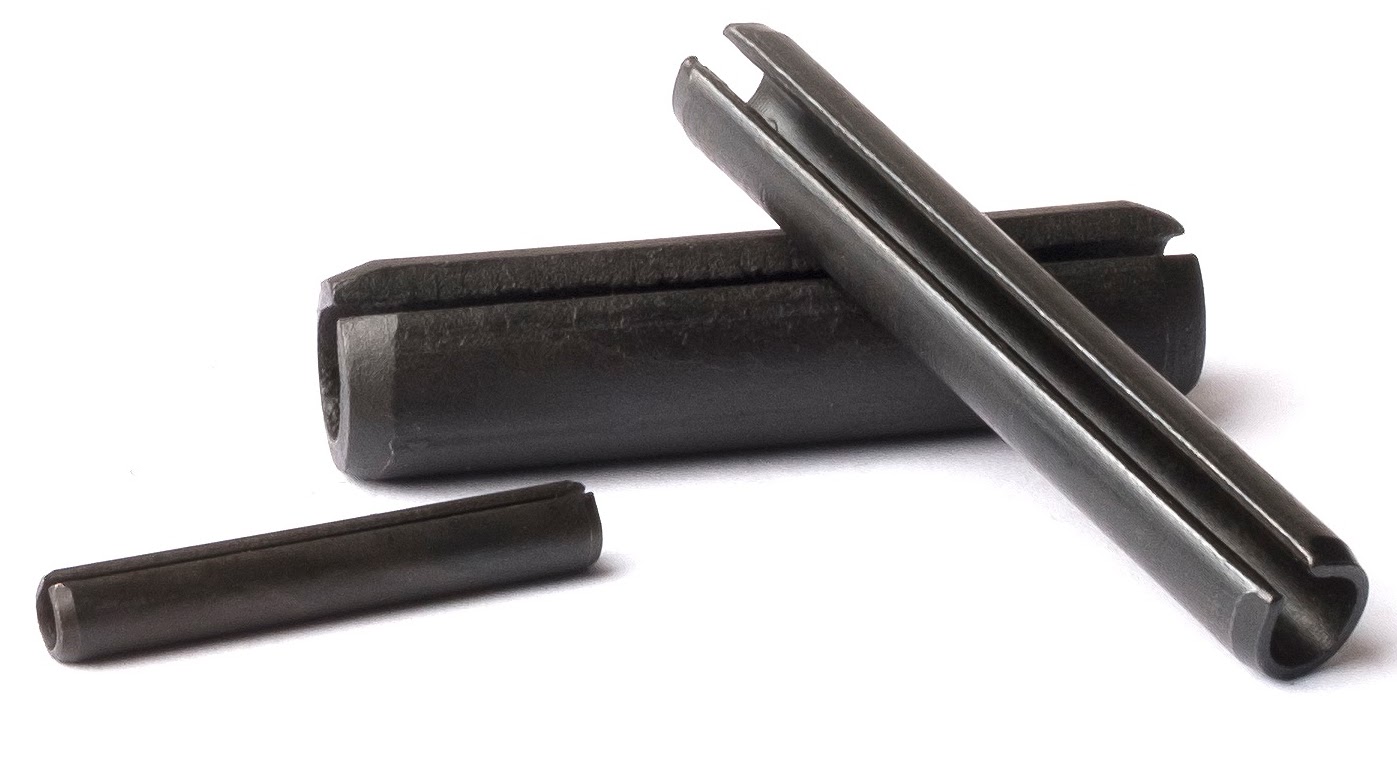

Thanks all for the info, I may be being think but are people referring to the bit that appears to be sticking out on the circular mechanism?
If so I am not so sure because it has welding all round the base as if it is meant to be like that. Also if the pin had come out would I not have issues with all the ranges?

The pin is what "connects" arm with shaft for gear selection....
Just tap pin back in and see if it fixes problem.... Besure when doing it pin is aligned with hole in shaft .... Report back....

Roll pin:
The black pin that is pointed towards the camera in the middle-left side of your picture. The pin looks like it goes through a hole that is in the bottom of the shifting lever arm, where the arm slides over the horizontal shaft.
   / Gear Range Selector Issues #14
The pin has paint on the first 1/2 inch and the rest of the pin has no paint, drive it back in until you see only paint, that is were the pin needs be.

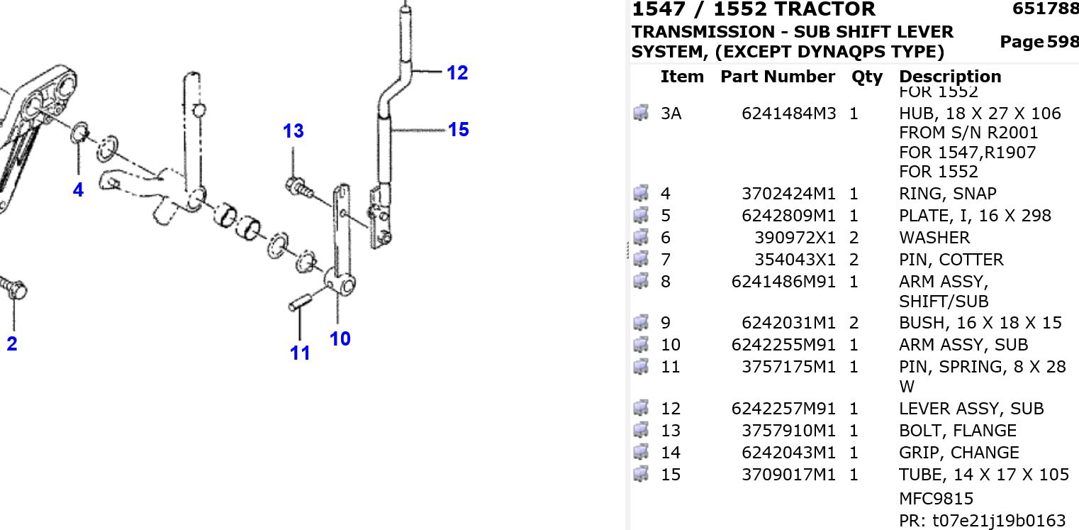

Hi Kevin,
This may not be an exact diagram of your situation but maybe it will help what I'll describe below.
The "roll pin" item #11 in the diagram is what I believe you said you used a long punch on to drive back into the arm assembly (item #10) in the diagram. In the center of item 10 there should be a solid shaft with a hole in it that the roll pin would go through and come out the other side of the arm assembly. When this solid shaft rotates, it is changing your speed ranges. If the holes in the arm assembly and the shaft in its center were aligned when you drove the roll pin it should have not taken "too much force" Another possibility is the roll pin has sheared off in the solid shaft, but that seems unlikely in that you are able to shift into 2 of your 3 ranges.
My approach would be to try and pull the roll pin out and confirm it is still the proper length and that you can make sure the hole in the solid shaft is aligned with the hole in the arm assembly. Is there anyway you can feel the opposite side of the arm assembly to confirm the roll pin is sticking out, meaning it has gone straight through the arm assembly and the solid shaft in its center and come out the other side?
