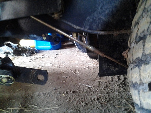

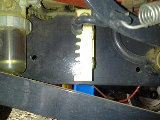

I'm enclosing pictures of the park brake assembly.
The first is the adjuster. It's on the left side of the tractor in front of the rear tire. there is a nut on each side of the adjuster. you can see how many exposed threads I have on mine. That's a lot of adjustment room left in the brakes. If you look at the 2600 and there are no threads left, you can be relatively sure that the brakes are worn completely out. Requiring disassembly of the tranny to replace them.
Pic 2 is the park brake disengaged, and pic 3 is the park brake engaged and locked.
I hope these pics help.
Edit: to adjust the brake..........loosen both locking nuts a good bit.........then turn the collar in the direction that pulls the 2 rods together..........when you can lock the park brake, and have it hold on an incline.........retighten the nuts.

I don't believe that this would be a trans problem if that is the only problem he is having. I think that the brake just may need adjusted. Check how hard it is to lock the parking brake, there should be a fair amount of resistance.

if you look there is an adjustment rod on both sides of the tractor
it has only one pedal but its has brakes on both wheels

Well I picked it saturday morning, I had talked with the owner over the week and neg. a rough price due to him wanting cash only. When I picked it up it had 113.5 hours on the clock. He had told me(and sent pictures) that when he first got it he dumped a load of fire wood on the hood so thats the only major issue but its only cosmetic wasnt enough weight to get to the motor. With that being said I called to dealer wanting to fix it but they quoted me $775 for just the hood and the headlight trim is also cracked, i didnt ask for a price on that since $775 was more than I was willing to spend already.
The brakes just needed a few turns and work perfect now - Thanks for the help and pictures!
