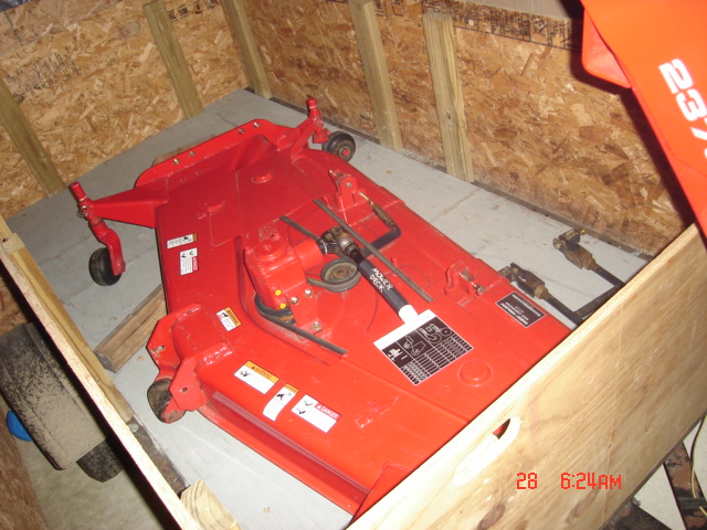

DC3- here's a pic of the MMM removed, with its driveshaft still attached. That's the way I keep it during the summer, but for winter storage (on edge, with some wheels), I remove the driveshaft/U-joint and store it elsewhere. (That's where the "Mower Deck" comes in....)
Oh, yeah-- you can see the quick-release ring at the end of the driveshaft on the right; that's what Wacky was talking about.
Where did you get the wheels to store it on edge? Are they the ones that attach to the deck?
