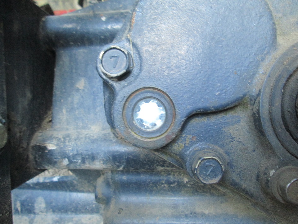

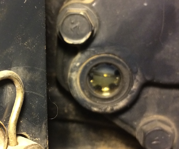

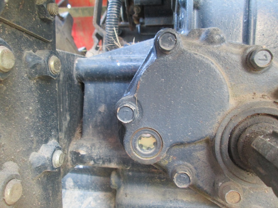

Just to give you an idea of different levels in the sight glass. I repaired some o-rings in my FEL valve block due to a leak. Haven't added oil to top it off (going to do that next service). My level is not visible. I know from experience on my GC2300 that less than a 1/2 liter will bring it back into view. The second picture is the sight glass with the engine running. Play with the tractor a little bit. Make sure all the air is out of the lines.Put some weight in the bucket. Raise and lower your 3pt. There is probably a valve for the mid mount mower that has been closed to stop flow.Operate it, then you can close the valve again after raising it (so it doesn't interfere with the backhoe). You should make sure that it does work. It may lower VERY slowly with no weight on it.
Extend the FEL cylinders, retract them, see if it makes a difference in the sight glass.
When I first changed my hydro oil, it was very clear, needed full sun to see it. Now it is ready for another change and has oxidized to a yellowish tint.

Just a wrap up post on this... Along with all the helpful perspective from this forum, I asked my small-engine mechanic about the hydro-fluid quantity/resolution and he was decisive: 12-1/2 liters is over full.
I was apprehensive about having fluid everywhere by draining from the main drain with a small container, but I cut the side from an empty (cleaned) gallon antifreeze jug and used the jugs' center line to indicate about 2 liters. Didn't figure that by using the breather cap as a 'vacumn' limiter you can very slowly drain just the right amount. I had set that amount as 2-1/2 liters, which I would then begin to add back to get to the right place.
The draining went silky smooth by using the breather cap and I stopped when it looked like 2-1/2 liters in the jug. And in spite of my concern, I was able to put the plug back in with almost no mess and even though I was not watching the glass - as I was focused on the drain plug - when I checked the sight glass...
Looks like 10 liters is the right amount.
