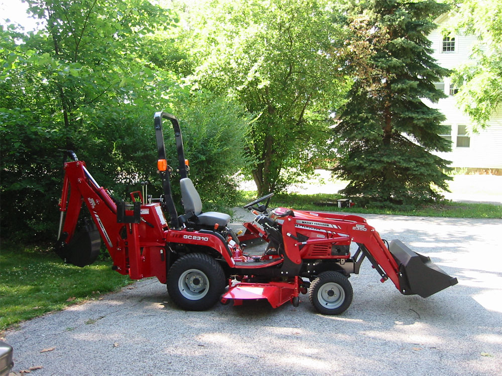

Well here is a picture of the new rig. I will get better ones soon. I haven't had anytime to use it yet. I am hoping to get some seat time soon.
I do have one question and I am sure it is a dumb one. I don't know how to raise or lower the deck. Is there a lock feature on the mower so that you can raise and lower the 3 point that I am just not seeing? The mower engages fine just can't lower it. My manual doesn't cover the mower and they seem to have not given me a manual on the deck (if there even is one).
Thanks in advance.
-Mac

On the left side on the floor is a height adjustment knob for the mower deck. If it is backed up to full height the deck will not go down. you can turn it to adjust your mowing height. If it is turned down, the mower is raised and lowered with the 3PH lever (grey) on the right fender. At least that is the way my '04 2300 is set up.
