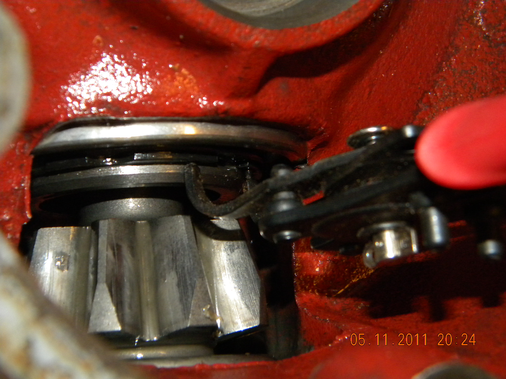

I had no problem getting the front wheel unit apart and getting the new seal in place, but I just spent another hour trying to get the spring clip back on inside that unit. It's the one that holds the top and bottom parts together.
What is the trick to getting it back on.
Does one need extra big clip ring pliers for this task? Hate to stretch that clip ring more then neccessary.

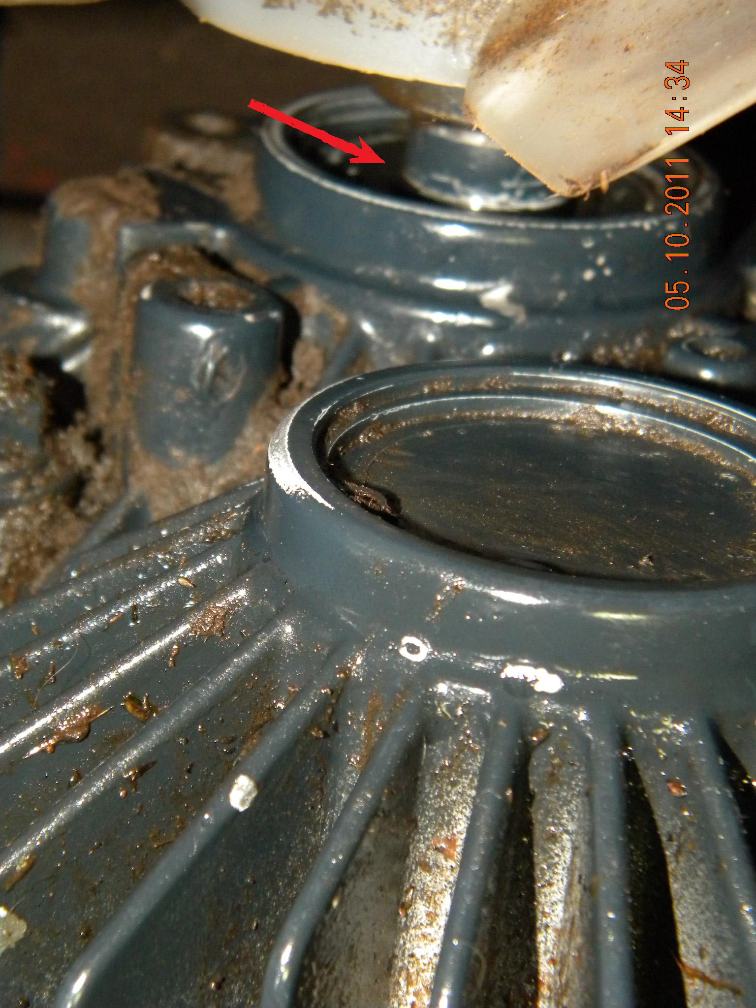

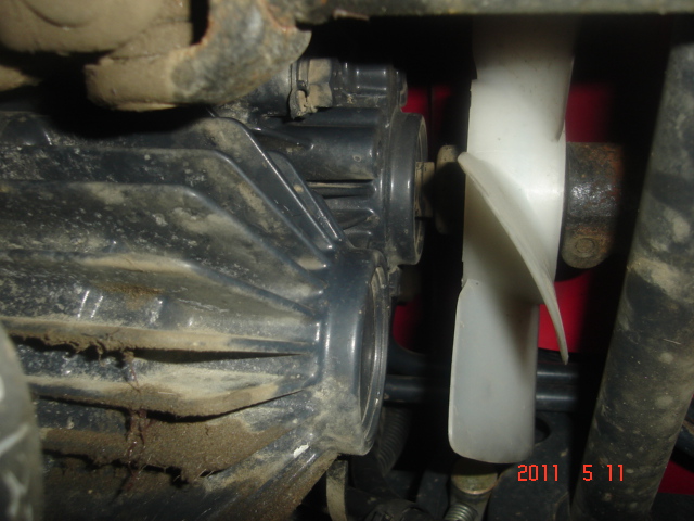

What Mac is talking about is replacing the seal on the main output shaft on a 2310, located just behind the plastic cooling fan. He had quite a leak there at the seal. A spring clip (snap ring) seems to hold it in place.
A new member from Nova Scotia, he's having trouble downloading pics; I'll post his here, along with one of mine, which looks like the identical set-up.
Mac- in your second pic, it looks like the inside of the HST assembly; did you end up taking it off and opening it up, or were you able to get at it from the outside? Or, is the "wheel unit" another seal entirely? I'm confused.
Anyone else ever have this problem?

/ GC2310 front axle spring clip
The picture there (one with red part and spring clip pliers) is the spring clip in the steering hub. I am trying to get back together.
Not the hst unit. That's another job waiting for me after I change the front axel seals.
Sorry for the confusion.
I posted about the leaking seal at the hst unit, ( drive shaft) and waiting to see if some one all ready changed that one, and if so, did they without taking the rear end out of the tractor. I'm thinking the drive shaft can be disconnected , the fan removed and the seal slid off the shaft.
But then again I got two clues, one is lost and the other is gone looking for it.
All advise and help with both issues greatly appreciated.
/ GC2310 front axle spring clip #4
Hey Mac I belive it's snap ring number 21 that your reffering to ,If I'am right its a real bear to get it back on unless you have a good snap ring compressor/expander with interchangeable tips.I did mine and without the tool its pretty hard.Larry
Well Lary
I'm not sure which number it is hopefully have the service manual within days.
How-ever that is the bugger we are talking about.
Got a picture of the parts lay out from Walt. I was wondering if perhaps I cold take that inner shaft out and the gear out , then try the spring clip pliers on it, then put the shaft back in through he fill plug.
My small spring clip pliers don't work cause the back of the ring bends up and and they won't spread the thing apart enough, and I can't get in back of that gear to hold it down. Plus I made all kinds of faces trying to do it, to no avail.:laughing:
Some one said there is a bigger pair of spring clip pliers I can purchase so I'll
check that out also.
Once these seals are changed I'll tackle the one at the drive shaft, behind the propeller.
Three minutes
Yep! That all the time it took for me to get out of the vehicle , walk into the garage, put the spring clip on, laugh out loud, leave the garage.
Yes! I feel foolish. But I'm a happy foolish guy.:laughing:
# on the "Snap On" spring clip pliers for this job is SRPC 7090.
They were just a little bigger then the pliers I had.
