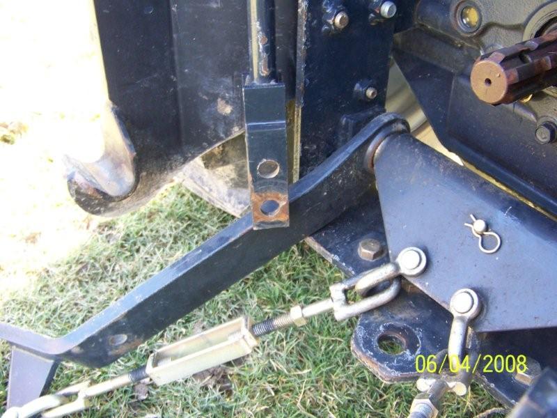

My dealer just delivered my new rear grader blade, in the middle of my driveway. So I must move it, (darn) But when I hooked it up I found that the lift height is an issue. It only raised it about 3 1/2 inches. I think this is a real problem. I looked on Massey's web sight and they recommend this Rb for a gc2310. I cant believe that they didn't considered this. I did try to adjust the top link to get more height, but then the angle is really off. I measured the height of the lower pins when the blade is level and they are 19". I measured the lift arms when all the way up and they were at 21" high. I'm going to call the dealer tomorrow to see what he has to say, but any ideas would be greatly appreciated.
/ GC2310 attachment advice #11
I stopped at the dealers today, because of the lift height on the rear grader blade they sold me. It is a new model and they haven't sold that many. They also said they haven't had any problems in the past. So we tried to figure out why it will not raise very high. We didn't find out why, but found a fix, and thats why I wanted to post the outcome. After looking at the new units sitting on the lot, not the new gc24?? or gc26?? but gc2310 there were no changes. The owner looked at the part list for the new gc models and they showed that the fixed side lift linkage has two holes in it for different lifting heights. the adjustable one did not have the second hole. So I came home and put a hole in it, and just adjusted the other one to level the blade. Now I have about 13" clearance. I am max out on lift now, because I only have about 1/4 clearance in between the frame for the backhoe and the lift arms. If anyone wants pictures let me know.

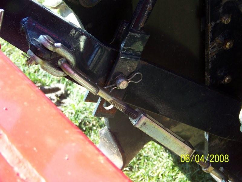

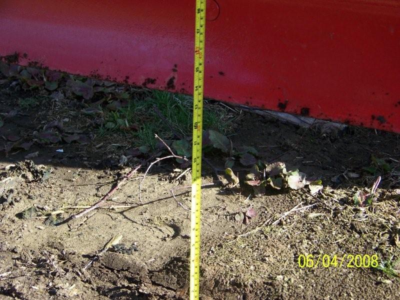

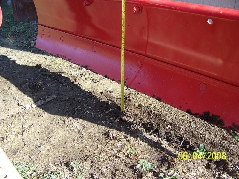

Here are some pics of the modification done to the lift arm
1. rear blade set up normal its about 5" high
2. Is the pin in the bottom that was factory drilled
3. Is about 13 1/2" high using the hole I put in.
4. This is the hole I put in.
5. Just the two holes
6. The hooks I welded on.
The other lift rod I didnt due anything to it except for adjusted to keep the blade level
