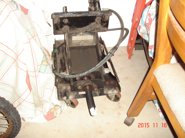

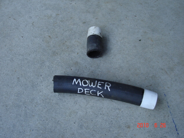

I don't use the rear PTO much, so I keep its cover on; for the mid-PTO shaft (and other splined shafts), when that's exposed, I slip a piece of 1" heater hose over it. Used super glue to stick a plastic cap on the end of the hose to plug the end. Also use pieces of 1" hose over shafts when stuff is in storage.

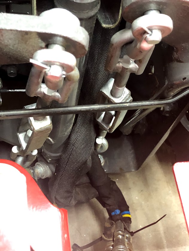

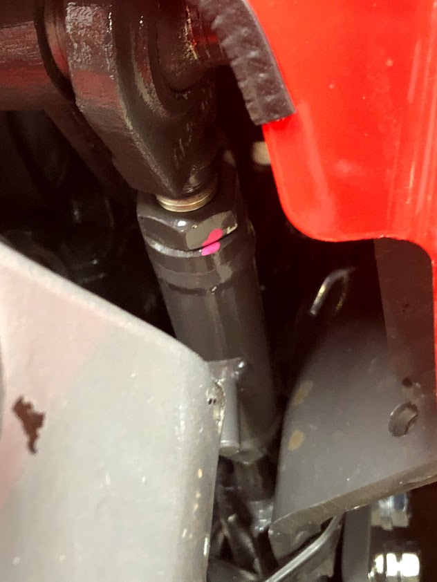

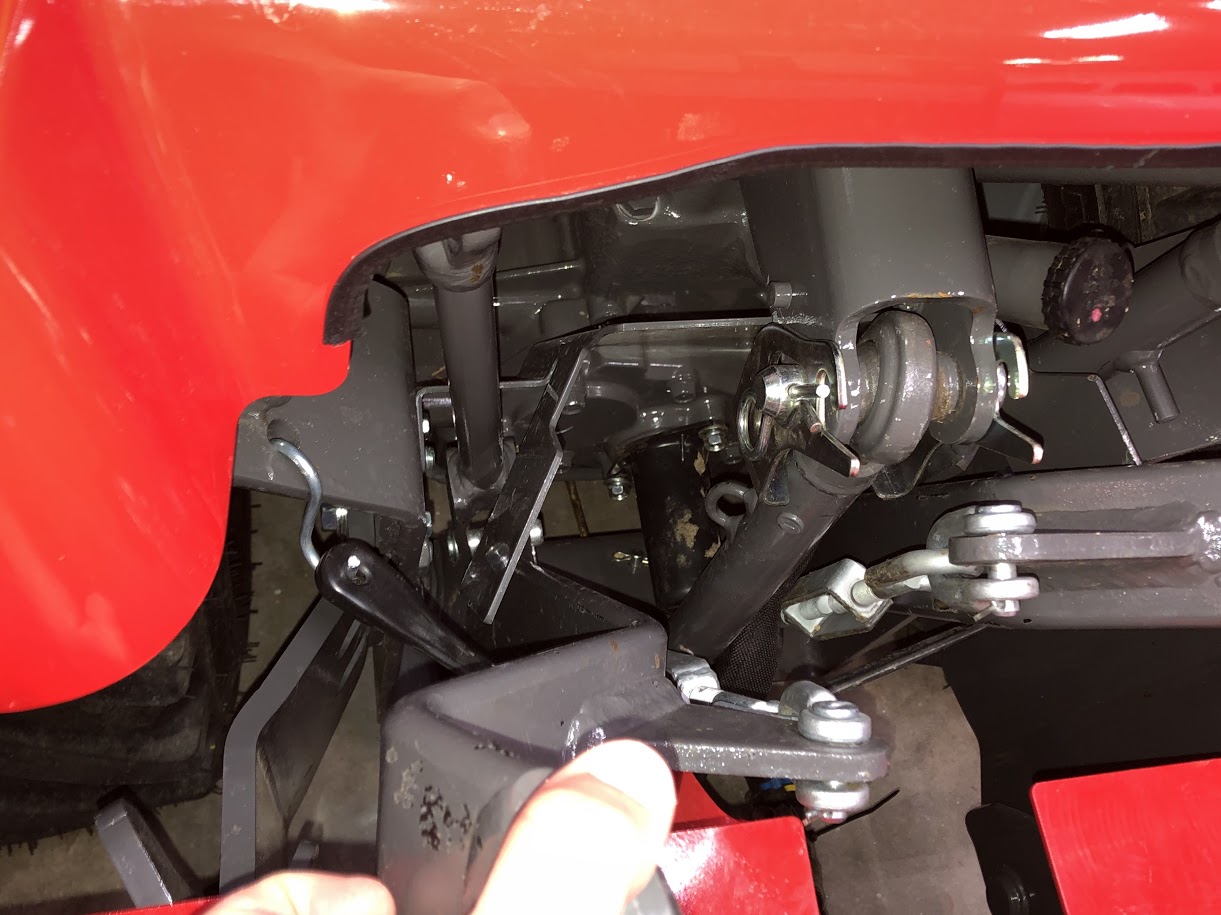

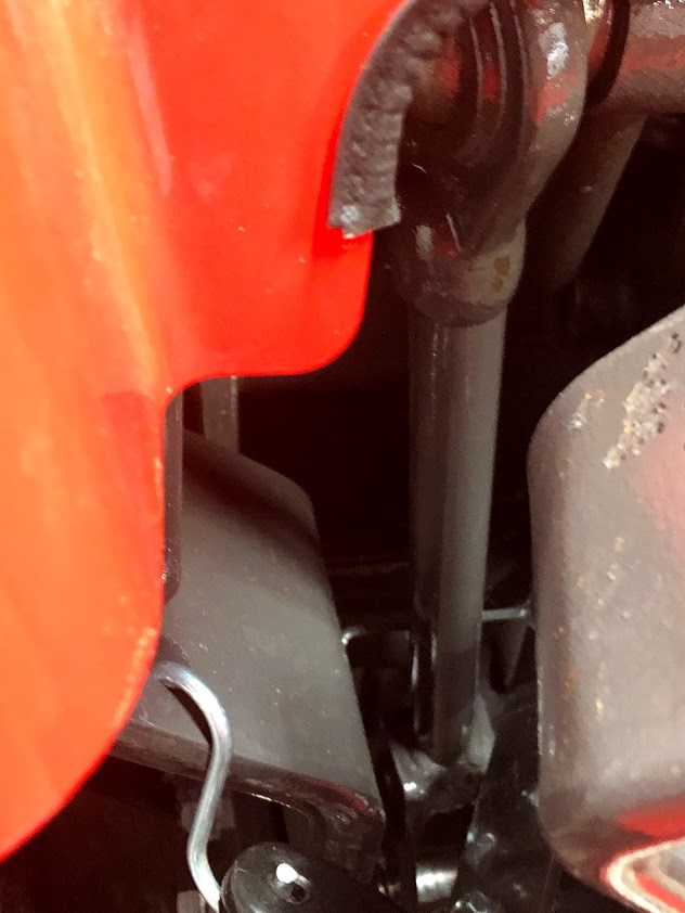

Been lurking awhile, first time poster. I have enjoyed reading the info on this forum. Recently I bought the MF GC1723EB. Wasn't sure this would help but these are pics on the 3PH while the backhoe is on. Hard to get clear pics but hoping it may help.

It does help Josh, thanks! Interesting how on your's, the lower lift arms are so closer together when stowed up, so that the top of them fit within the raised portion of the fender. I take it that's because you don't have the pto shaft guard on?
That's the issue I was having with having the pto guard on, pivoted up. Unless I'm doing something wrong, the guard forces the arms to be stowed farther apart from each other, so that the tops of them don't fit into that raised portion of the fender like on yours. They're way farther apart, resting against the fender.

Tried to get a better, brighter picture just now. All the guards, etc are how it came from the dealer. I haven't taken any guards off myself.
