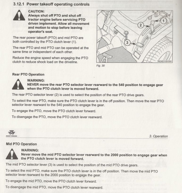

Move the PTO clutch lever (left of your photo) all the way back (up in the photo) to the stopped position.
To engage a PTO first move the rear and/or mid PTO levers (right of your photo) back (up) to engage
Then move the clutch lever forward (down).
   / GC1725 idle speed #12
In this older thread there is an image of the same page in an older book for an older model where they have the levers labeled correctly GC 1710 PTO Operation
   / GC1725 idle speed #14
Ths is how my GC 7115 reads....
View attachment 820124i
Ya, in the book for the 1723/25 they updated the image in the figure and pointed 1 & 2 at the wrong levers. Good thing I was not depending on the book to tell me how to operate. For someone that was following the instructions as they went I can see where you might move the clutch first and then engage second, because in the new book that's exactly what it tells you to do based on the figure.
   / GC1725 idle speed #18
If you engage the clutch first, then the PTO gear, you'll hear a looot of grinding before stuff starts moving. Needless to say, it's a lot of destruction happening inside.
