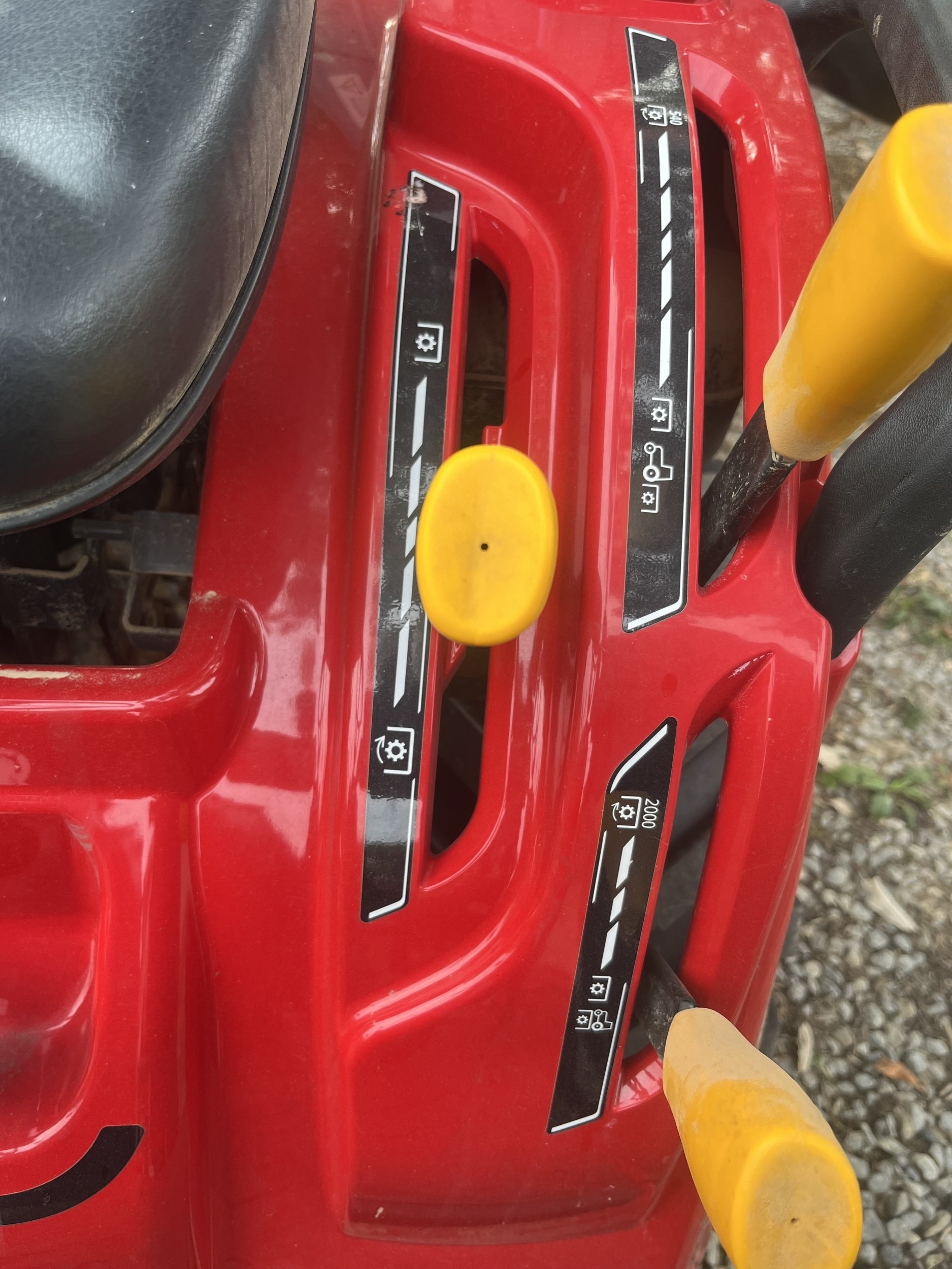

All of the levers should be marked
1 = Rear PTO (Not Clutch) Should be marked 540
2 = PTO Clutch Lever
3 = Mid PTO Should be Marked 2000
You should move 1 or 3 to engage first and move the clutch lever 2.

   / GC1725 idle speed
My levers and decals:
