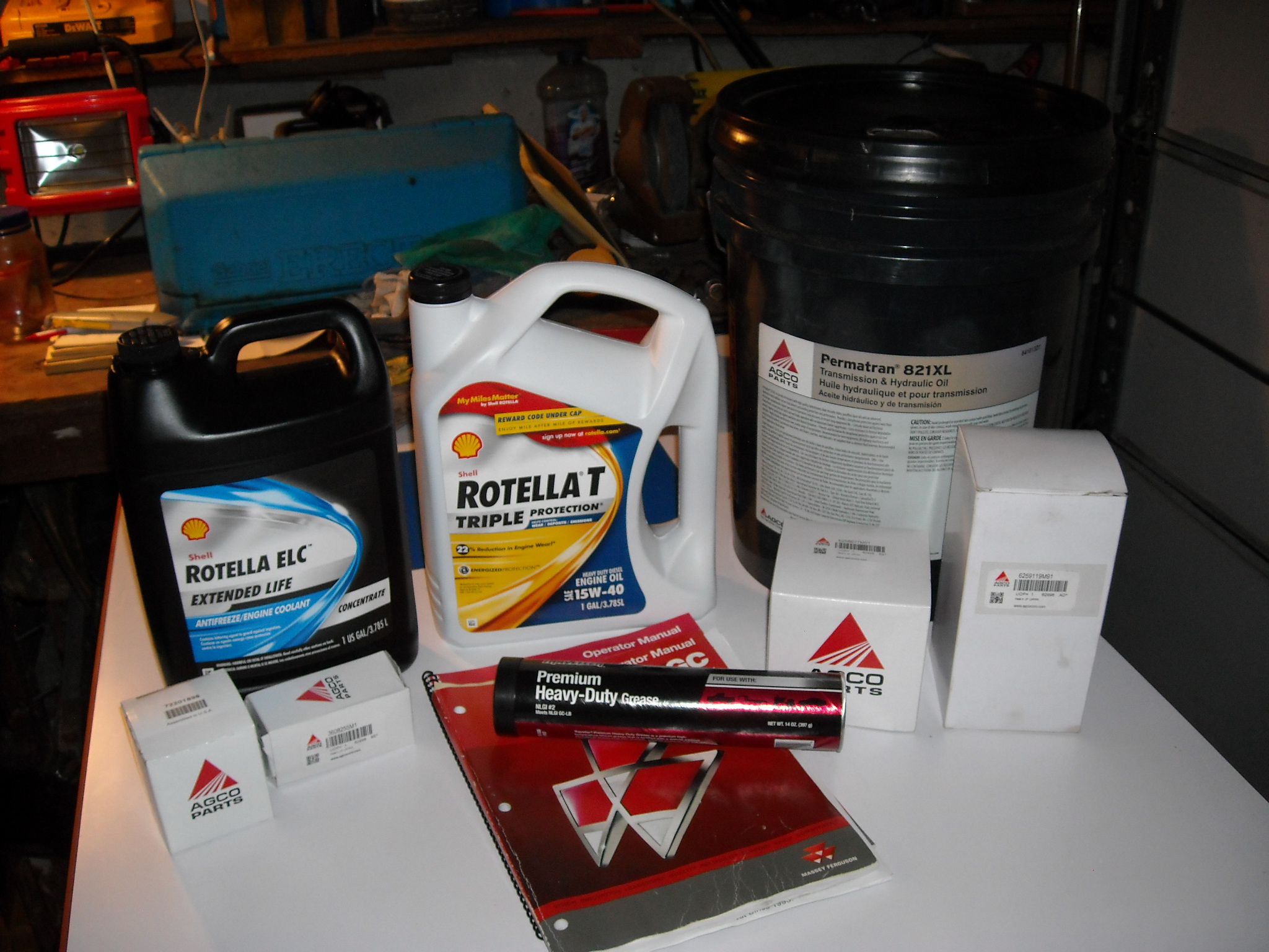

I'm planning on doing my 250 hr service this weekend.
I purchased the fluids and filters over the past few months.
I expect this to take me 6 to 8 hours.
I have...
5 gal. permatran 821xl
1 gal. Rotella T 15w40
1 gal. Rotella ELC
1 Fuel filter
1 Oil filter
1 Hyd Filter
1 Air filter
Should I pick up some O-rings for the Hydro screen?
Any tips on changing the engine coolant?

The o-rings on mine are still holding up and haven't been changed, but I do check them carefully each time. Same for coolant, though I know I should change it one of these days.
So far have changed fluids 3 times: 50 hrs, 250 hrs, and 500 hrs. Now have about 580 on machine. Still on original battery, too, but not sure how much longer that will continue.
Just look over o-rings carefully for nicks, handle screen carefully, don't over-tighten when putting it back in, and you should be OK.

I would change the coolant like any other diesel that changes over to an ELC type coolant. Drain the coolant in both radiator and overflow. Then fill with distilled water and run up to operating temperature. Shut it down and drain out. Keep doing this until the coolant is no longer green. Then look up how many quarts the overall coolant capacity is and divide by 2. Put that much ELC coolant in and fill up the rest with distilled water. Then you know you have at least a 50-50 mix in there...

ELC is extended Life Coolant and is usually red. CAT was the first to develop the stuff, but it's the best stuff for diesels because of the heat diesels can produce. Most Ethanol glycol based coolants have silicates in them that fall out of suspension and clog stuff up after awhile if not maintained, the green coolant. Red (ELC) and the green coolants do not mix. The system needs to be flushed thoroughly with distilled water to get all the green coolant out. Then you fill the system with 1/2 of ELC concentrate and top it off with distilled water to bring the mixture to a 50/50 mix. I only say this because I see he has the Rotella ELC, which is great coolant. I was actually kind of shocked to see green coolant in my machine when I bought it. When I get ready to do the 50 hour service, I am going to switch over to ELC coolant since my other diesel uses it as well.
I have a powerstoke that is hard on coolant because of the oil cooler heat exchanger and EGR. I was changing the Ford Gold coolant every year, but decided to change over to ELC coolant to make it last a little longer. I had to use 32 gallons of distilled water to get that flush done properly.

I think it ended up taking me about 3-4 hours to change the filters and oils.
It did take me some time to detach the fel and backhoe...reconnecting went quick tho.
I did wash the tractor and attachments, changed out some grease zerks. checked the tire pressures, spray painting some scratches etc.
Painted the 4 inch abs tube I use for a chain holder and my chainsaw scabbard too.
I did spend all day fussing over the machine....it looked like it just came out off the lot, at least for a day...then it went back to work.
I never did change over to the ELC coolant....the dealer said they never change the coolant on a service.
