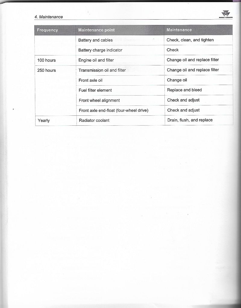

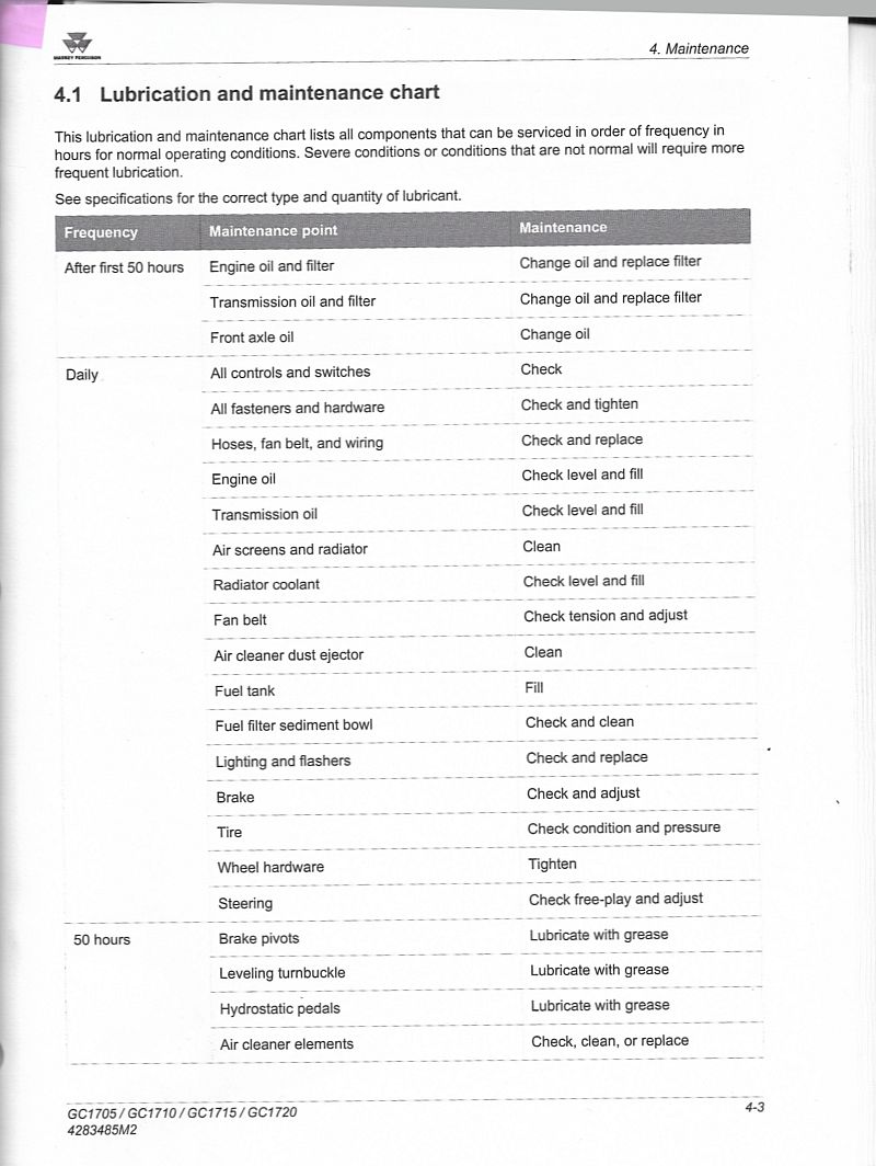

I have a GC 1705 and can't locate my owners' manual.
Can someone remind me the service intervals for oil and hydraulic fluids?
I'm using the Amsoil Synthetic Tractor Hydraulic Transmission Fluid (ATH) and Amsoil Synthetic Heavy Duty 10W-30/SAE30 Diesel Oil (ACD). I'm not sure if that changes the above intervals?

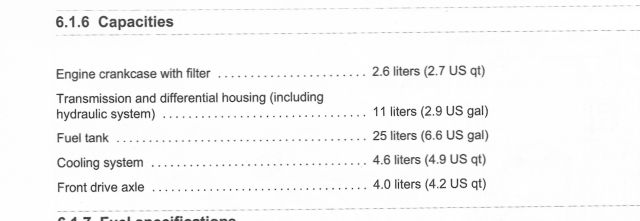

Also, what is the hydraulic fluid capacity?

Will this help?

Thanks guys, appreciate the information.
Dale - that was super awesome, appreciate you taking the time to scan and share those!. Couldn't find my manuals amongst the remodel, so that was very helpful to me.
