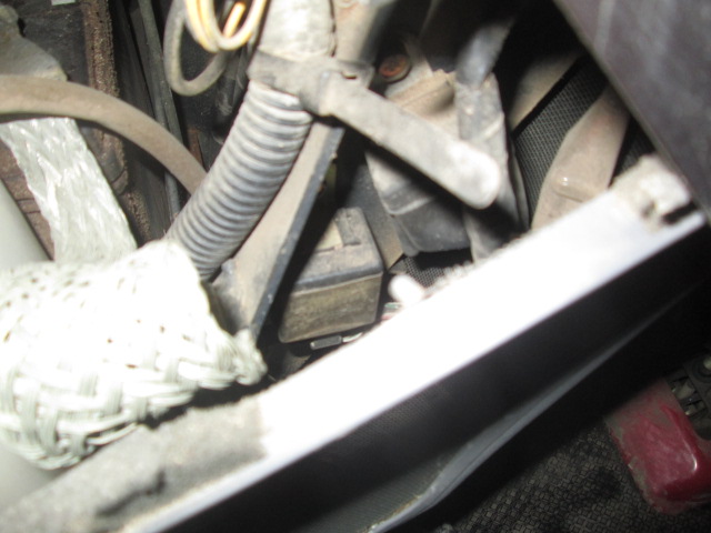

I just went out and tried what you told me to try, I heard both clicks you speak of. I am wondering if I somehow reset that replay during my diagnostic work today? Could be that is what wasn't working. I wish I knew where it was located to make sure the contacts look good.

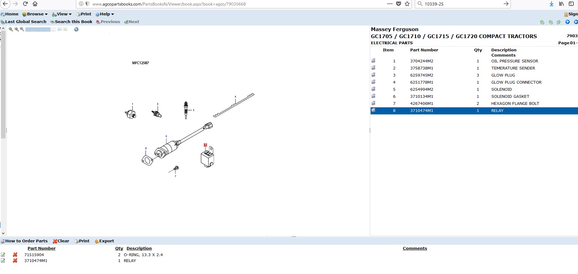

The parts book lists the relay on the same page as the solenoid, but gives no description of its operation. 3710474M1 RELAY.
It is located under the dash on the left side.A black 2"x2" box. I have no idea how to test it, except by removing a battery cable if the tractor doesn't start. The solenoid has to be energized to shut the tractor off. With no power, and if the solenoid is moving freely you would hear the click when it shifts open. I am making an assumption that the relay is a timer for the solenoid, I could very well be wrong.

Engine stop relay (#28 in wiring diagram) seems to be single pole single throw normally open relay (by electrical diagram in manual).. And seems to control the fuel shut off solenoid...Key on, relay should operate causing fuel solenoid to operate...
