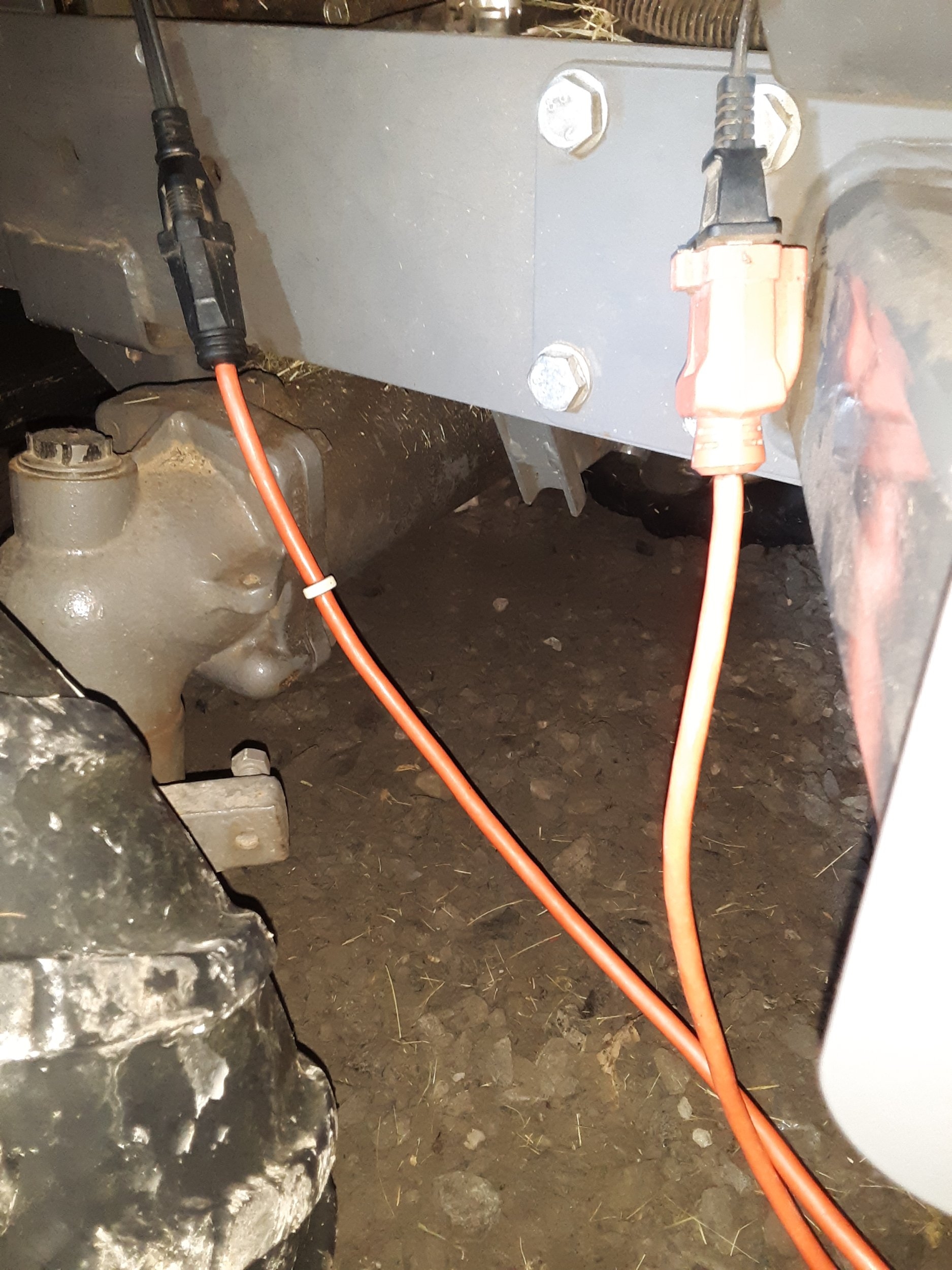

thats one I had saved in my amazon list. been wondering about placement would appreciate pic
It might be hard to tell from the picture. It is on the left front of the transmission. With this placement I was able to fish the cord up through the steering column and have it near the block heater plugin as shown in the second image.
Please ignore the mud, didn't realize I'd gotten that deep in my garden and glad I have the skid plate because I would definitely have hit the filter. There was mud all the way up by the mid PTO.

thanks, was curious how would fit around the sentinel guard think its non issue, would end cord under left rear hood along with my battery tender and block heater

I used zip ties to attach it to existing wiring, fished it up through the steering column and then into the engine compartment. I just had to follow stuff that was already there.

I got 2 14g marine wire runs (each 10A one for front facing leds and one for rear facing leds) going back along the frame that come out near left rear of engine thru grommet should fit fine there.
