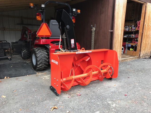

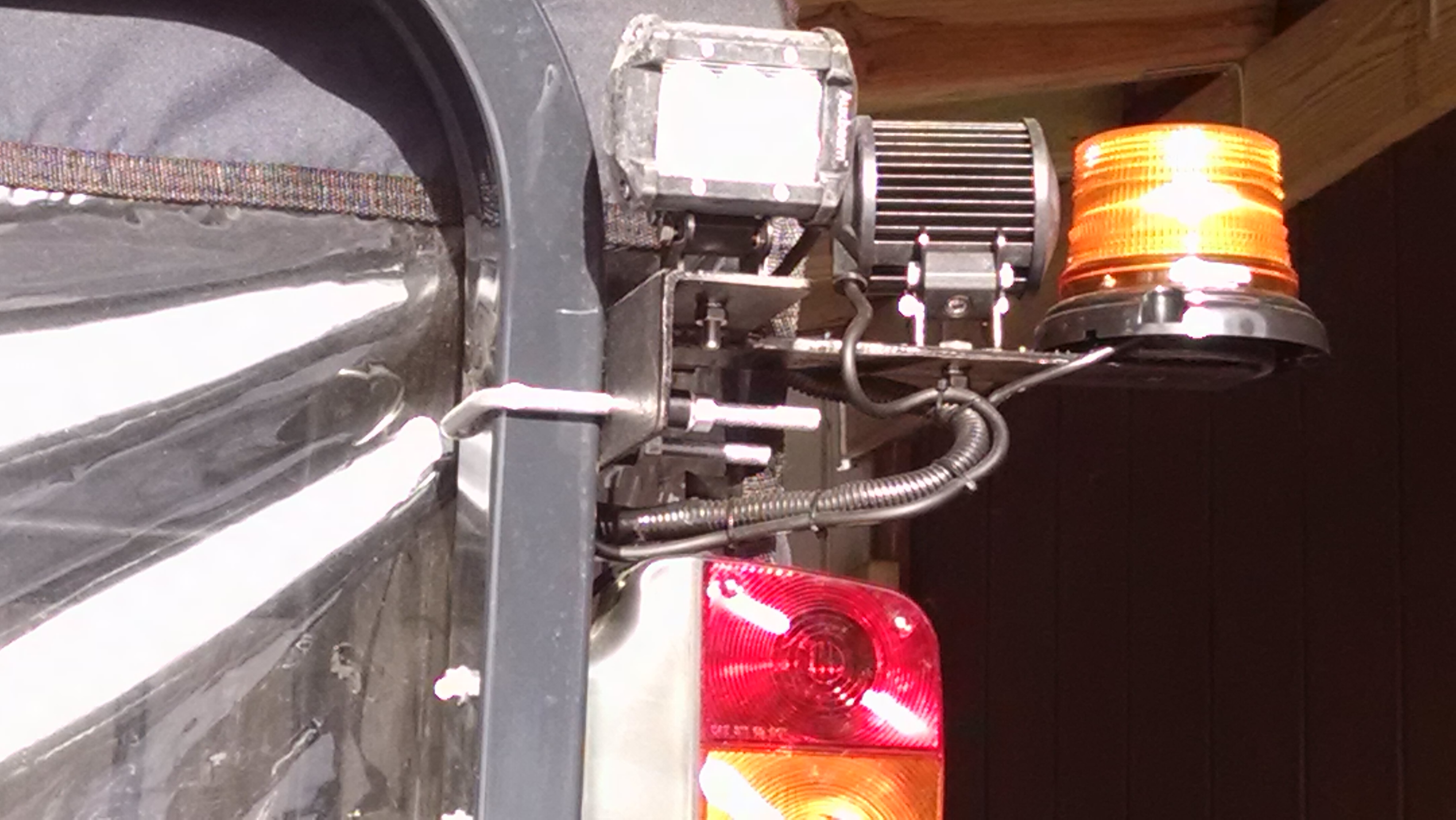

I bought four of these. I used the pigtail in the rear, I made a bracket and mounted a switch on it and on one of the bolts of the ROPS, I snaked them in through the ROPS. I made a bracket for the top on the ROPS and used square U bolts. I made it big enough to mount two strobe magnet lights as well.
lights my yard up like daylight.. I have to shut them off when I'm working near the road if a car comes, it will blind them.

Great, like your setup! Appreciate the link to the lights.
Looks like it won’t be too difficult to install and wire.
Your snowblower looks like a beast!

Thanks, it works good.. Now that I think of it, I tied the LED's into the harness and is controlled by the light switch on the dash, the headlight wires coming out of the "red" tail lights is what I spliced into at the ROPS (so no running wires to a switch), when the headlight switch is on all the lights are on, the strobes are on there own switch. If you need any pictures of switches or anything I can take them for you, otherwise good luck with you're install.

They are 18W a piece, that's nothing.. I figured the same , when I need lights, I need them all.. What would you like pictures of?
I also replaced my flashers/tail lights and headlights with LED bulbs, probably cost me and $20 to do that.

They have there own ground wire.. I believe I tied them together and ran them down the rops to an existing bolt on the chassis for ground but I will look tomorrow to make sure..

Ya, everything is right there at the rops, no switches needed or running wires under the deck or anything and you can save you're extra power point near the top link for something else some day..

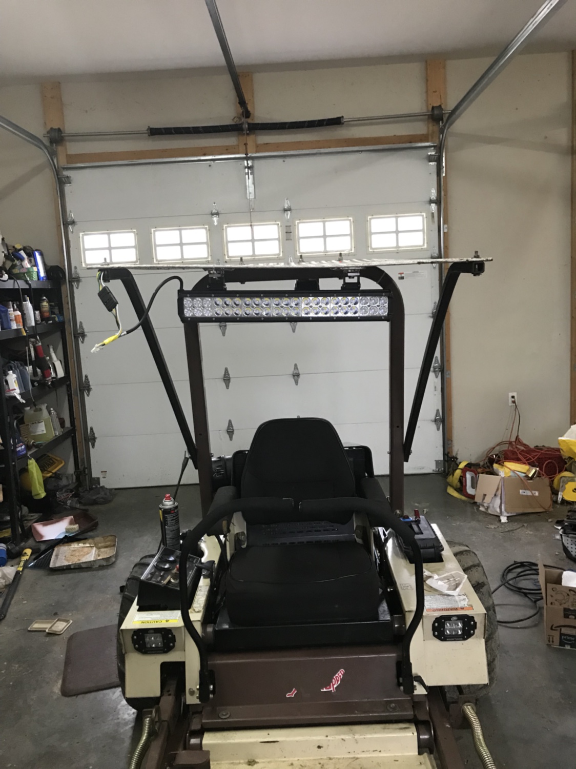

I have a pair of 18 watt lights on the back of my truck. They’re nice backup lights but they’re not enough light from working on the tractor by my taste. I have a 120 watt bar on the tractor. I recently added nearly 200 watts of lights on my Grasshopper. It has a real alternator unlike most lawnmowers so I’m hoping it’ll be able to support that load. IMG_1625.JPG
