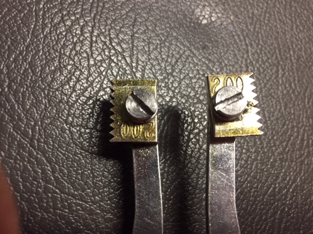

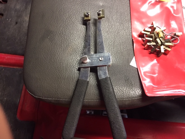

Well it's all fixed. Thanks for all the suggestions, Ray66 idea was the magic one. I had to fab the handle due to lack of space but it did the trick. I will make sure I take the tire off in the future when I remove this filter just to be safe and have a clean path to install it.
Pics of the tool are attached.
Thanks again,
Dale

   / GC 2410 Suction filter threads #17
Thanks again,
Dale
Great! I think I will put that tool on my list to order.
I would leave the screen alone now. Any debris from when they made it is out now. And, there won't be any new debris until things get worn.
The screen will effectively quarantine those things in the bottom of the sump. So, there is no need to worry about it again for a long time.
