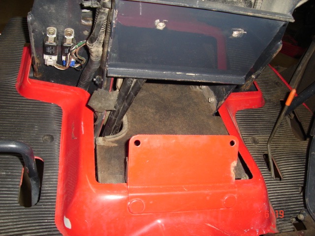

/ GC 2410 belt change help #6
I had forgotten, but again you're right. The TLB supports pretty well cover that up on the underside!

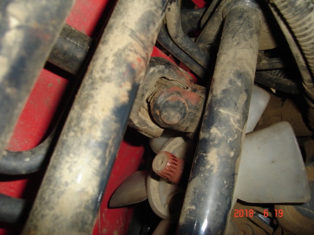

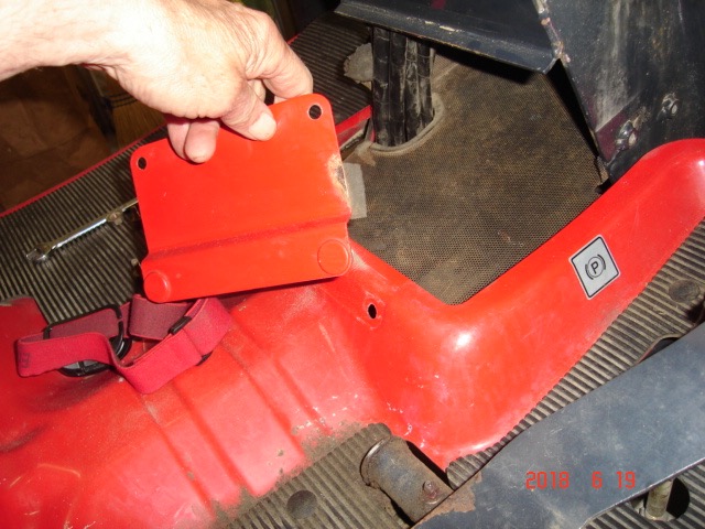

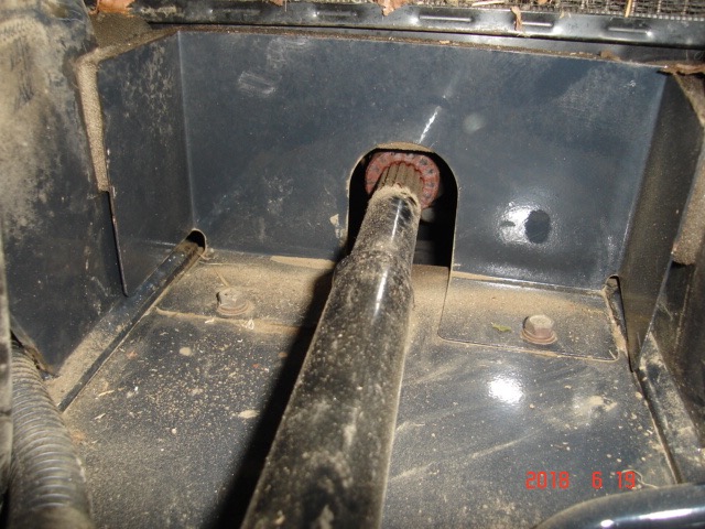

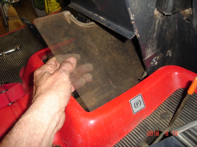

I remembered, however, back in 2018, I discovered I had broken all four engine mounts -- the rubber had come un-bonded. That was quite a project, but I was able to change all 4 of them without having to pull the engine. What I did when I wanted to check the HST driveshaft engagement (the entire engine had shifted), was to access that area from above, beneath the floor in the center area.
Begin by removing the plastic side panels under the hood (maybe front grille, too), then the plastic panel in the middle under the instrument panel. Under that, there are several metal panels --and a screen-- that can be pulled to expose the HST driveshaft, at least on my 2310. I bet the 2410 is similar. My memory's not real clear on the rest, but I was able to access the plastic cooling fan (the one that sometimes gets broken) & HST driveshaft. A right angle socket driver is helpful on some of those bolts. You may also want to clean that whole area out -- mine had a ton of debris in there.
PS-- I disconnected the shaft at the small fan end -- once you pull one locking bolt & nut off at the fan, the splined shaft will slip off (last pic), then you can slip the shaft out of the other end to remove it.
Here are some pics, hope this helps --

Thanks irvingj. That's exactly what I needed to see. I didn't realize the driveshaft came out that way, or that it could be slid out of crank pulley end on the spline shaft.

Keep in mind I didn't remove my driveshaft totally, only disconnected it at the HST fan end... but IIRC the other end just slips out. Sorry my memory's not so good!
Here's another view of the HST cooling fan at the rear end of the HST shaft. Look closely, you can just see the end of the locking bolt there ( oops, no nut, just a bolt). The front end of the shaft slips into the splines. And yes, I did grease that up when I was in there!

Well, today I dove into replacing the belt and lower rad hose. Irvingj you were right, one bolt is removed from the hst end of the driveshaft, the shaft can be slid forward to remove it from trans end, then moved back and off the motor end after moving to one side of hst fan for clearance. I was also able to remove and install belt without removing engine fan. I did remove the radiator for clearance and to assist in accessing the lower hose, but probably didn't need to be.

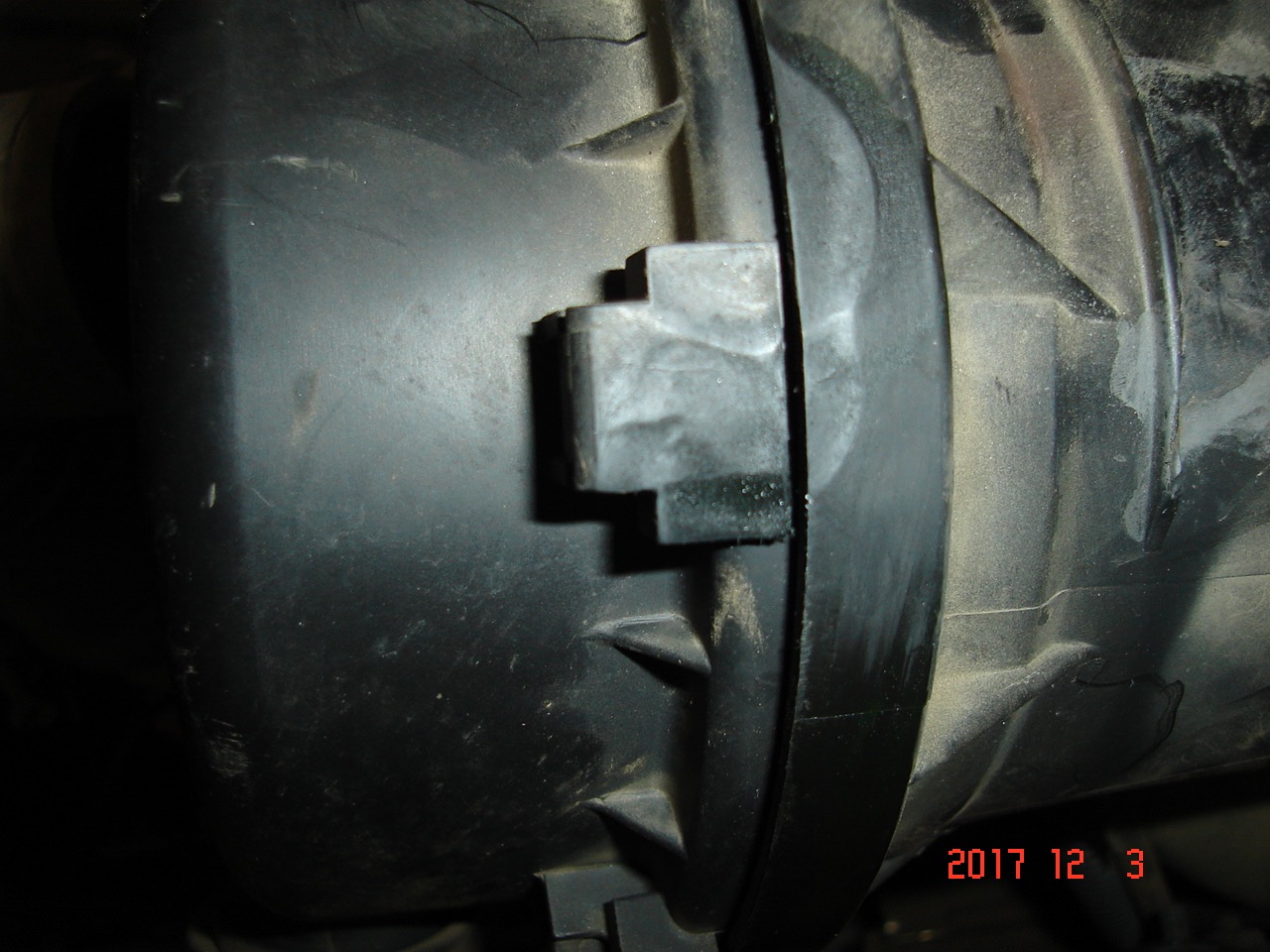

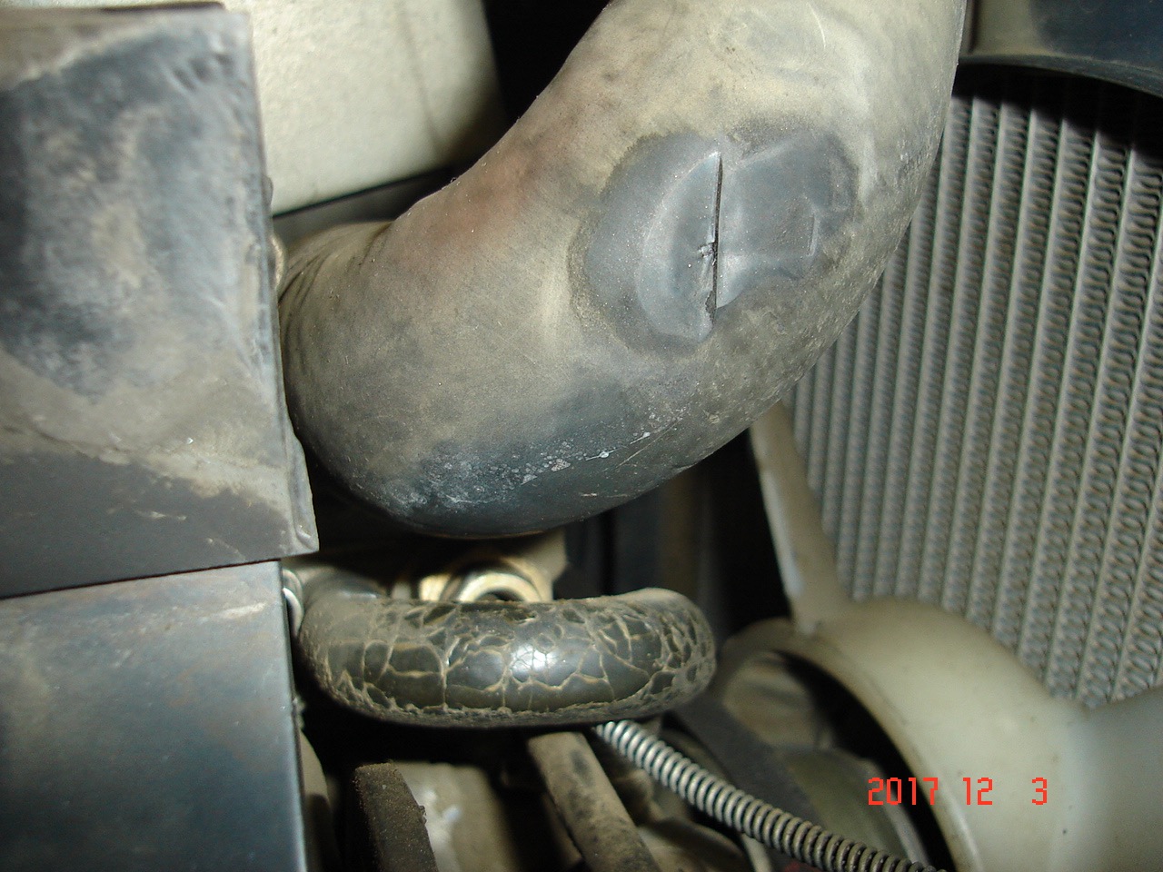

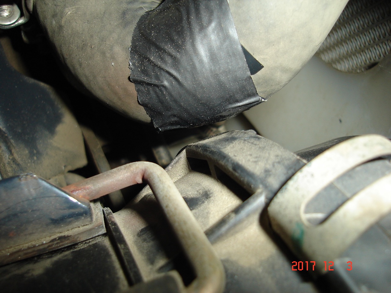

While you're in there, check the rotational position of the air filter housing carefully for housing-to-radiator hose clearance -- I found mine had shifted just enough that it was contacting --and cutting into-- the upper radiator hose. Tried some duct tape as a buffer & re-positioned the filter housing, but eventually it began to leak and I had to replace it, just 3 years ago.

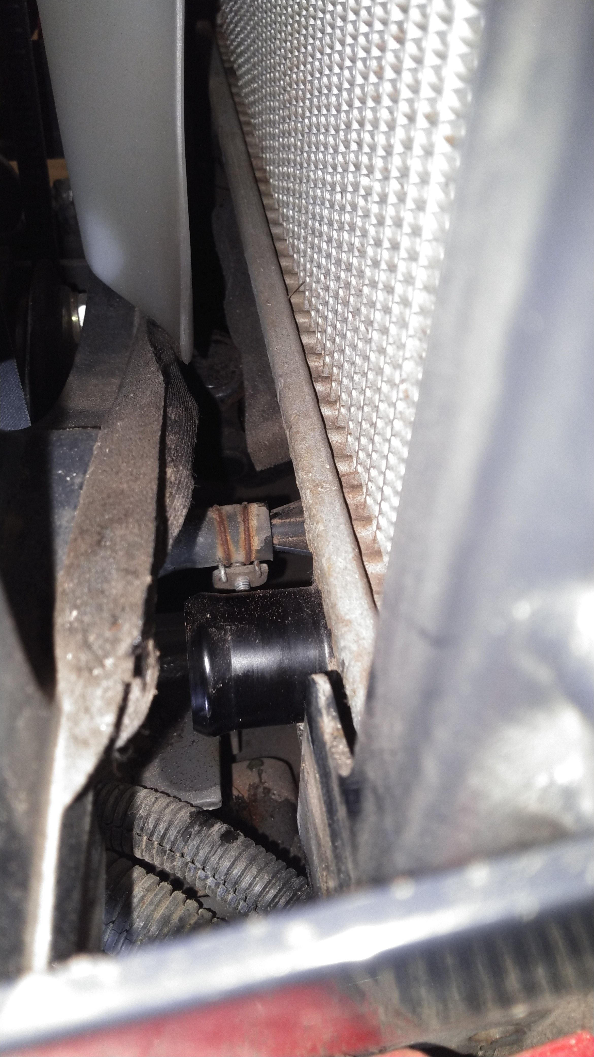

Here's a pic with radiator removed, fan shroud is still in place around fan but not attached, showing u joint with slip coupling coming off crank pulley:
Here is lower radiator area showing hose barb and the drain hose. Looks like it could be damaged easily.
