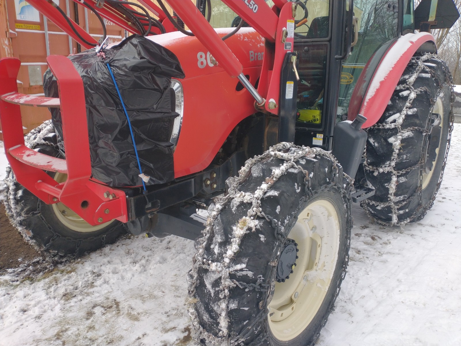

Here is a link to one thread about mounting tire chains;
Mounting tire chains
I have used about all the different styles of tractor chains around, in doing so I have come to some
fairly firm convictions on tire chains.
As far as I'm concerned the Euro studded style are the only way to go, they provide just about the most traction, while also giving the best ride quality even on roads.
I have two tractors with these at this time and have two more to suit up for this winter.
This is the style I will be putting on my little CK2620SE and the NH 8160.

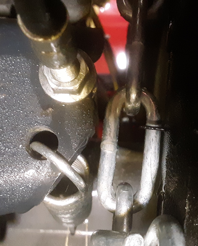

FWIW, I built a set of chains for my old 1710 (2wd, R1 AG tires loaded). I modified a 7' truck blade to attach in place of the bucket. It would plow our road just fine so long as there was no ice under the snow. If you EVER get any ice, you'll regret not having chains. I lucked into some cheap grade 70 chain from MSC that they had discontinued, but it would have been easier to have bought the cheapest truck chains I could find and modify them to fit my tractor. Then again, I have grinders and welders so it was all a "project" for me :) I bought a cheap set of 4 rachet straps and use them to tension the chains. Once I installed them, I just cut the extra strap off and burned the ends.
