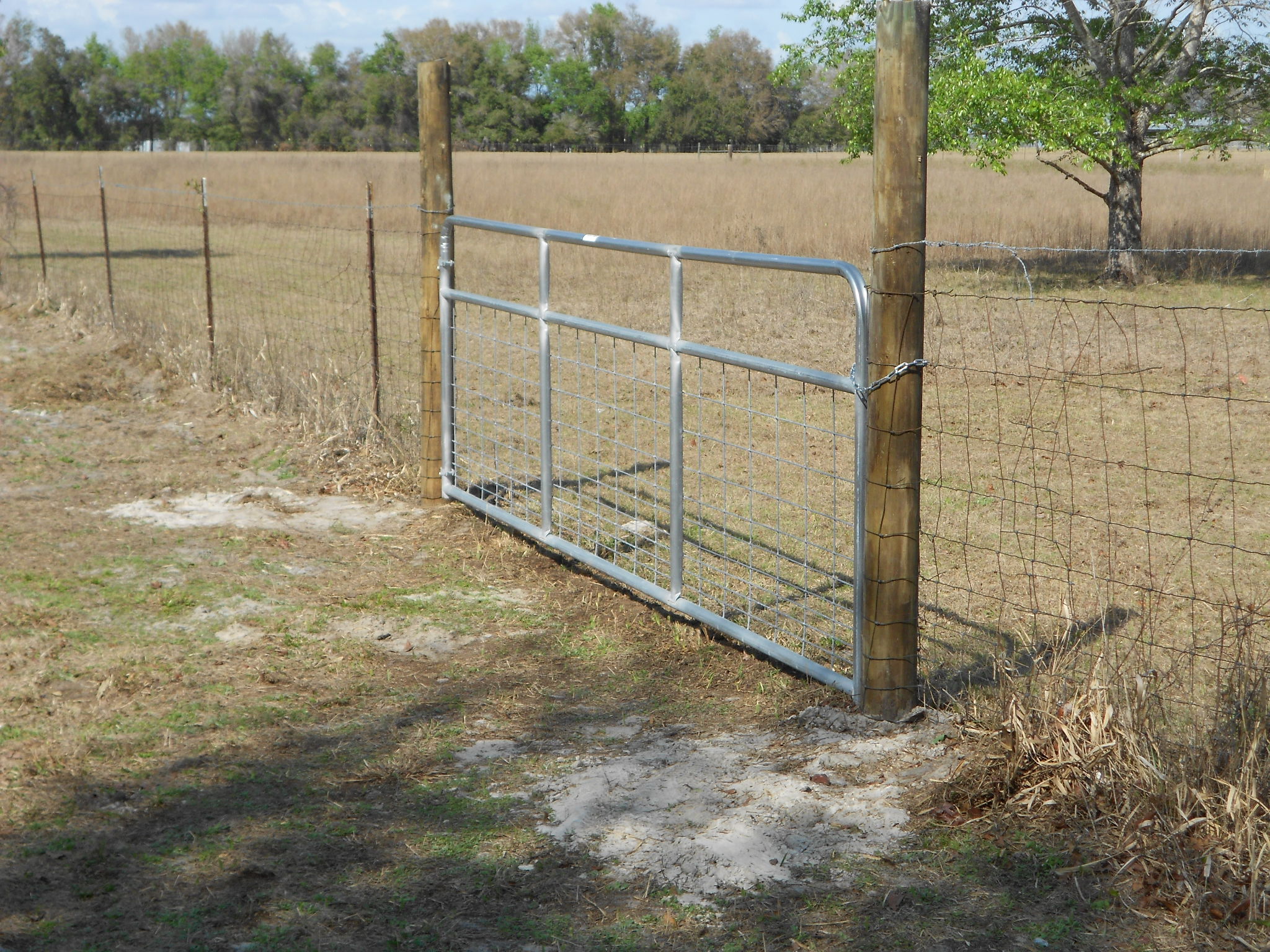

Here is a 14' gate from TSC that I put in my pasture for access.
IIRC these gates are just under size so with hardware they are the stated size.
You can also adjust the size by putting the hinges off center on the post.

Stimw thanks, I am going tonight to get one, I went yesterday to a tsc but they only had painted ones and it looked rusty in a few spots, and they were out of the galvanized. I want a galvanized one to match the other farm gates we have. I didnt realize they were undersized that will make 12' a perfect fit then. Thanks!!
